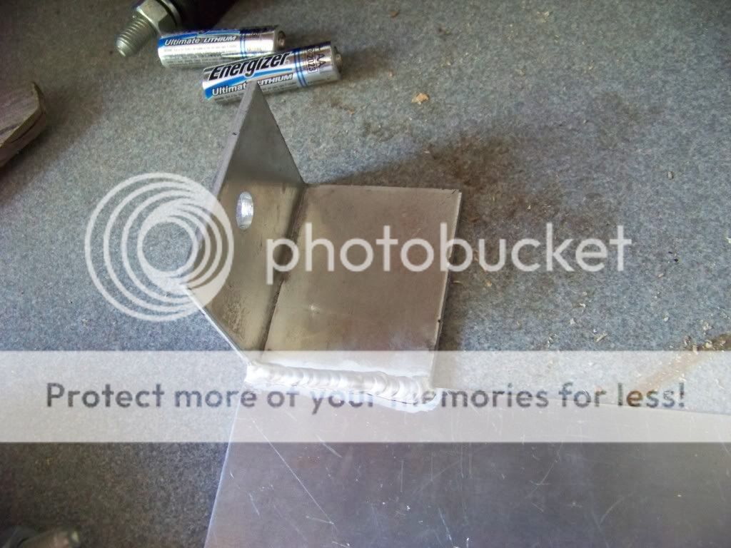

I started with 2 blank plates of Aluminum, i laid out and drilled 6 holes in each and on one i welded on some mounting Brackets with a single hole i had drilled into them previously.
