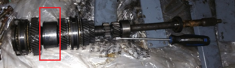

Finally got started taking it apart, and I think I found the problem: Since everything else is tight with little-to-no play, and this one has lots of play, is it safe to say this is the cause?
Video: https://goo.gl/photos/SfhaRqFU3VHNLTy37
This one doesn't look easy to replace... seems to require a press and other tools that I don't have. Is that right?
Also, what's the best way to clean the inside of the transmission? Compressed air?
