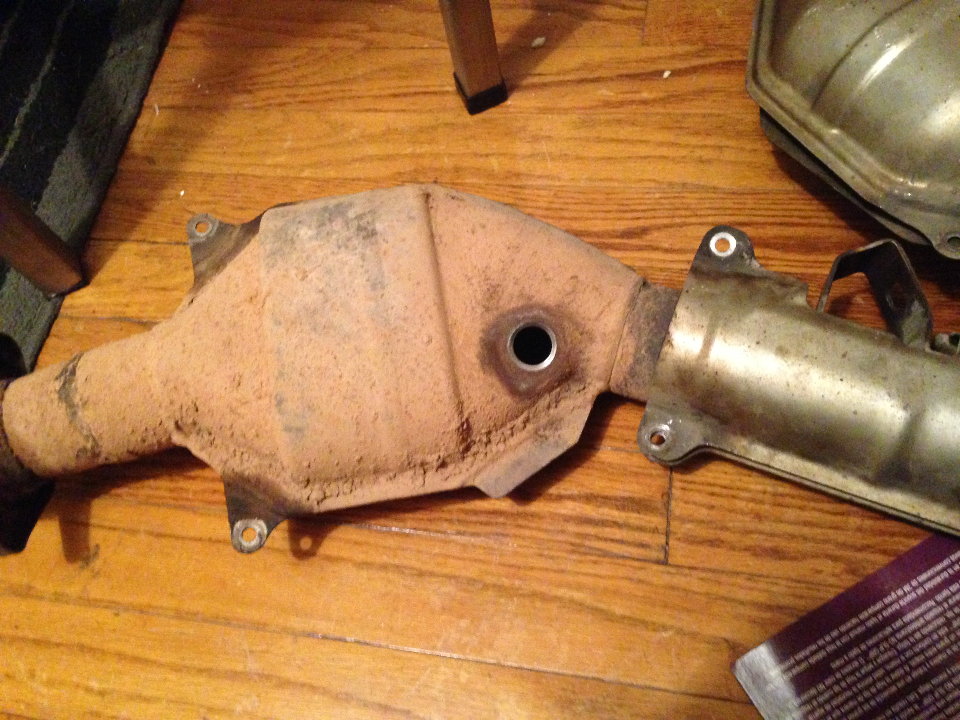

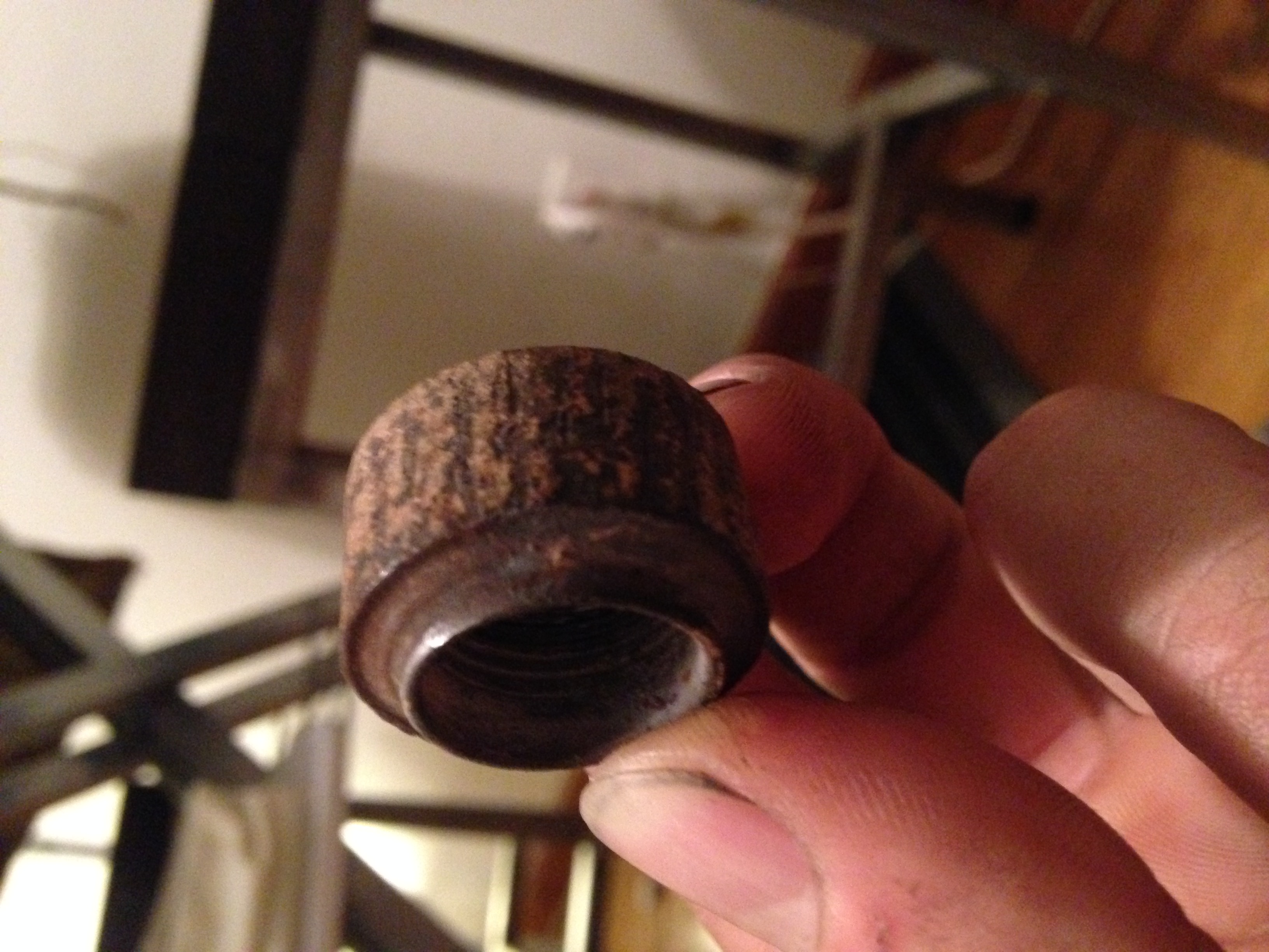

I was changing the downstream 02 sensor on my 2005 Baja and it was really stuck in there. In the process of removal, I actually removed the entire threaded fixture that was connected to the converter. (I'll include photos below).

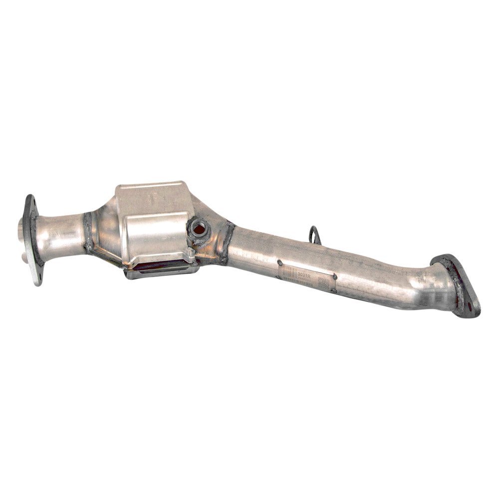

B) Get this part right here. I was told by the folks at CARID that it's the correct fit and everything.

Image 1 is the threaded bung that the 02 sensor screws into. It broke clean off the cat. Image 2 is the cat. That hole is where the threaded bung used to sit. The final one is the part option I could get from CarID. It costs roughly 200 bucks but if I can pay a little more and get a nice upgrade for my exhaust, why not, right?

You say you're new to Subarus, have you ever messed with modifying a turbo car before? going catless is kind of bolt on but also kind of not because it'll throw codes you're going to be stuck with unless you do some programming or mechanical fiddling to bypass it. I'd suggest doing a bit more research and planning it out.
If it were mine, I'd clean up the bung and cat with a wire wheel and weld it back up. How much I'd trust a shop or someone else to weld it up... I've seen shops do great work and some that refuse to touch used exhaust.

That looks awesome man! How much was it if you don't mind me asking? Is it a pretty noticeable difference? I'd be worried about throwing the code but if you're not having issues, I may consider it in the future! For now, like Kam suggested, I ended up just cleaning out the bung and having it welded back on. Problem solved(for now)!bobjr94 wrote: Mon Oct 23, 2017 2:04 am I put this on my 05 turbo a few days ago (the amazon review & pics is also mine)
