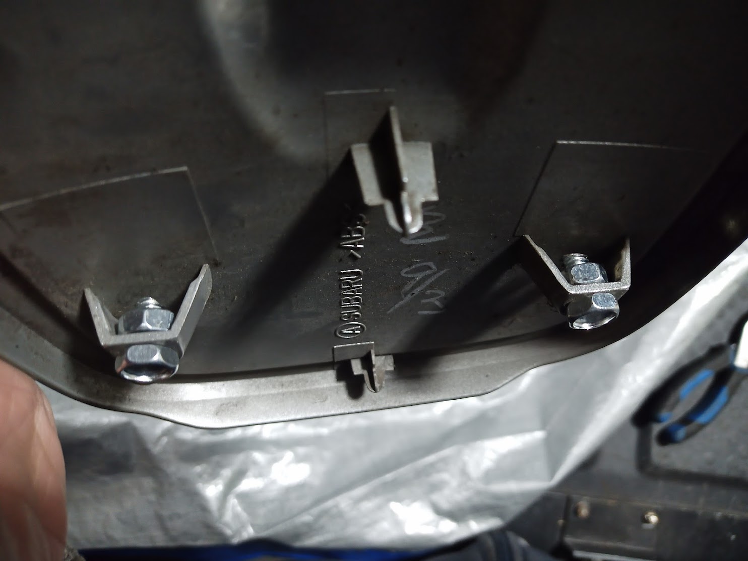

Re: Fuel door falling off fix
20Baja06 wrote: Wed Dec 20, 2023 5:26 pm I’d probably use some slip-on nuts and simply run a bolt through like the original clips.
I ended up doing something similar, just with regular nuts and bolts; I didn't want to cut the plastic door cover in any way.
1. Find nuts and bolts that fit, and trim the bolts to length. If you find a nut the right size, it'll fit snug inside the plastic "stand-offs" and not rotate freely.
2. Add a bit of glue or something to hold the nut in place, so it doesn't fall out while trying to install it.
3. Screw the bolts in from the outside as normal.

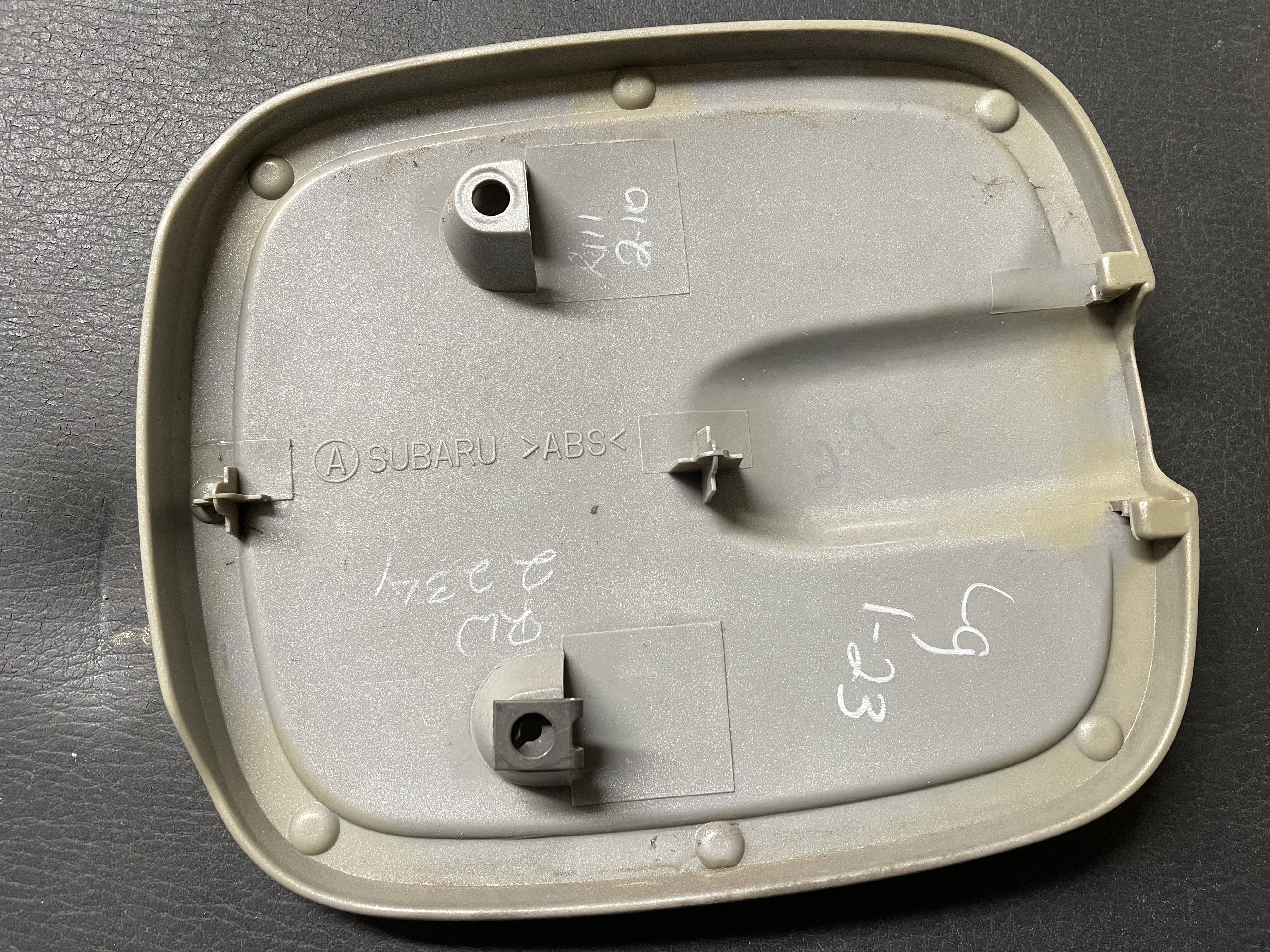

The flaw with my plan to use the slip-on nuts was failure to consider that the “stand-offs” taper towards the mounting hole, meaning the plastic is narrower at the top than the bottom. The slip-on nuts I had on-hand were too long and would have required trimming along the corners that would be on the cover side of the stand-off.
I still like the idea but I didn’t have a great way of trimming spring steel so I replaced the original plastic push-in clips with some new ones I had in the drawer.
