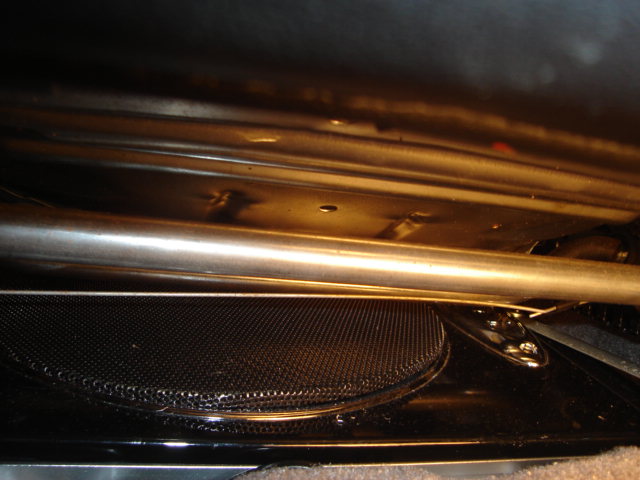

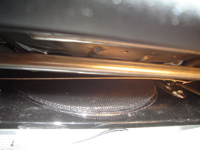

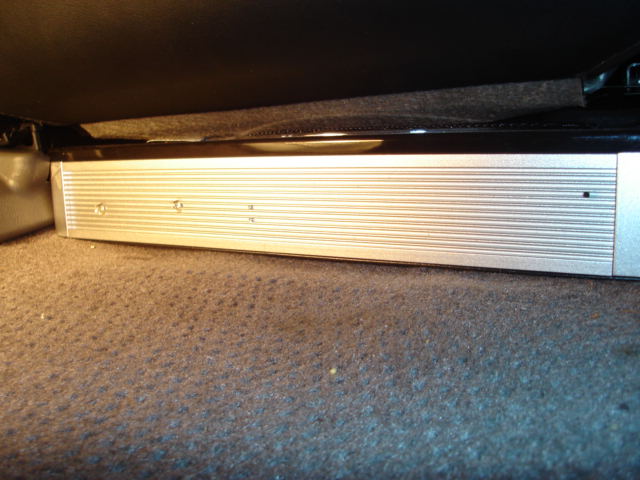

Well, NewToSubies, I've made some lower resolution photos and will try to upload them. I'm not sure whether these will do you any good or not. If you put the sub under the seat, the seat WILL NOT go all the way back. The stamped metal form of seat bottom contacts the top of the sub cabinet and wants to push it back. It will go back only about 3-4 notches and then starts to take the sub back with it. I fastened pieces of "pipe hangar" to the top front of the box and secured it to the front seat bolts. You can see one of the brackets just to the right of the speaker logo on the front view of these pics. With this temporary solution, I can put the seat back to within 2-3 notches of all the way. Anyway, hope these help.
- Boss 1200 Under Seat Rear 1.jpg (58.38 KiB) Viewed 14057 times
- Boss 1200 Under Seat Front 3.jpg (58.05 KiB) Viewed 14057 times
- Boss 1200 Under Seat Front 2.jpg (57.21 KiB) Viewed 14057 times
