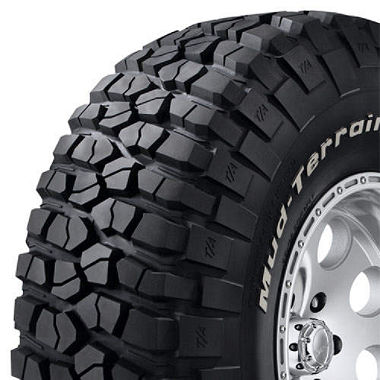

I am running Mud TA KM2 235/70-16
To answer SB587's question; your going to need 4 inches of lift and some fender trimming to handle those tires, they are much closer to 29's than 28's. They are a fraction of an inch from what I am running and you would need the same mods. 4 inch lift, fender trim, 20mm spacers, and an extra half inch or inch in better springs isn't a bad addition. And before the wheel spacer bandwagon gets going, 20mm is a modest change that does wonders not just for clearance but for handling. After the lift the extra 40mm in track width was a dramatic improvement. Ferrari has used 25mm in OEM applications http://www.ferrarilife.com/forums/drive ... tires.html What people often think of is the idiotic 75mm spacers with the wheel half out of the fender.
http://www.tacomaworld.com/forum/tireca ... -235-75r15
