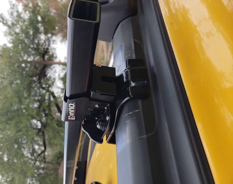

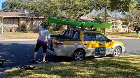

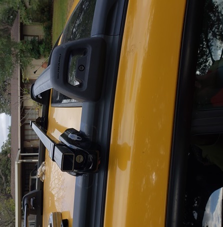

Replaced the OEM crossbars with INNO IN-TR base stays and crossbars. The INNO system was the only one that I could confirm would work with the Baja rails with no modifications. The INNOs don't get the best reviews, but they have worked just fine for my purposes.
I needed to move the OEM bars to fit my rowing shell carrier. I did finally get the crossbars loose, but at the cost of destroying the corroded retaining screws. Because the crossbars weren't a great fit for either the carrier, or the kayak saddles I wanted, I replaced them rather than try to repair them.
Some side by side images before I removed the OEMs.
bumblebee
Joined: Sun Oct 03, 2021 8:54 am
Post by bumblebee »
A couple more images on the crossbar replacement

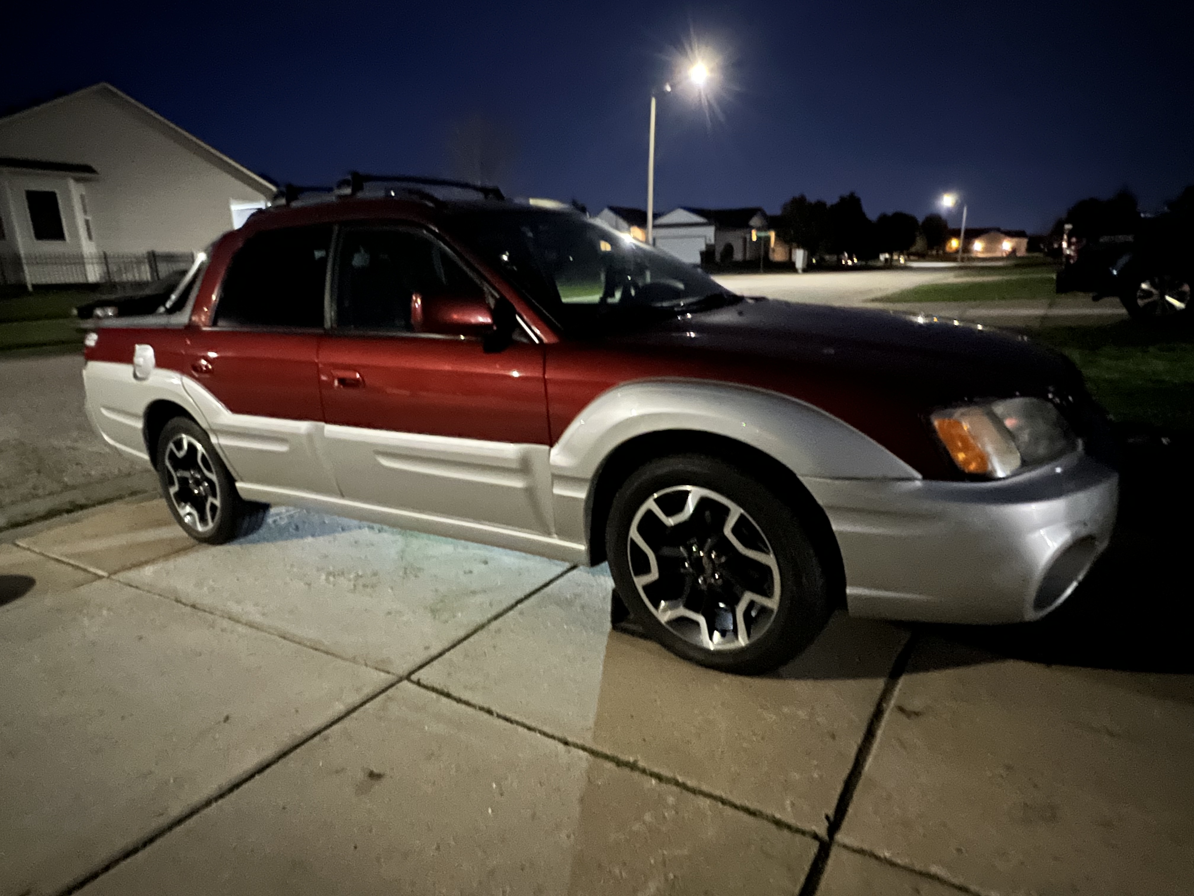

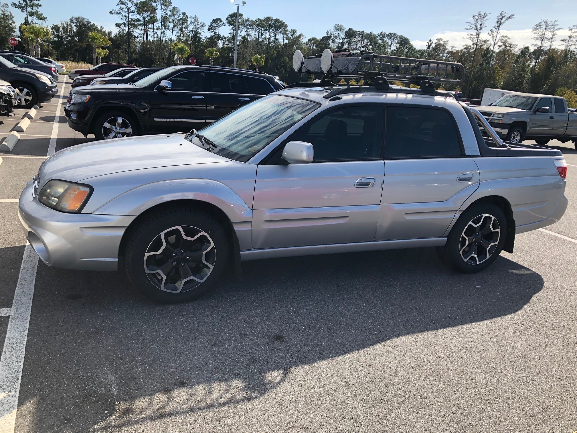

added crosstrek wheels :)
Yokohama Avid Ascend LX 225/55R17 no rubbing

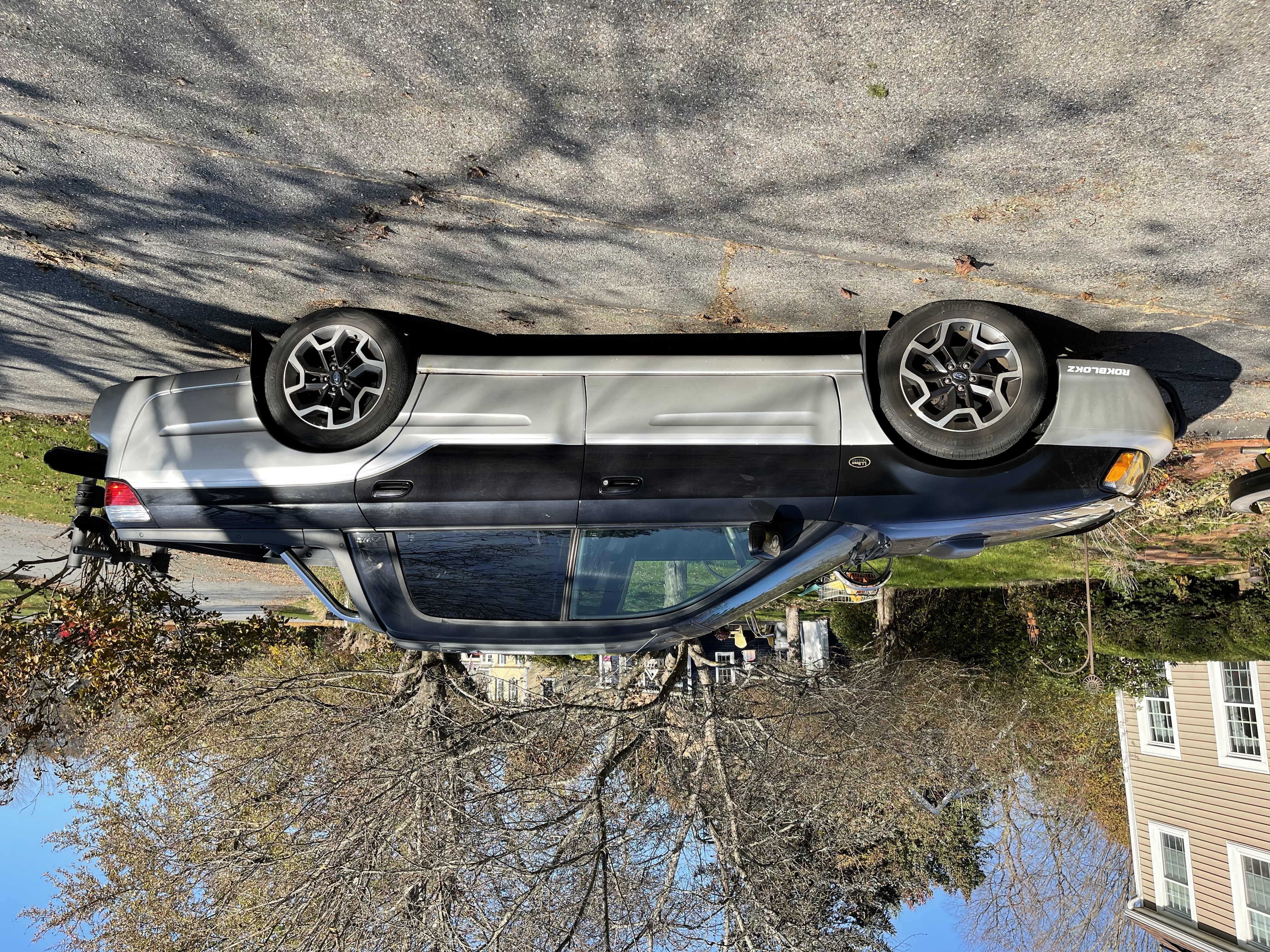

I know you’ve seen it a million times but the 250.00 Baja got some new shoes last night. They should have just come stock with crosstrek wheels lol

Crosstrek wheels look good on anything but Crosstreks

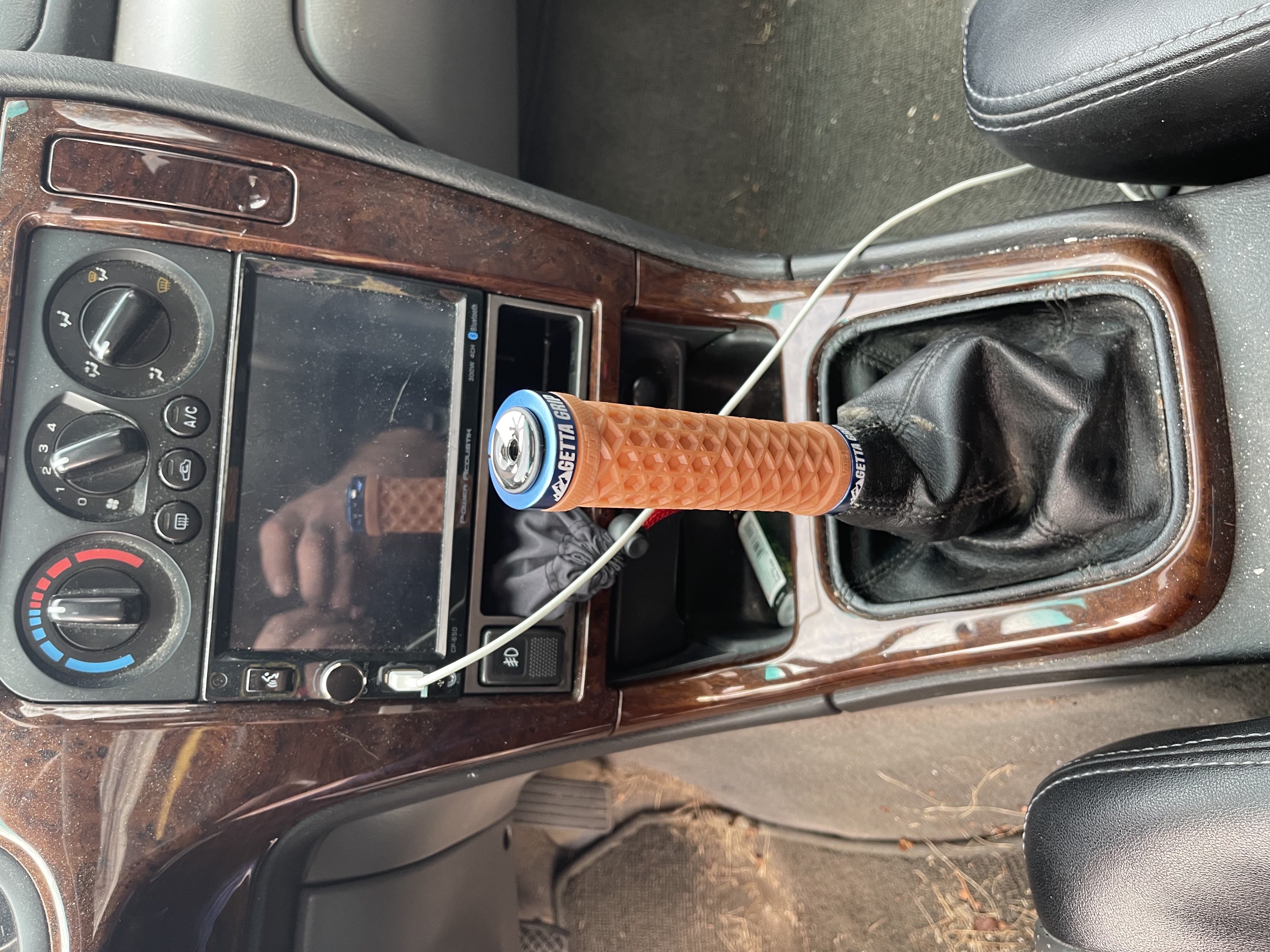

I got a new Getta Grip Vans shifter

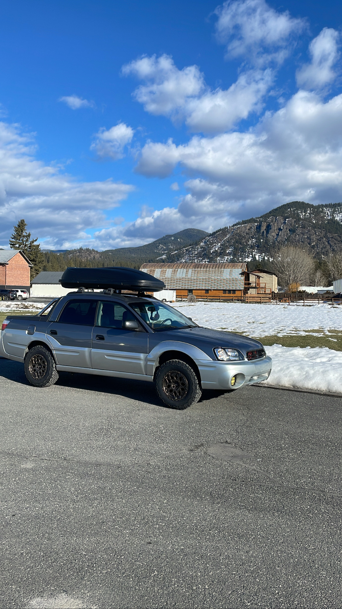

Got my stance set up. Still need an alignment. ADF 2in lift and multilink, f44 wheels, ko2s. Added a Tommy Kaira legacy grill.

Would I be able to put these on without running into issues? I know turn radius would take a hit till I’m able to get the lift. Just curious.

I’m running 215/75/15 ko2’s with a 2in lift and I had to cut my liners up in my front fenders, cut the side skirts back and hammer down the pinch welds. It rubbed pretty bad prior to that. I think these would be much too big. ADF recommends 215/75/15 & 215/70/16 as maximum tire size after lift with minimal cutting

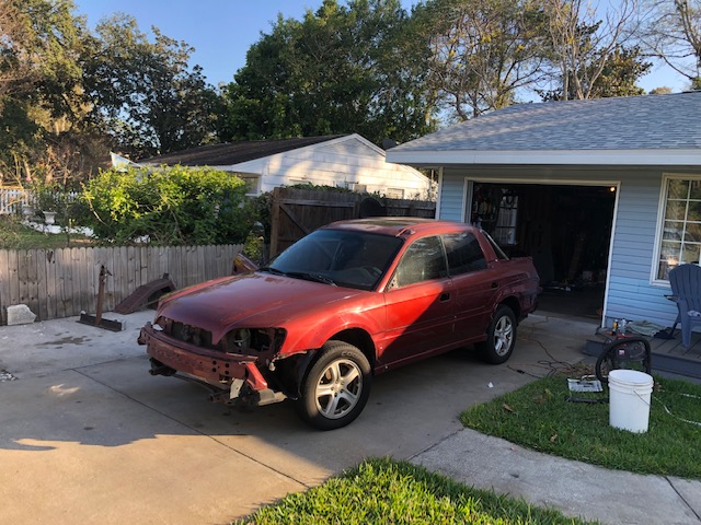

Well, what did I do to my Baja Friday, Saturday, Sunday. Getting ready for painting. There was a lot of the trim I had to "learn" how to remove (there are tutorials, and various websites but NONE has all the different trims. I also found a few rust areas. One on the roof I trimmed out and welded in filler pieces (it goes under the rail), other small ones are under the cladding and will be addressed later. Got a quote today, but he is about two weeks out. Worth waiting for. Dennis
