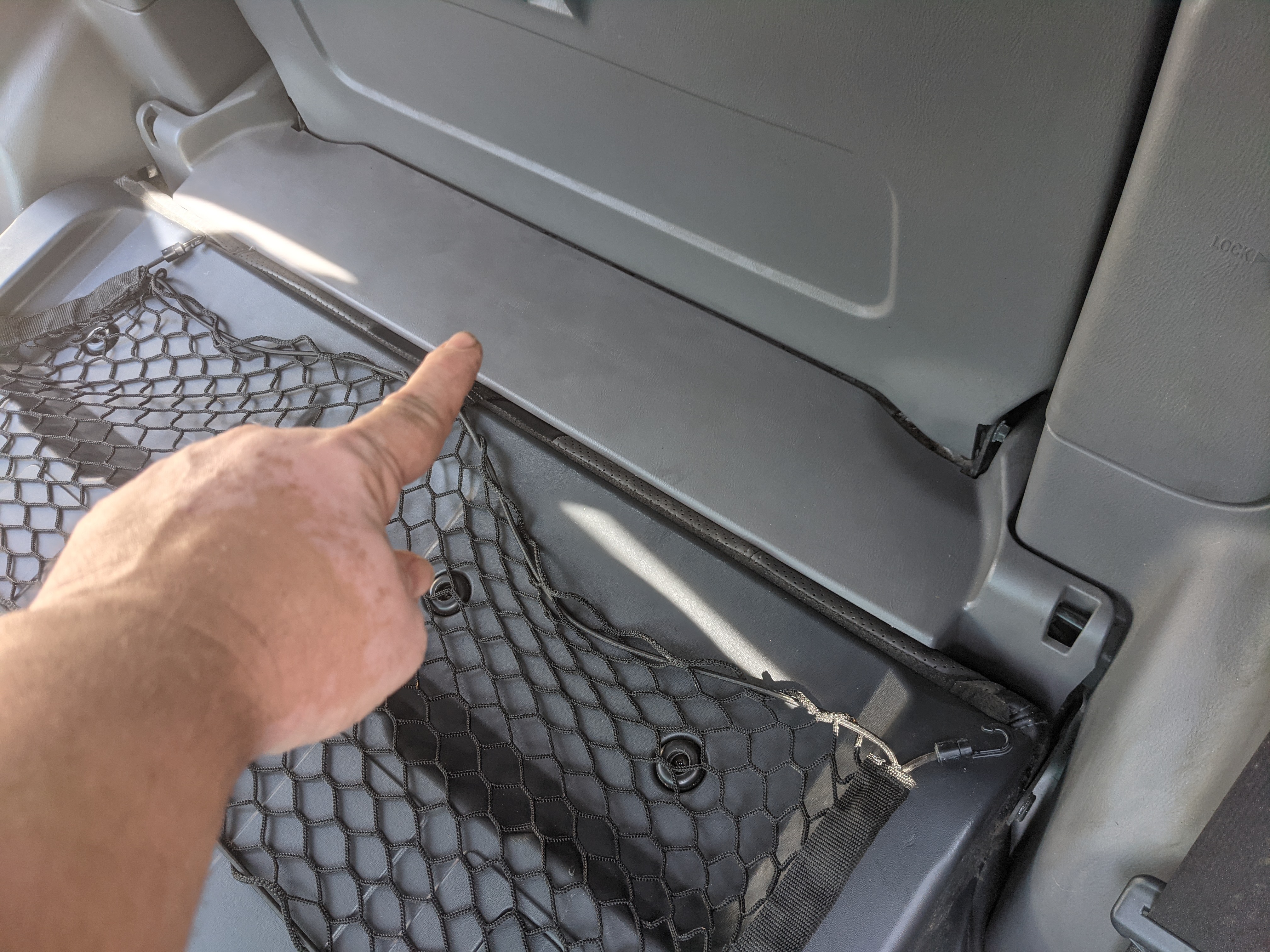

Anyone have pics with the rear seats removed? I'm trying to see how everything goes together underneath. TIA

Re: Tutorial - Dismantling The Interior
What can't you see with the seat folded? The base is only held in by 2 bolts. The back folds down and (IIRC) there are like 2 bolts on each side. Behind it are the plastic panels, which snap in like most other plastic on Asian vehicles. Dennis

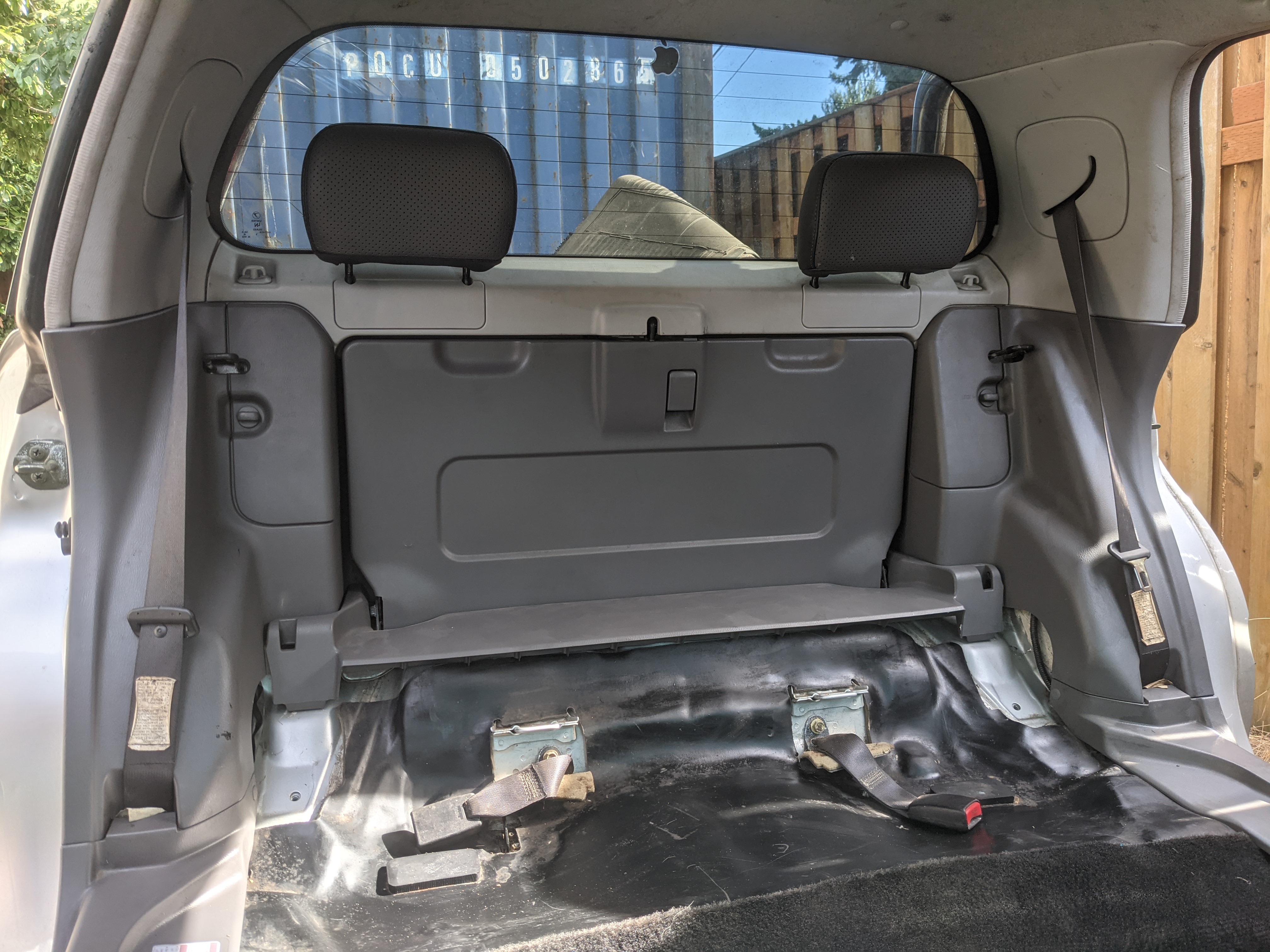

My seats are not installed, and all the trim pieces from the rear are in a pile, a pile that also includes other subarus. A picture of the rear area with no seats installed would help me immensely.
I have half of the rear plastic removed from mine from when I was changing the shocks. I'll try to get a few pics, but it might be tomorrow.

ZUBAJA wrote: Sun Sep 05, 2021 1:11 pm I have half of the rear plastic removed from mine from when I was changing the shocks. I'll try to get a few pics, but it might be tomorrow.
Thanks, but I got some time off today. Don't worry about the pictures, I'll be hopefully finishing it up in a couple hours. I'll post any random trim pieces I can't find a home for.

Here's the rear trim all installed to the best of my ability.
I learned that you have to install the upper rear cushion before this piece of trim goes in. Otherwise you can't tighten the upper bolts of the seat.
