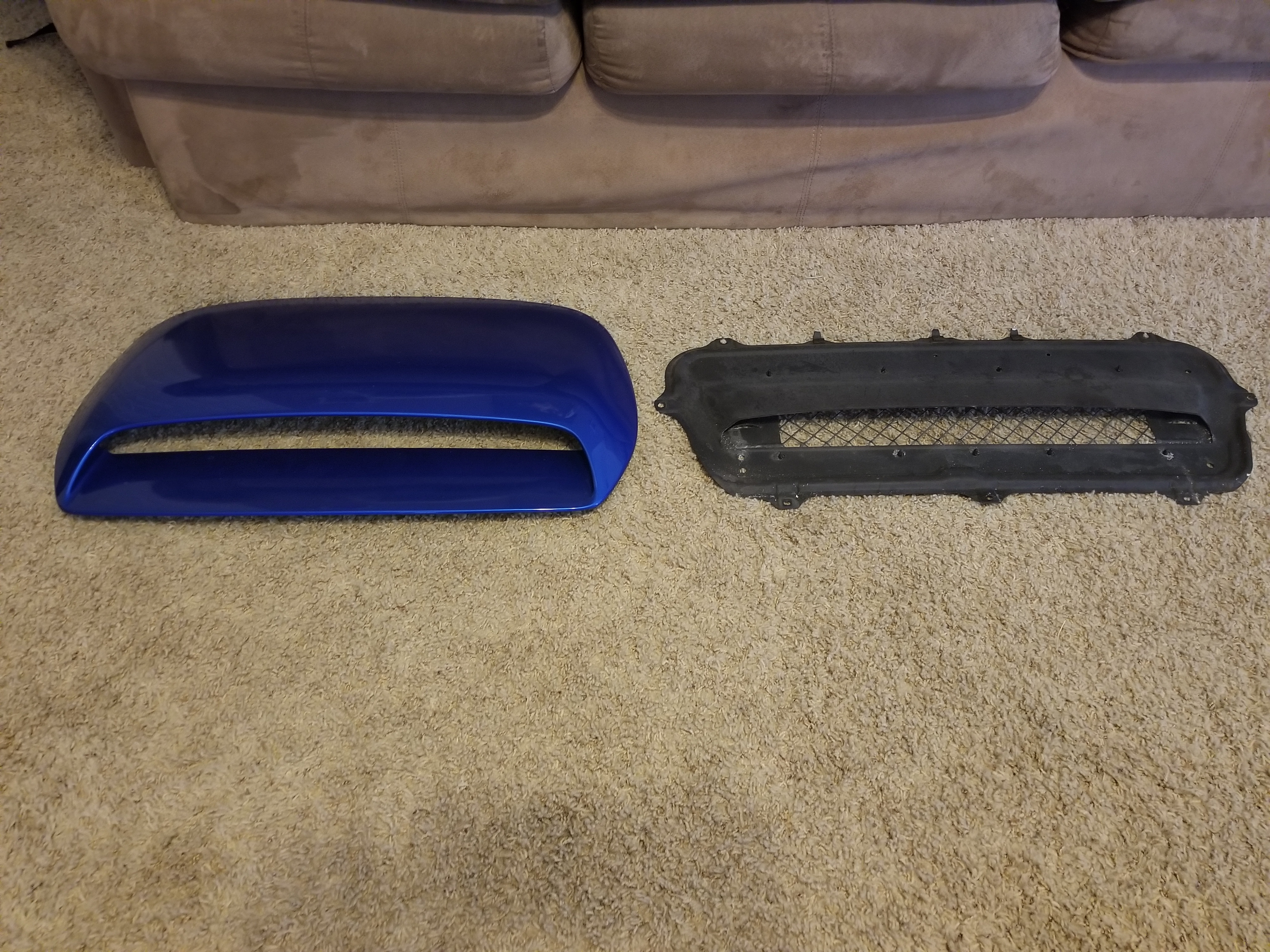

This just showed up in the mail today...
S401 scoop
S401 scoop
Yes that is a genuine Legacy S401 hood scoop and air guude

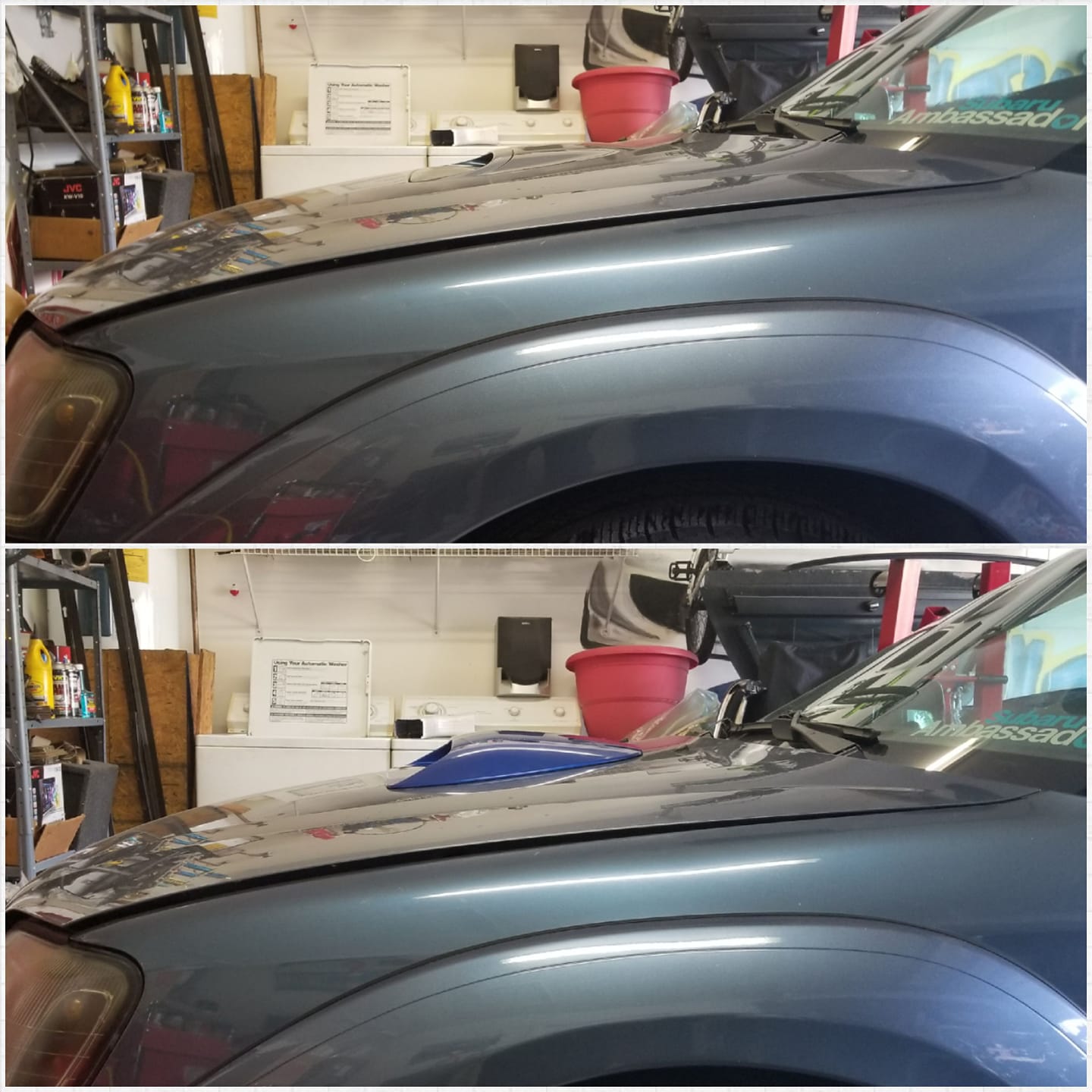

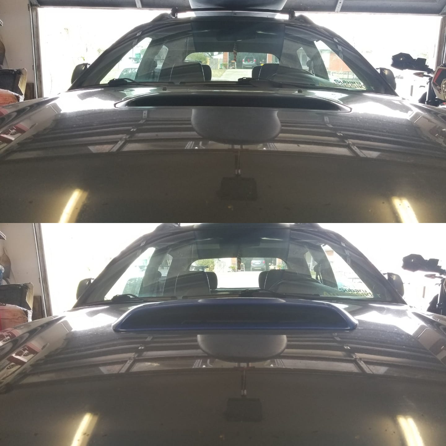

Well, even though I'm in the process of pulling the intake manifold to find and fix an oil leak I took the time to at least test fix the scoop and get some comparison shots before it gets painted to match. So totally stoked about this scoop and how it changes the looks of the Baja.
S401 scoop side compare
Side before and after.jpg (198.47 KiB) Viewed 15258 times
S401 scoop head on compare
head on before and after.jpg (144.69 KiB) Viewed 15259 times

Post by starr- »
Welcome back!
Glad your hunt paid off! Looks wayyyy better than the stock "scoop".

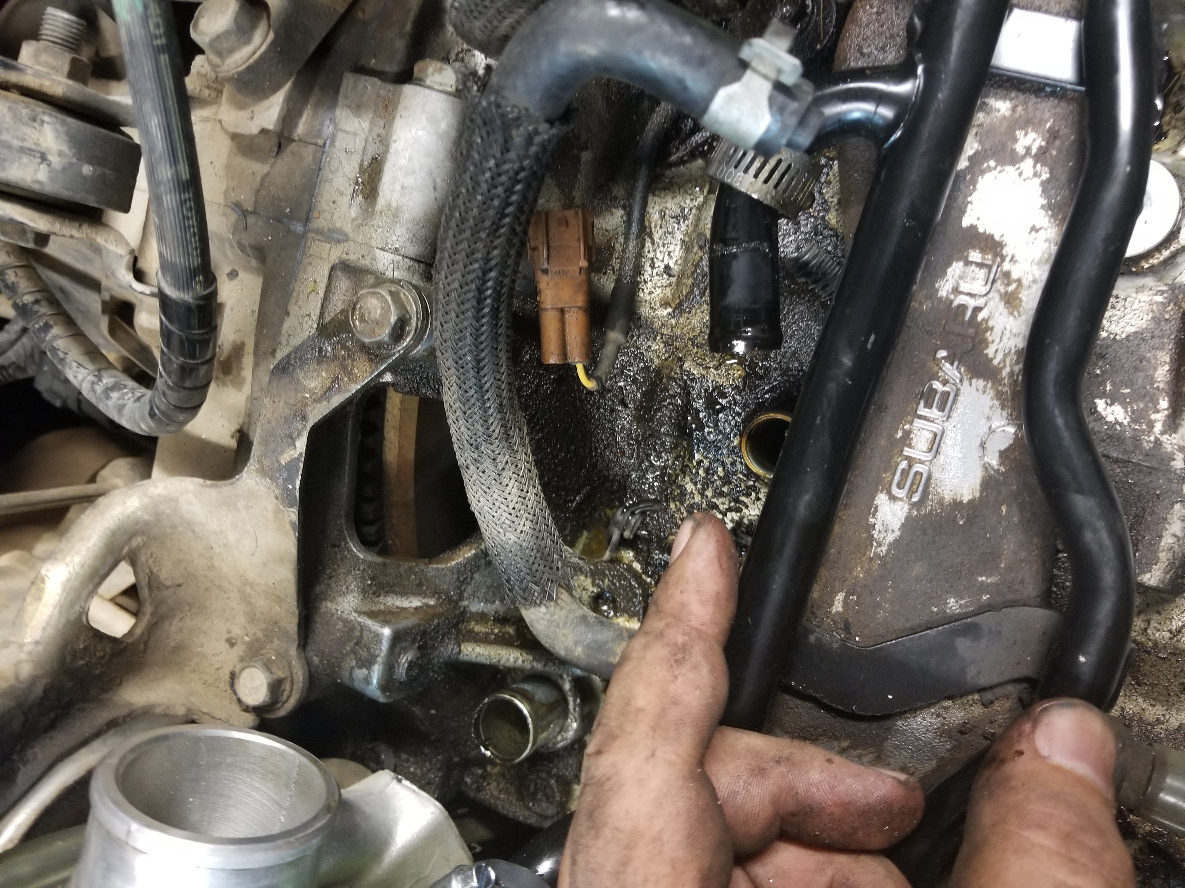

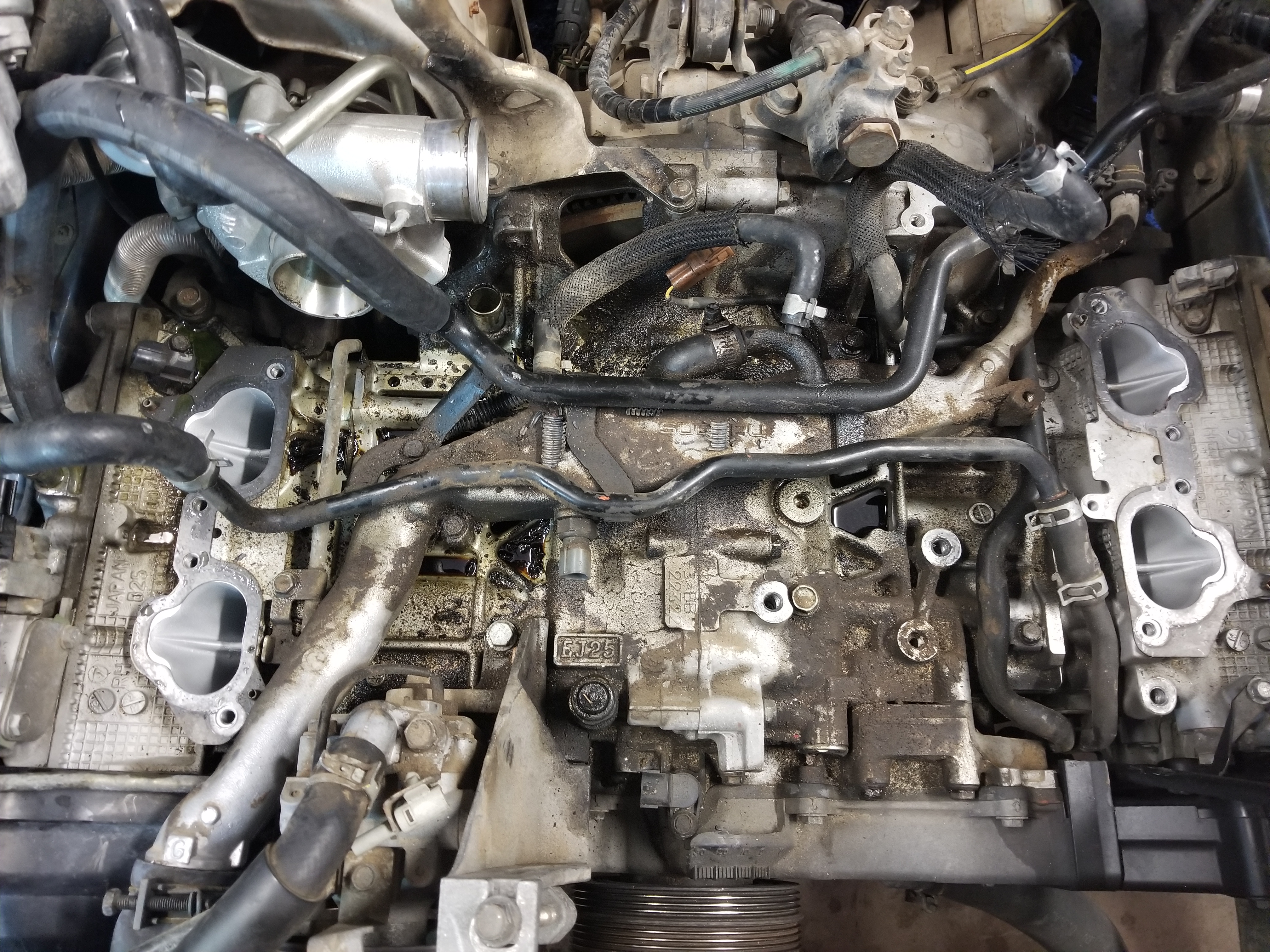

However, this is my current situation...
Manifold off
Manifold off

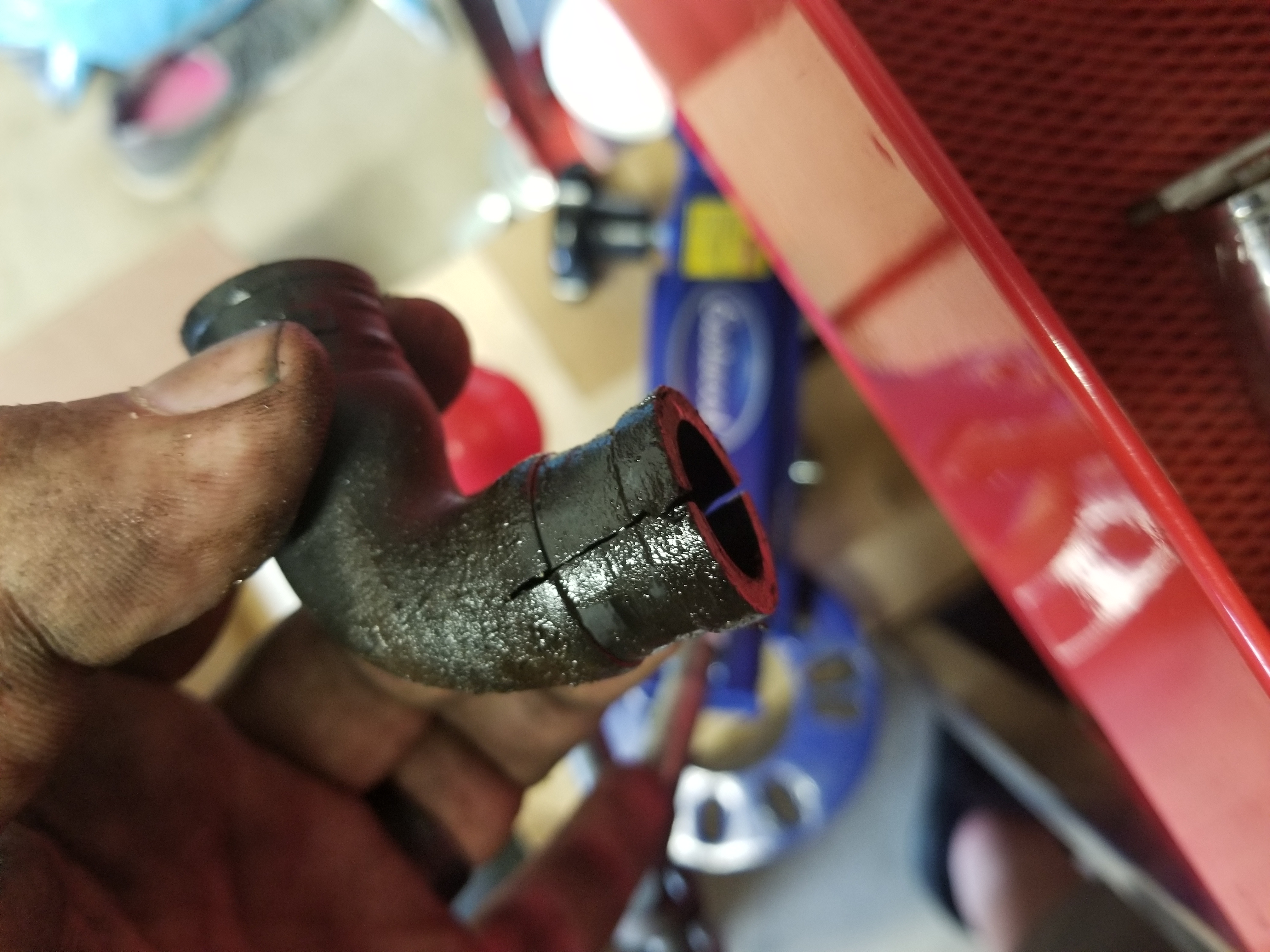

And this looks to be the source of the problem.
Center crank vent hose
From here.
Location
Location
My 2006 Baja turbo thread - viewtopic.php?f=2&t=3176

I was under the hood today trying to find where I might have a leak from. I think I am in the same situation as you. Any idea what that elbow is for?
