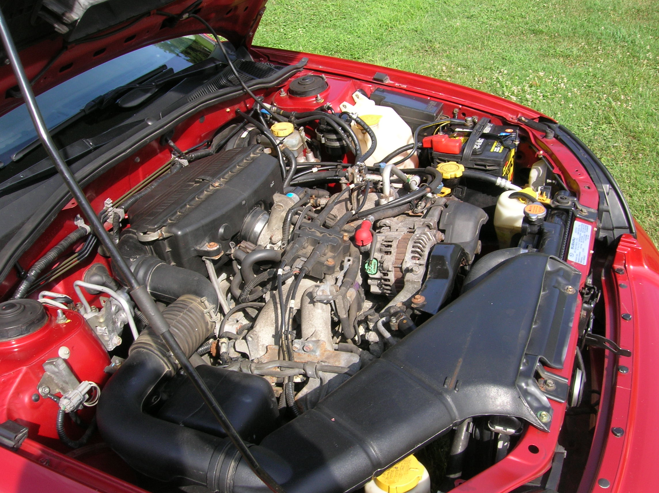

Hideyho Guys, Got a week end update for you. Eng./trans./suspension./driveshaft all in and working out as planned. I used the 02 Outback front crossmember, steering rack, p/s lines, sway bar and ends, and tie rod ends. I used the 05 Baja struts, springs, knuckles, hub and bearing assys, calipers, and rotors. I thought there was a slight difference in the length of the struts between the Outback and Baja, but I'm not real sure. It may be where I was taking my measurements. I'l have to get back with you on that. So far everything bolts up, lines up, and I haven't run into any clearance problems or major issues. Using the radiator, hoses and a/c compressor and hoses from the outback. Again, everything ok. Today I started on the wiring. (The Baja) The dash is out and on the garage floor. Getting ready to pull the a/c evap. box so I can feed the right side wiring harness through the firewall. Once I have that done i think I'll push the Outback back into the garage and tear it down to the same point. Then I can concentrate on one side at a time. Actually going a little quicker than expected. Might even have her running in a couple weeks or less. Still a little confused over rear end gear ratio. Build sheets on scoobynet VIN decoder showed 3.90 gears. Several places on internet showed blocking one wheel, turn other wheel 10 revolutions and count revolutions of driveshaft. Driveshaft turned 22 and 1/4 revolutions on BOTH cars. Which, according to the internet, would be a 4.44 rear end gear ratio. Regardless, both cars were the same so front gear ratio has to be the same as well. Anyway that's all for now. Will have another update the first of the week sometime. Ya'll take care, Tom

Hideyho guys, Have taken a few days off but hard at it again. Here's a little refresher and update:
1. Eng./Trans./Driveshaft/Axles/Suspension all in, hooked up, and ready to rock and roll.
2. Under the hood and under the dash wiring harness removed from the Outback and installed in the Baja. I used the computers, modules, relays, etc from the Outback in the Baja. Also the steering column from the Outback. The dash is back in and everything works, I think.
3. Have not driven the car yet, but I have had the motor running and the trans. shifted into gear OK. Hopefully will shift OK out on the road.
4. Working on the rear harness now. Obviously lots of differences here. I don't have wiring diagrams so I'm taking my time tracing wires, checking and comparing components from both cars, and building a new harness from the wiring from both cars. Everything up to this point has been pretty much what I expected. But the rear wiring has been a big "pain in the you know what". Been working on it for about 4 days and I'm sure I'll have at least that much more to figure everything out and get it all right.
5. When it's all done I will make a list of what I used from the Outback, and what I used off of the Baja. Also, if I can figure out how, I will post some pictures. That's it for now. Ya'll have a good weekend. Tom

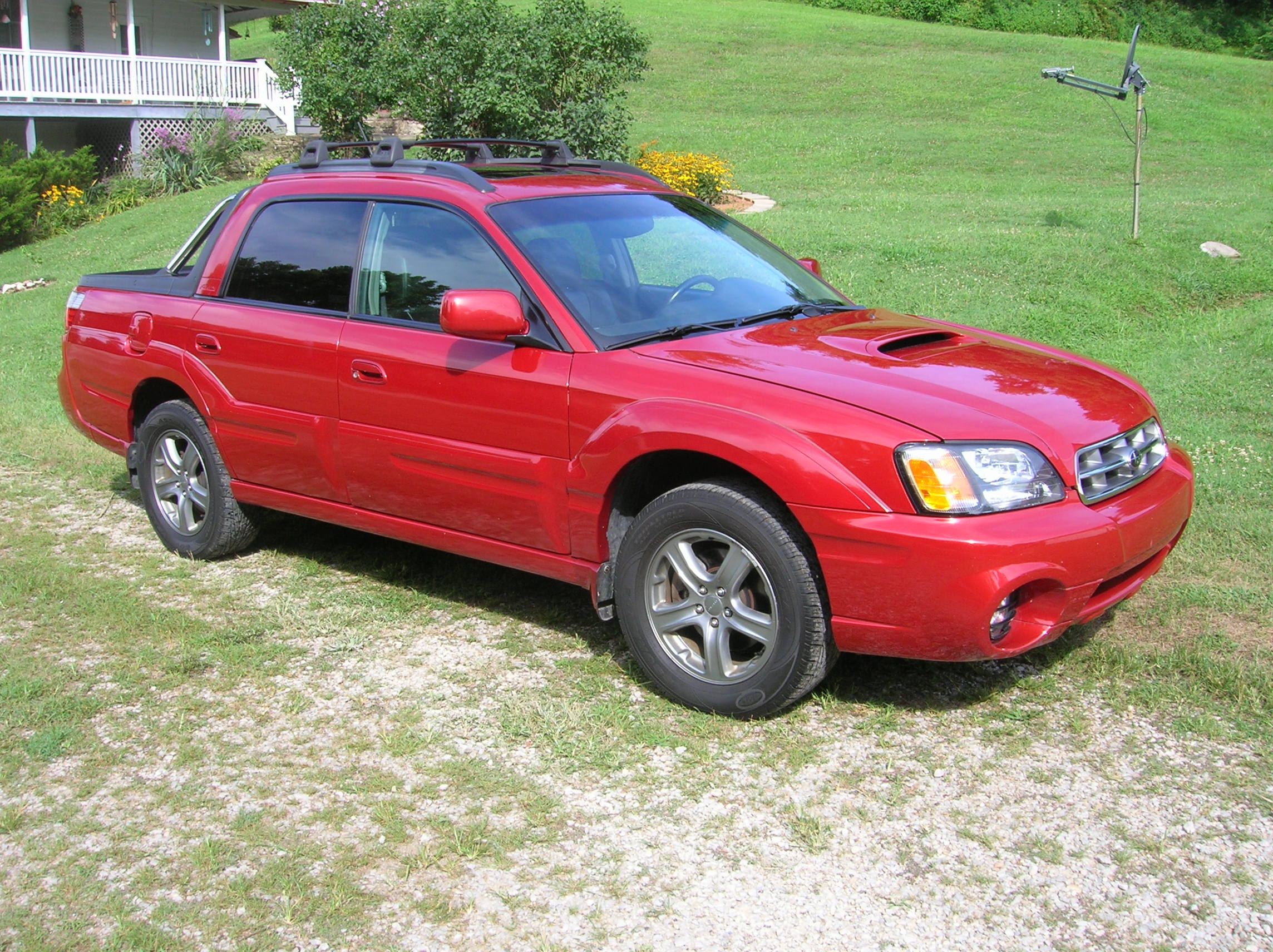

Hideyho Baja guys, Time for a post-project report. The Baja is done (except for changing the fluid in the trans and diffs) and so far everything has worked out well. I have put nearly 500 miles on the car and haven't had any problems. The car starts and runs great, no check engine light, no abs light, no air bag light and everything works as it should. Couple things I wanted to add: (parts used) The shifter and the exhaust system were 02 Outback. I did, however, put the original muffler back on. It just looked better.................................My advise to anyone that is thinking of going this route: #1-Make sure you have a good running and driving donor car. #2-Don't get in a hurry, take your time. #3-I can't guarantee every Outback-Baja combination will be as compatible as the 2 cars I used. I can only tell you my situation worked out very well. #4-When you get to the rear wiring (because of the obvious differences in the cars) you NEED TO HAVE access to factory wiring diagrams. And, make notes on pin locations before you cut the rear harness to marry the two. There are a few instances where the same color coding is used for different things. I used the 02 Outback wiring harness, complete and uncut (UNCUT, take your time) under the hood and under the dash. The only wires I cut were the rear wiring harness at the right rear wheel. In a nutshell, I couldn't be happier with the results. We loved our Outback, now we got an Outback with a neat little bed to haul mulch, antiques, car and motorcycle parts, etc. and we ended up with only about $3400 in it. Thanks again to everyone the helped with advise. If anyone has any questions feel free to ask. I will continue to check this thread once in a while. Tom
- Baja 007.JPG (713.05 KiB) Viewed 18991 times
Re: 05 Baja turbo shortblock
Well done Tom, and that is one good looking Baja. Dennis
