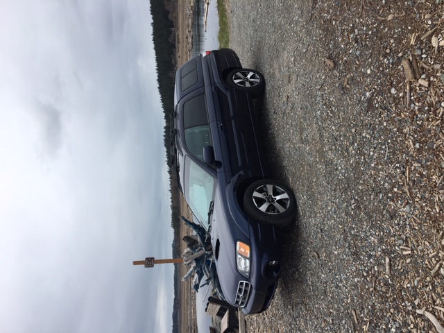

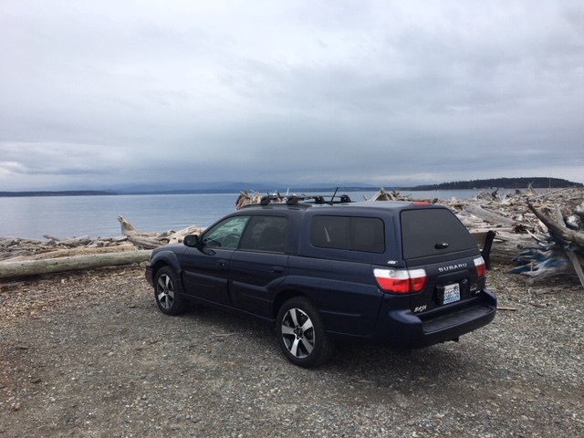

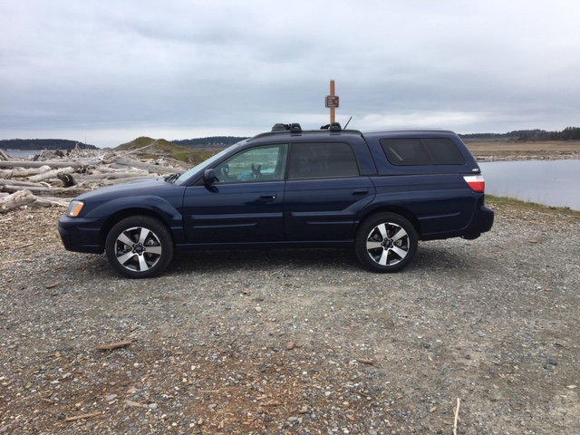

I finally own my first Baja.
2005 Turbo 5MT.
With ARE canopy.
Bought it, shipped it here, sent it to Smart Subaru Service for 150K major service, all new brakes and calipers, and a lot more.
Every fluid changed from bow to stern. What a difference.
Put wheels and new GMax tires on her.
She's a beast. Fun to drive. Drives more like a sports car than a truckling.
