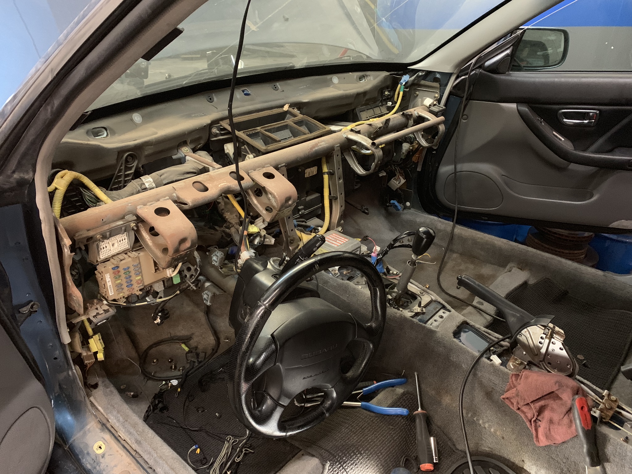

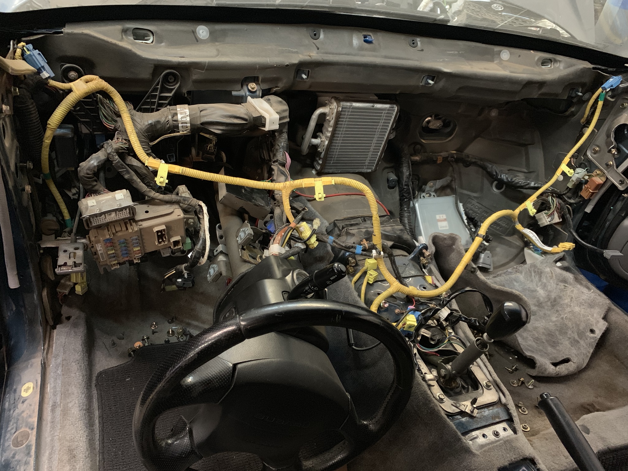

Yeah, pulling the dash was rough. I found my whole support assembly covered in fine rust. (Attache is the graphic visual for folks that haven’t torn into their car yet. The bottom photo was at the point I discovered I had to take the dang heater core back off the firewall again.)
Oh! And don’t lose the fat plastic disc/cap that came off the carpet under the accelerator pedal. If that’s missing and you floor the pedal, you will trip an engine code for position sensor high. -limp mode...boo. I’ve done it a couple times when the boost was all there and ready for smiles... Yeah, don’t lose that cap.
