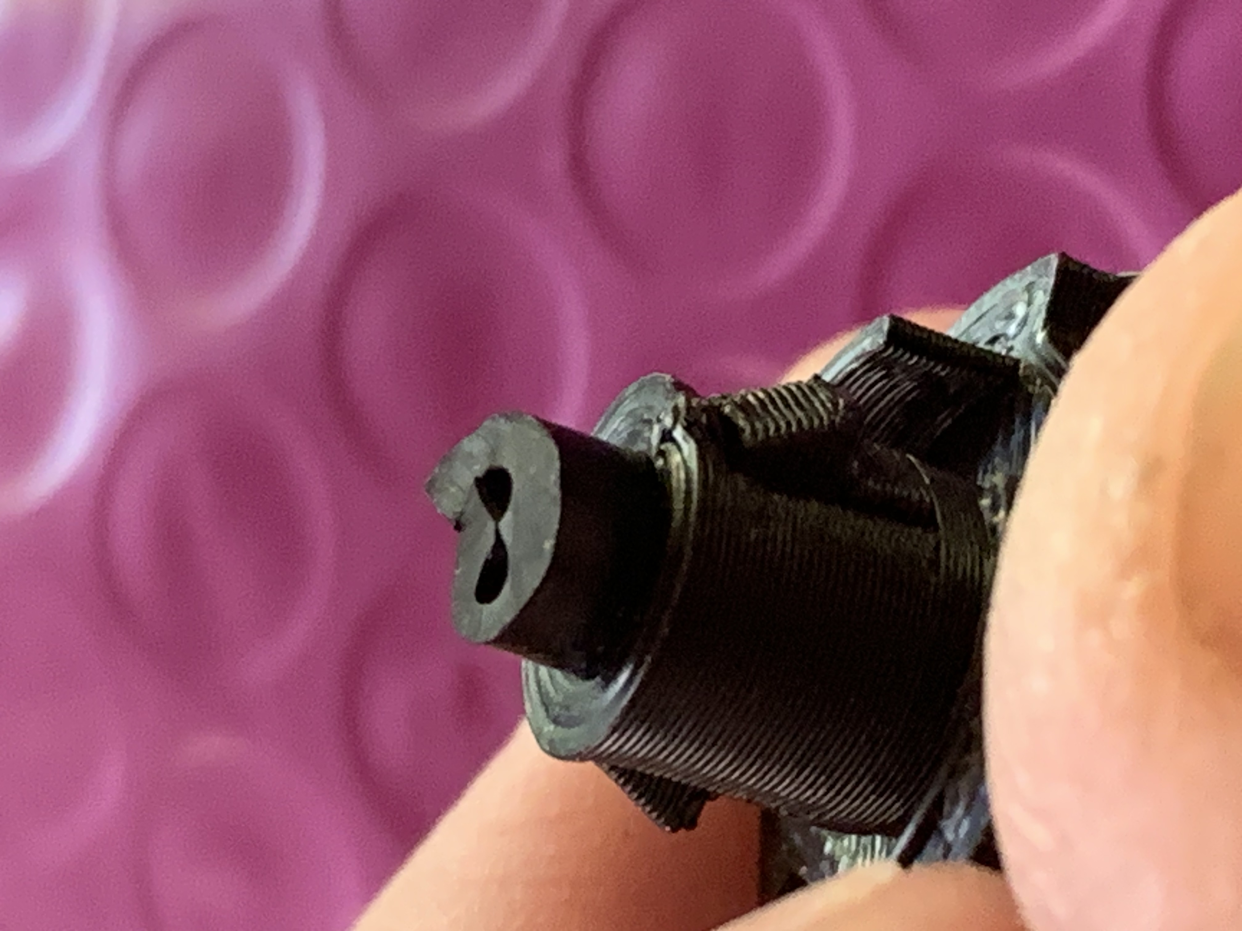

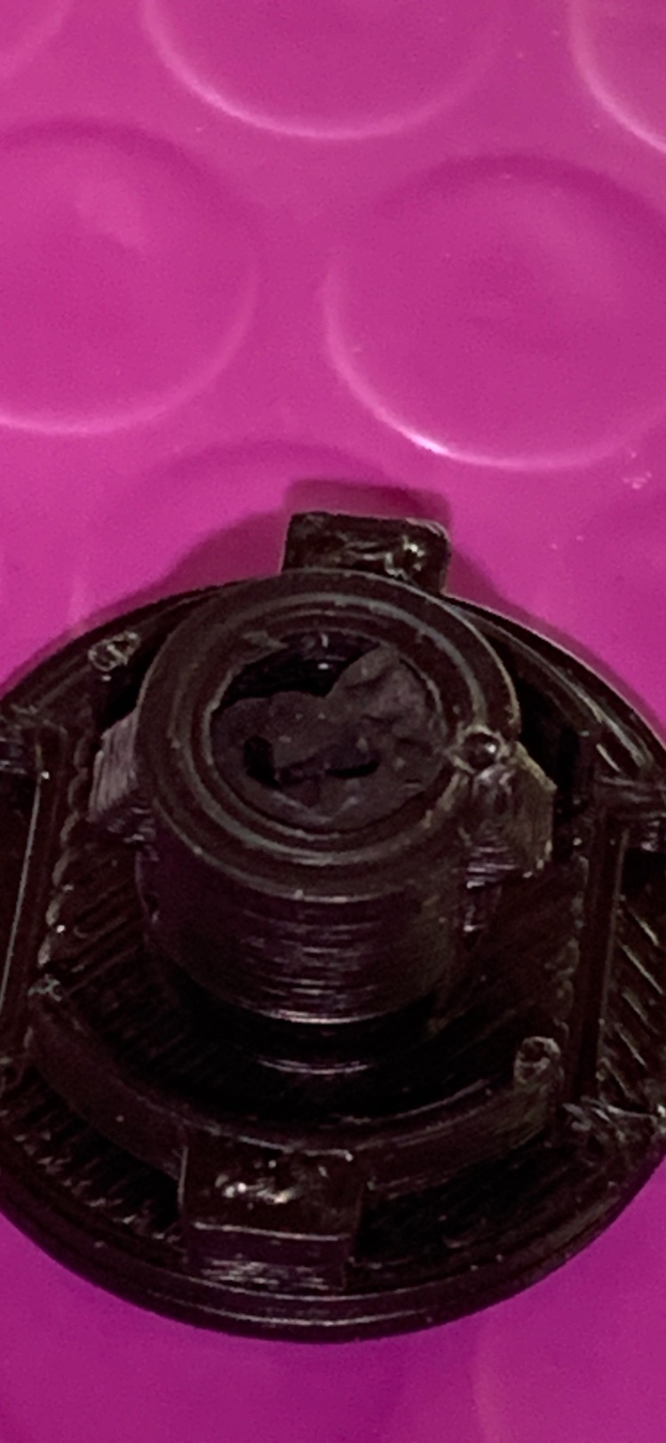

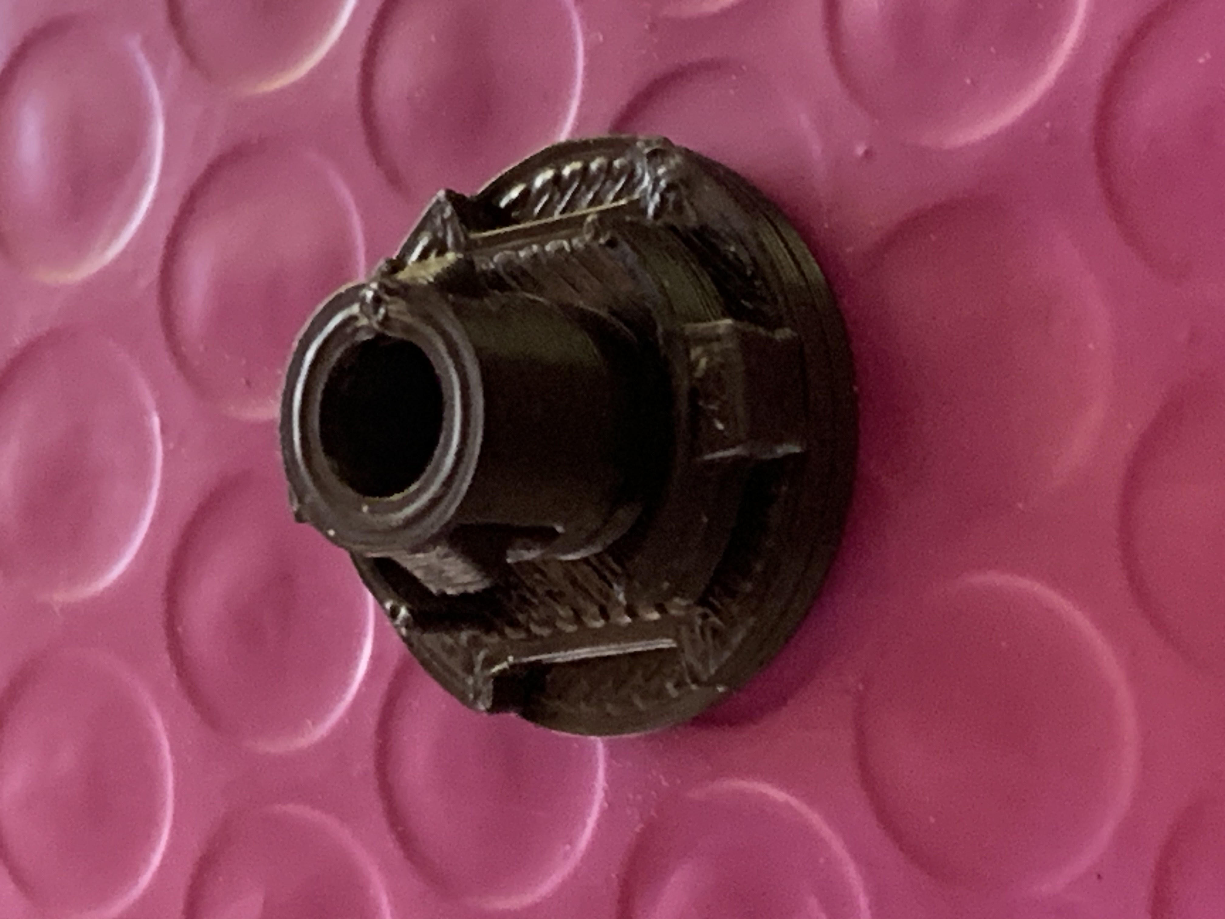

On the topic of Trim Clips, after removing some of the original button clips around the bed to install Sport Lights, I noticed the original clips have a rubber filled center. The 3d printed clips from eBay do not. I’ve been having an issue with failure/falling out of some of the 3d printed clips. The catches are fairly stiff and sometimes snap during insertion. Since I had some thick, rubbery wire insulation available, it gave me the idea to fill the center of the 3d printed clips (the original runner plug is too big for the 3d clips). So far, I’ve been having excellent results. I believe the back pressure keeps the catch from snapping. I hope this helps!
- Clip as it comes from eBay
- ACD0FCF3-EBB8-442D-B43F-5211D2720DBF.jpeg (1.28 MiB) Viewed 98432 times
- Insulation trimmed down to roll to the proper size
- A4E9F7C3-C89E-4AEA-B2AE-FAB47D9021F4.jpeg (1.36 MiB) Viewed 98432 times
- Rubber filled and ready to go
- 0F9EC8D4-EC5E-4246-9CF1-D3E33313E5BB.jpeg (176.39 KiB) Viewed 98432 times

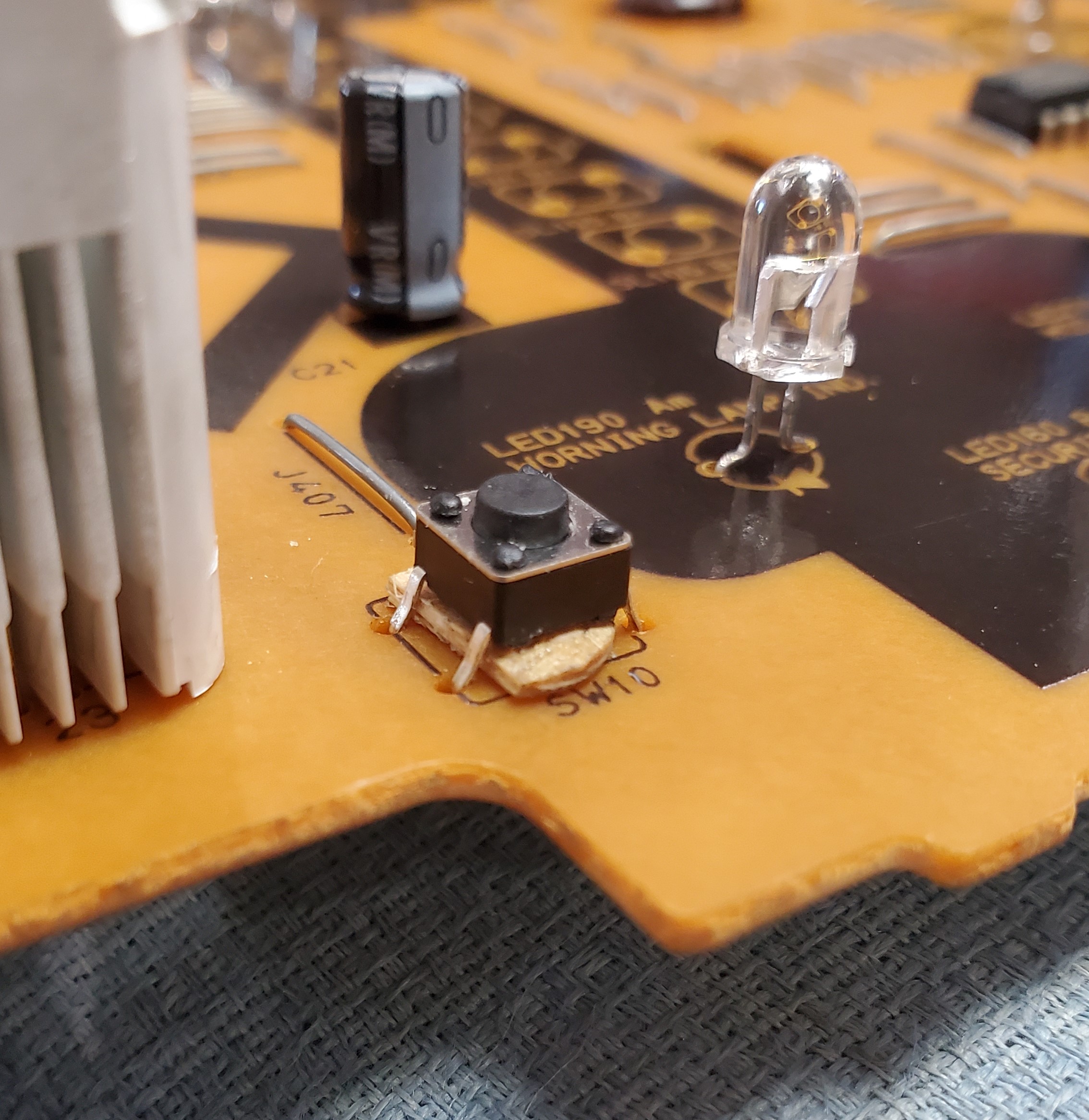

The trip odometer on my Baja had been bad for a while. Luckily, for me, it was just a bad switch and could be fixed it with one of these:
https://www.taninautoelectronix.com/pro ... et-switch/
If you don't have a hot air station be careful pulling the old one off because the traces are delicate. I was careful and one still peeled up a bit. It is a direct replacement but it doesn't sit flush like the OEM one. I cut and shaved a piece of popsicle stick then fit it snugly under the switch with some super glue. This way pushing on the button transfers the force into the stick/pcb rather than the traces.
