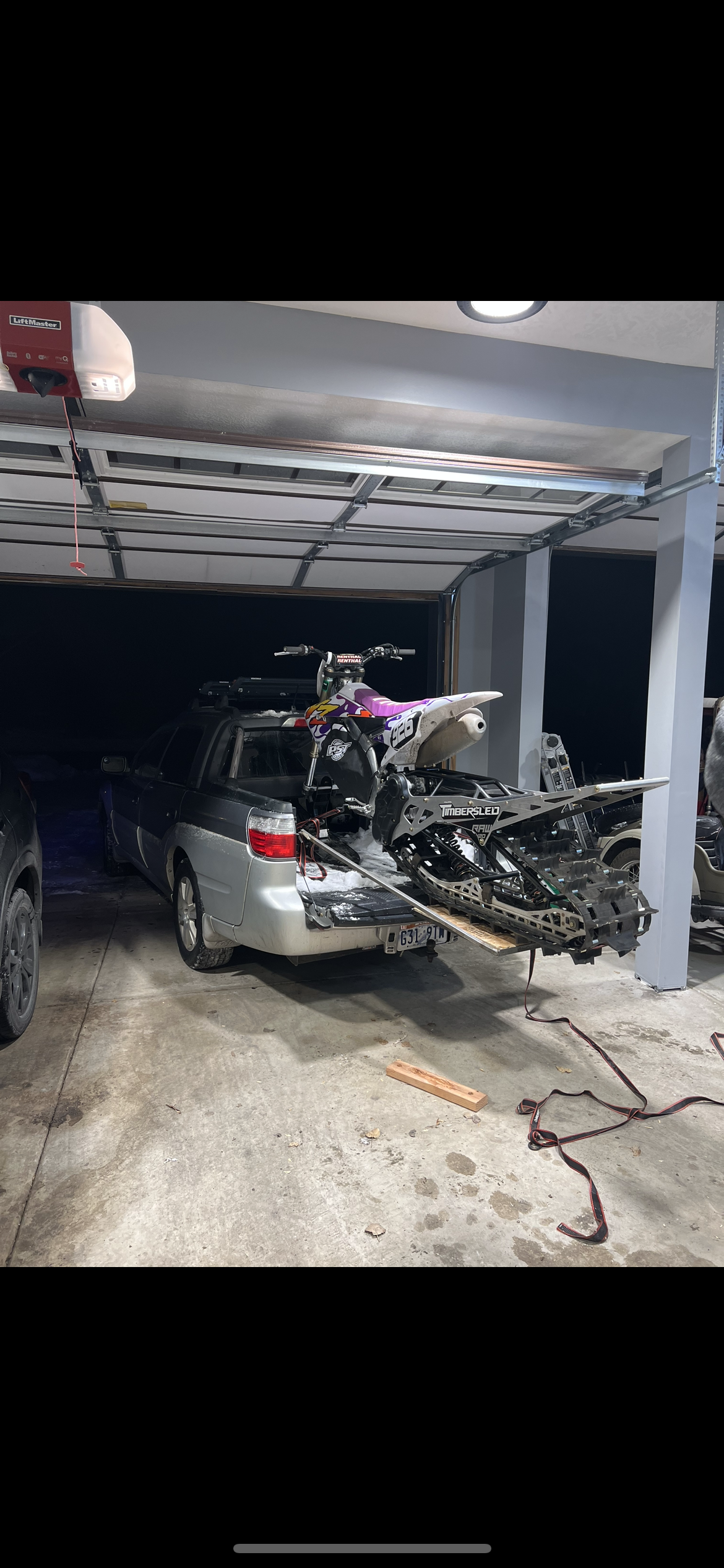

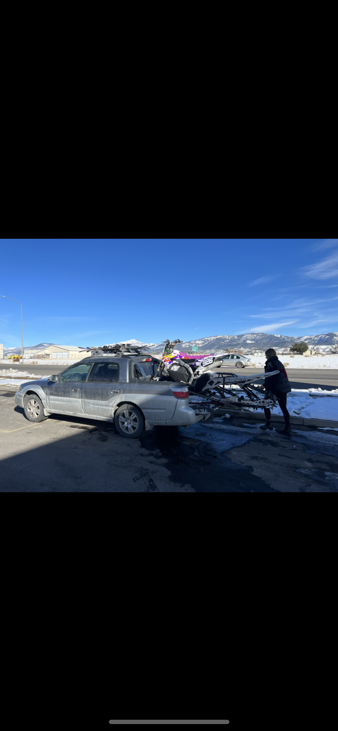

Welded a little truck bed extender in the back so i could fit my Timbersled in the bed. You just open the back door up and put the ski through then she fits great. Took it on a 3 hour trips to go ride and the baja did great on the freeway.

That's bonkers

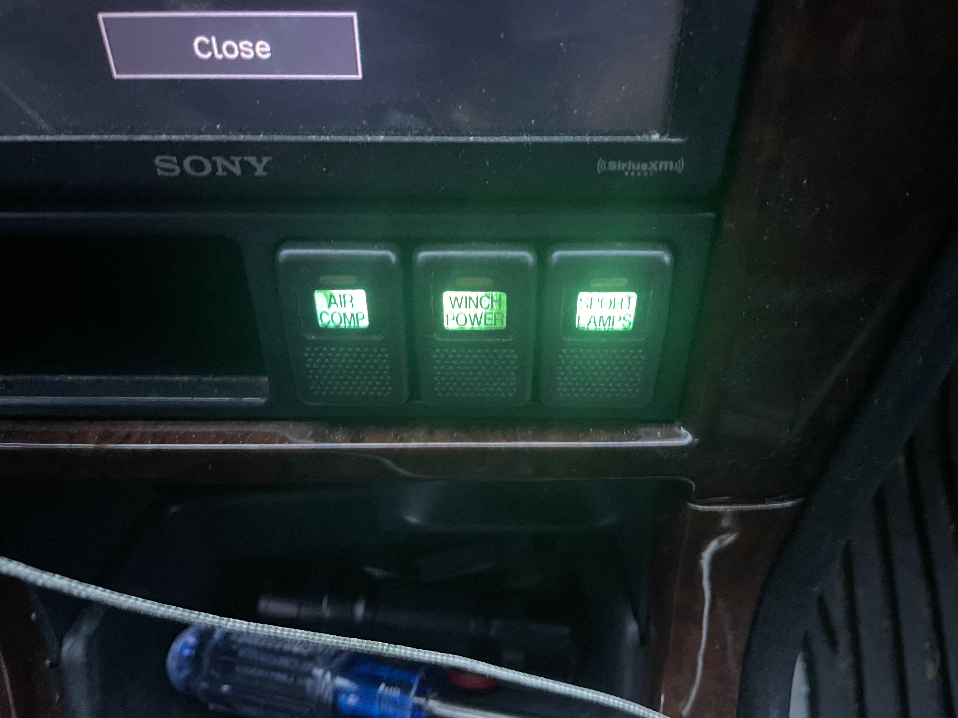

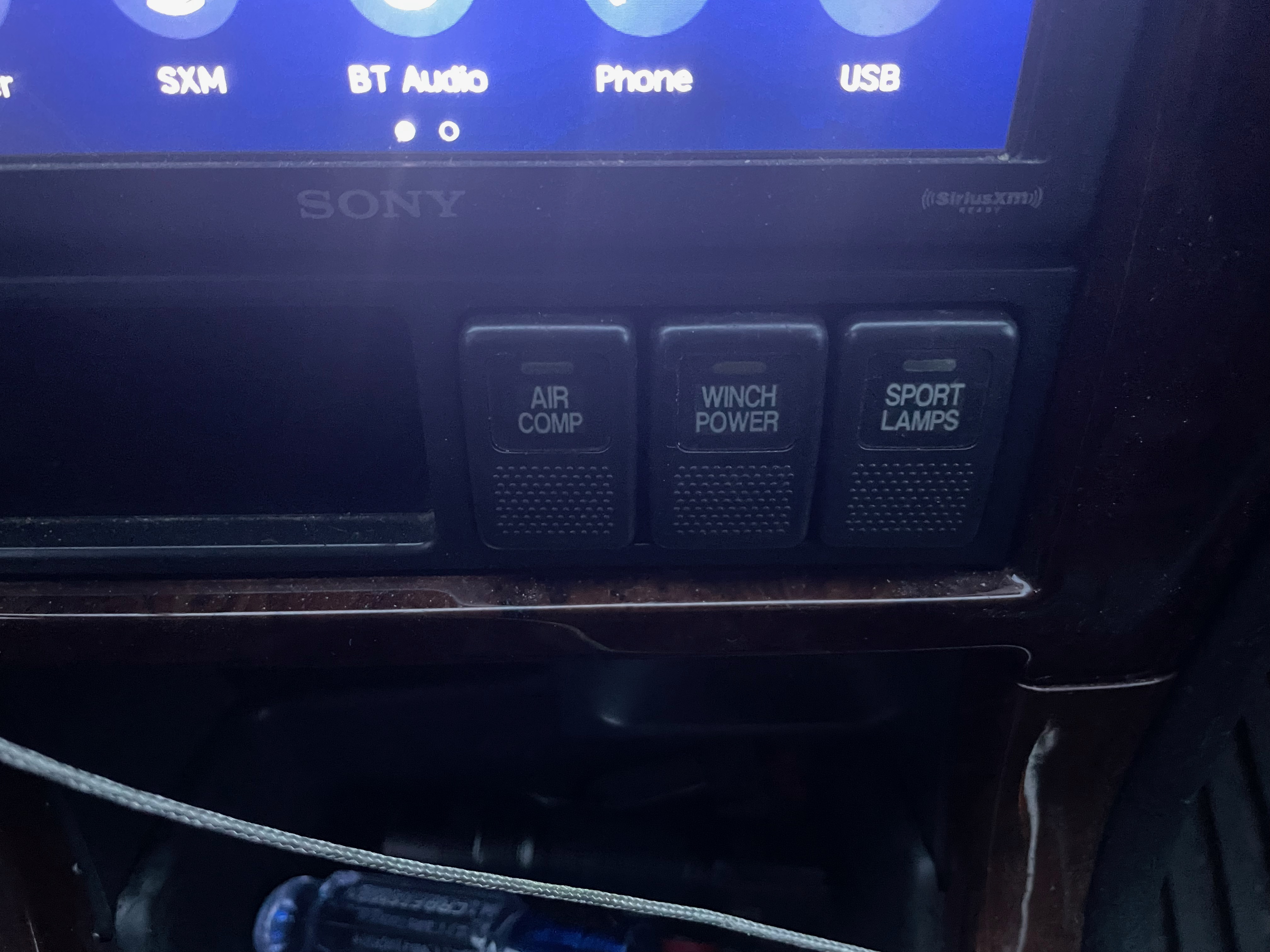

More goodies! I found this guy on eBay with sport light switches for sale. Asked for some custom switches and he cranked them out over night and shipped them to me.
Another scoobytruck guy with a Baja. mkwpros619 memberlist.php?mode=viewprofile&u=8419 created these and sells them online.
These are the lights installed in my truck.

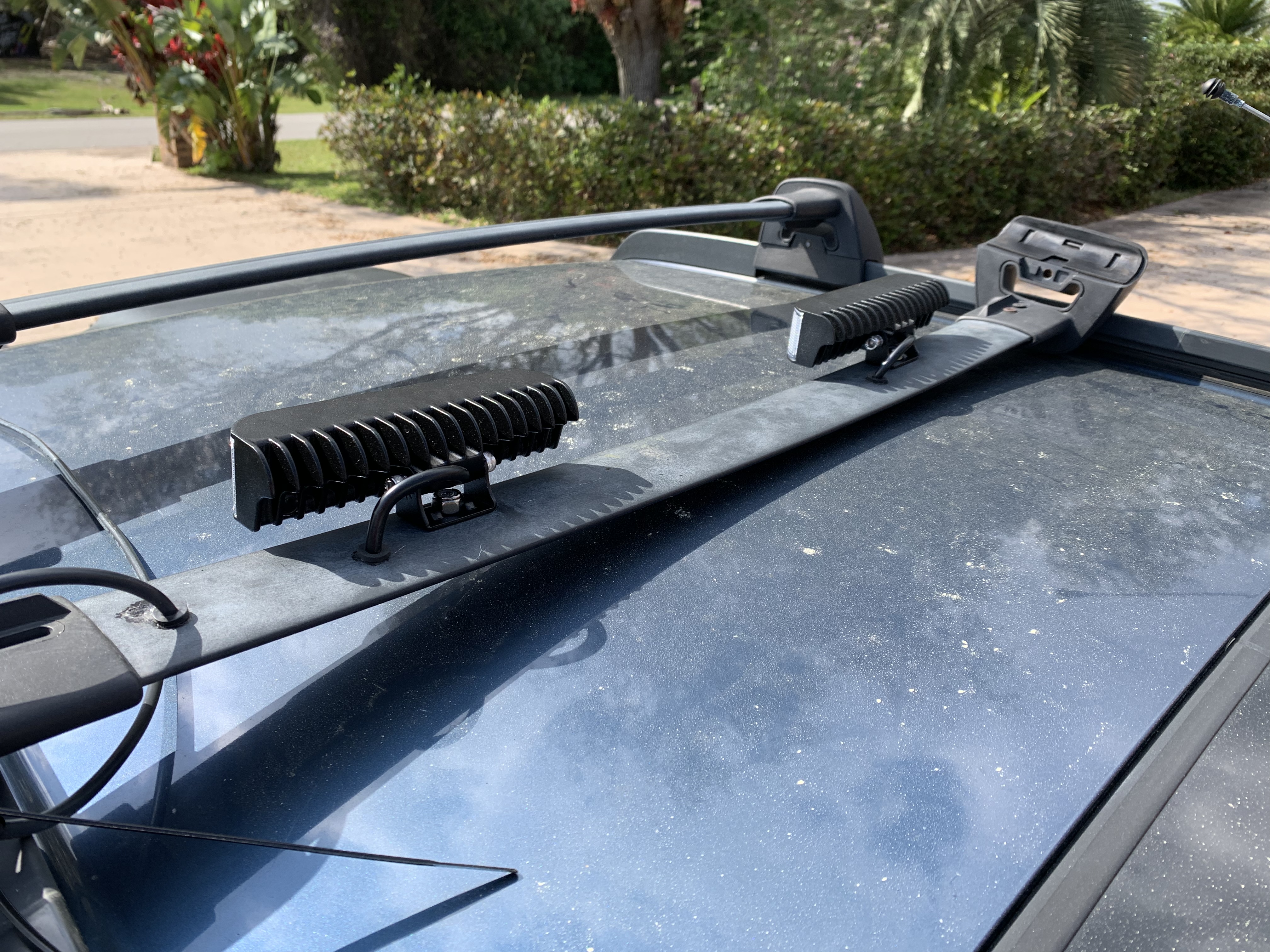

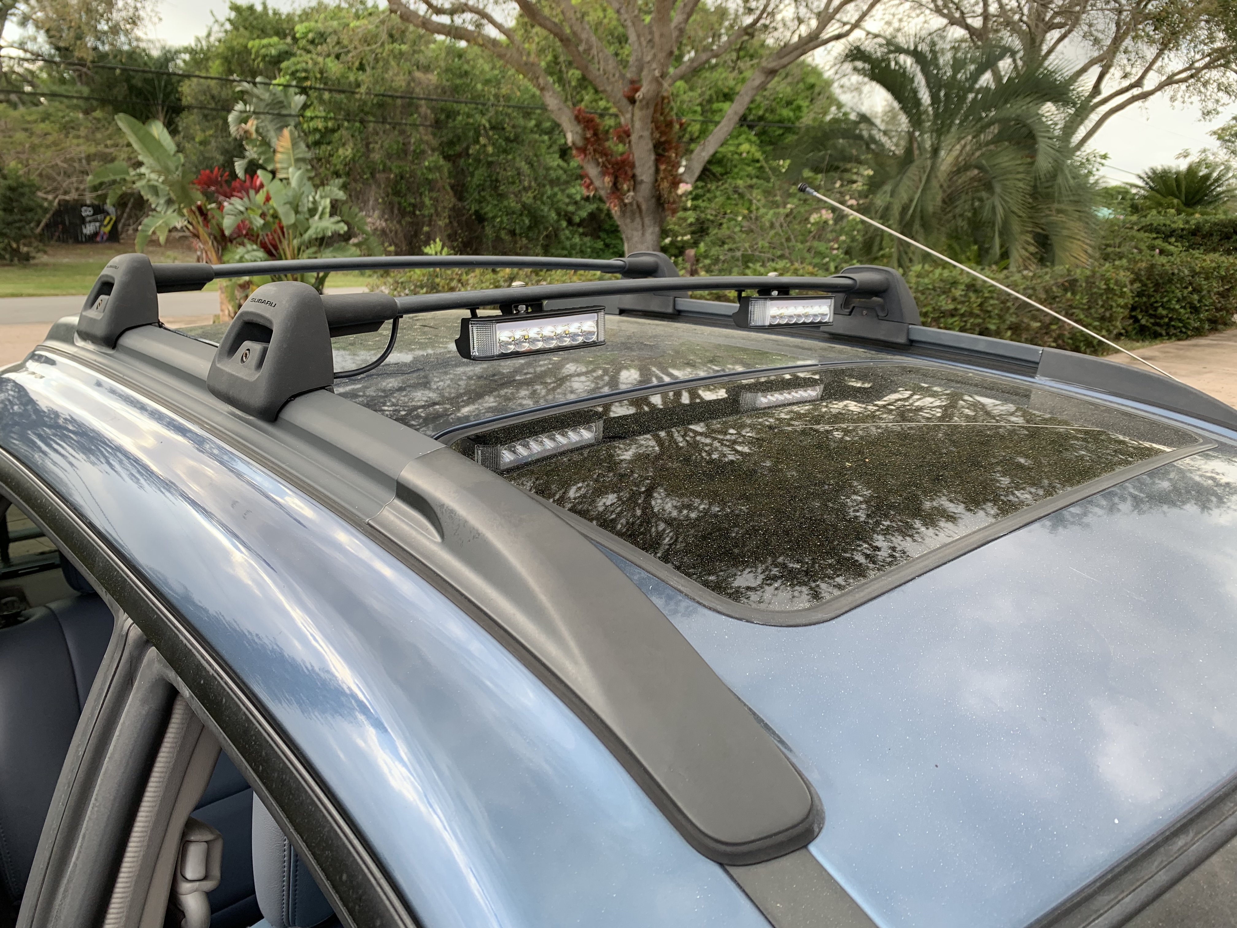

Finally put together some Sport Lights. I went with more aerodynamic LEDs, mounted under the crossbar with the wiring inside. I wanted them mounted under so I could still use the crossbar without having to mess with the lights. Not wanting to drill my original crossbars, I got some donors from an 05 Forrester in a yard, along with some relays. One crossbar was the correct size for the front, the other I cut down, drilled and tapped for the rear. I used the original sport lamp wiring with the switch from the ebay guy. The dummy plug from the connection in the center brake light was the fun stuff. Finding terminals to fit the dummy plug and make it functional was the hardest part. I grounded the yellow wire from the switch to eliminate the ebrake one click trick and everything functions beautifully. Thanks to a bunch of helpful previous posts from other users, I was confident I could get it done. Thanks guys!

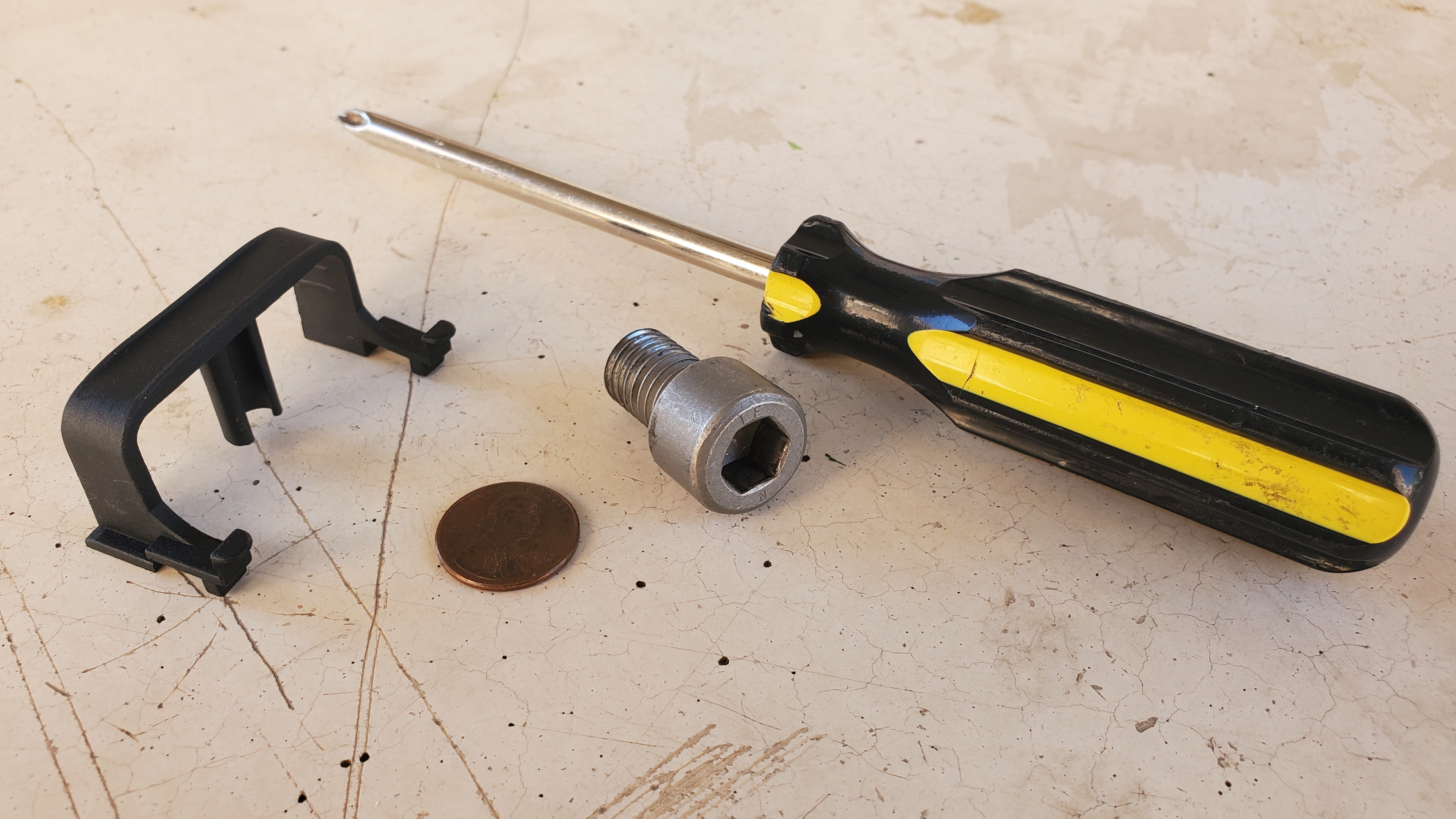

I don't know if this is the right place to ask, but I have a bolt and plastic piece in my "Subaru Parts Bin" but can't recognize where they would go on the vehicle. Anyone know what they are or if they wound up in there accidentally? The penny and screwdriver are just for scale.

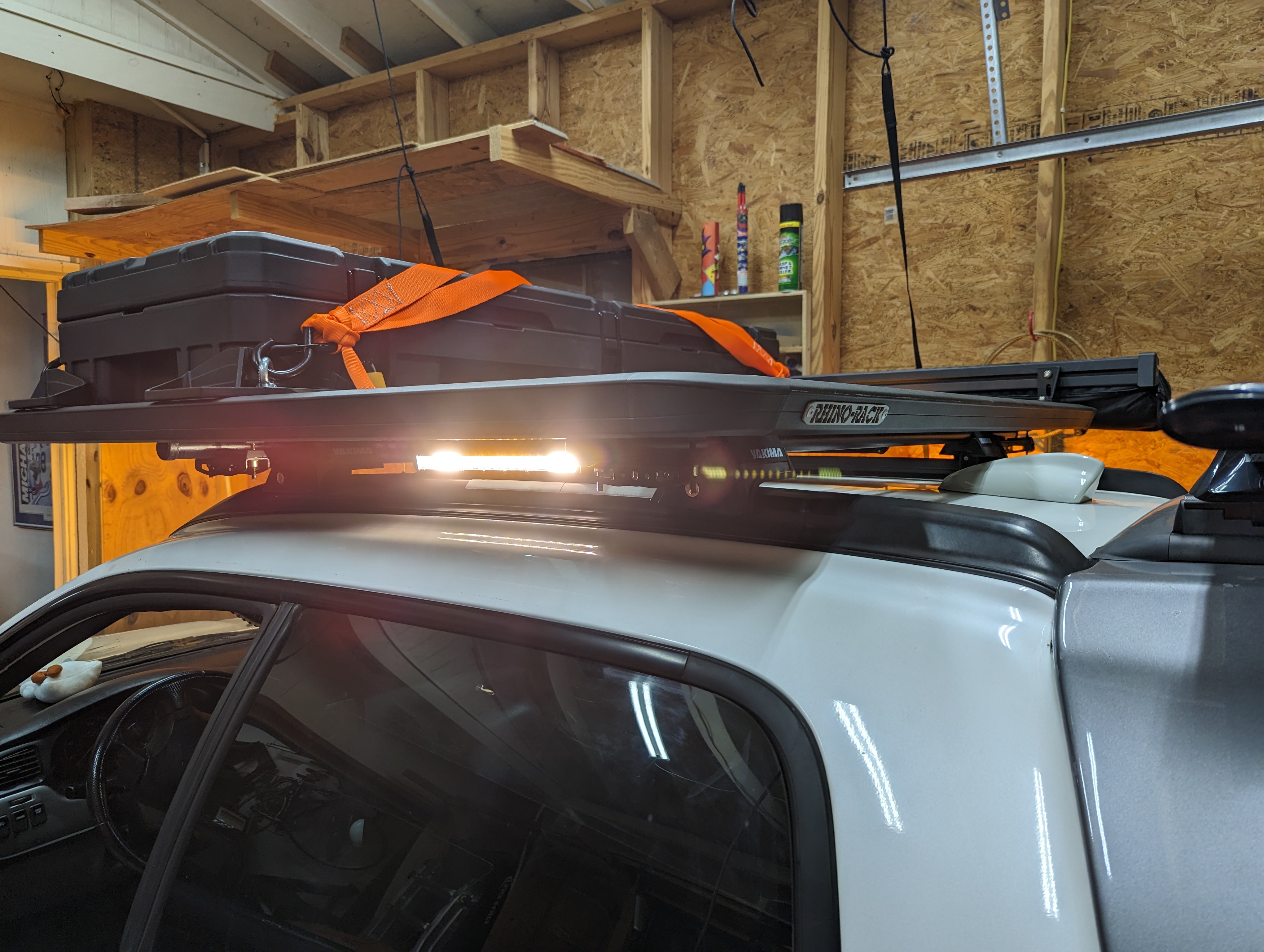

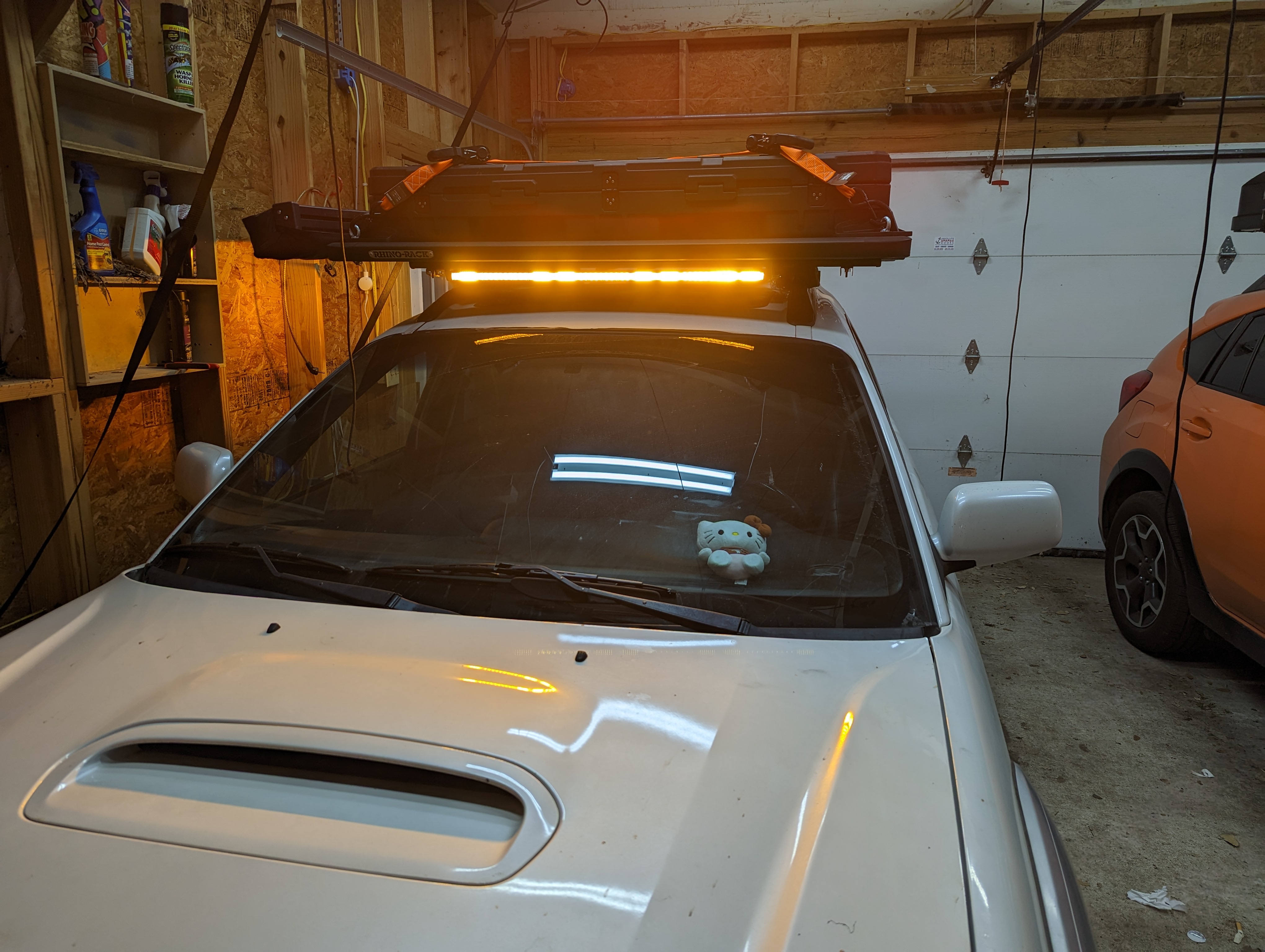

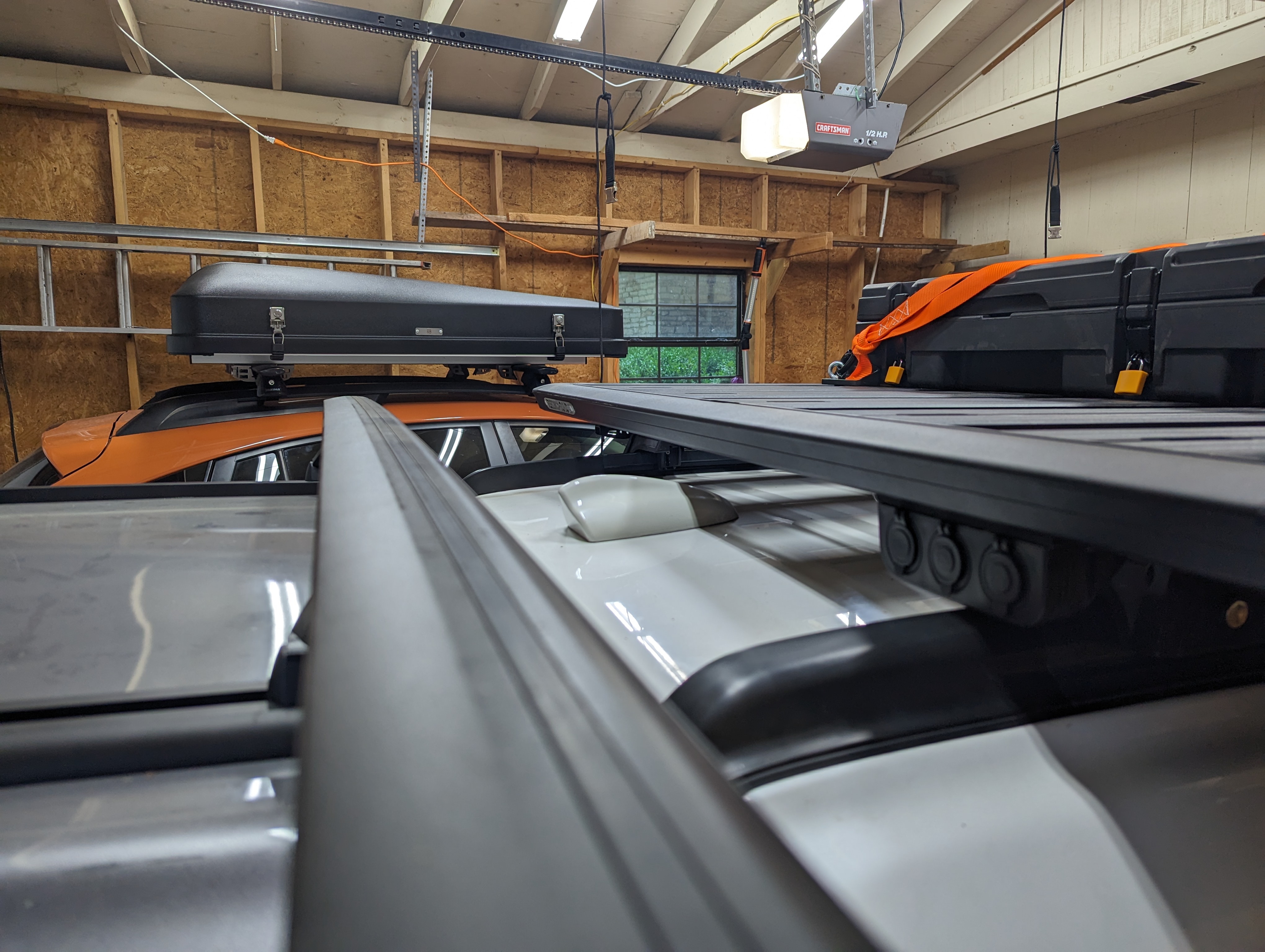

it's almost time to go camping, y'all!
Rhino Rack, shark fin antenna, aux power hub:
Front light bar:
Side light bar (passenger side matches):

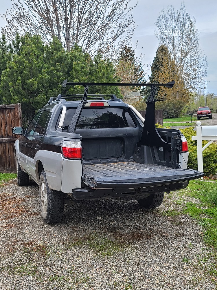

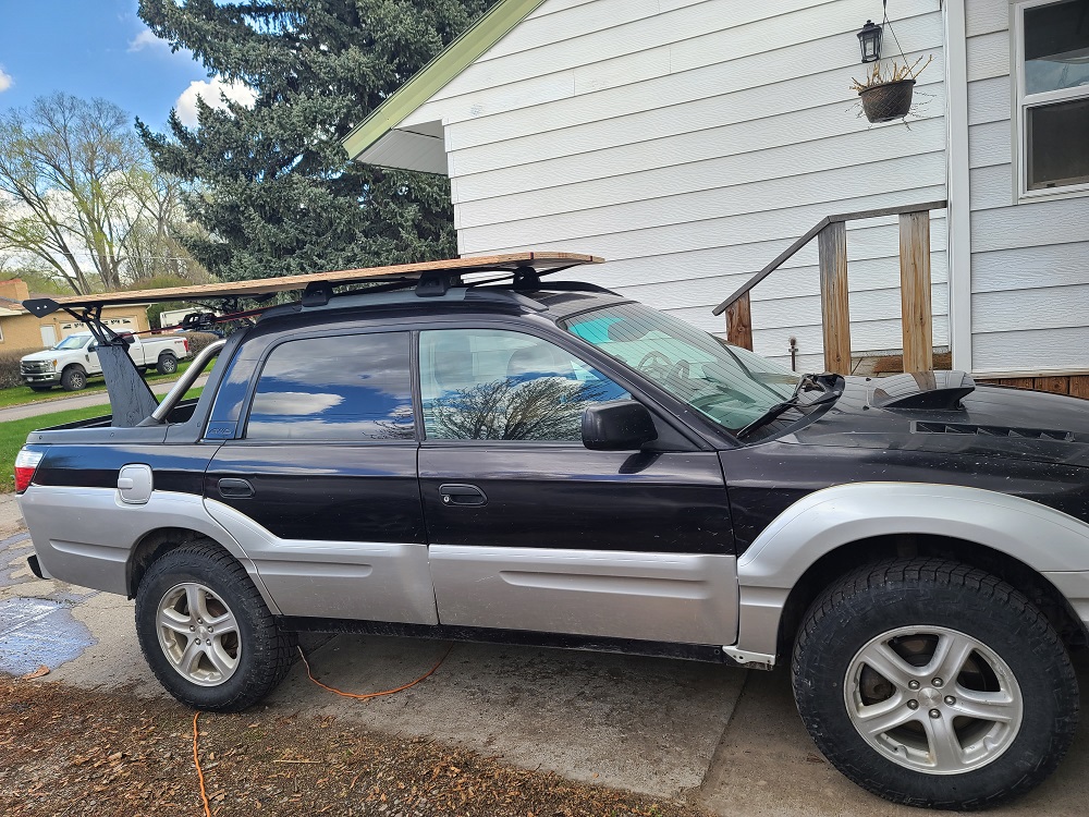

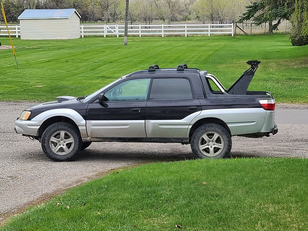

Made a rear spoiler/ cargo extender for plywood sheathing and such. Just two knobs to unscrew for removal. Cargo area of the bed mostly unaffected. Works great and looks sporty though I generally remove it when not needed.

Nice scoop!
Any details on the build?

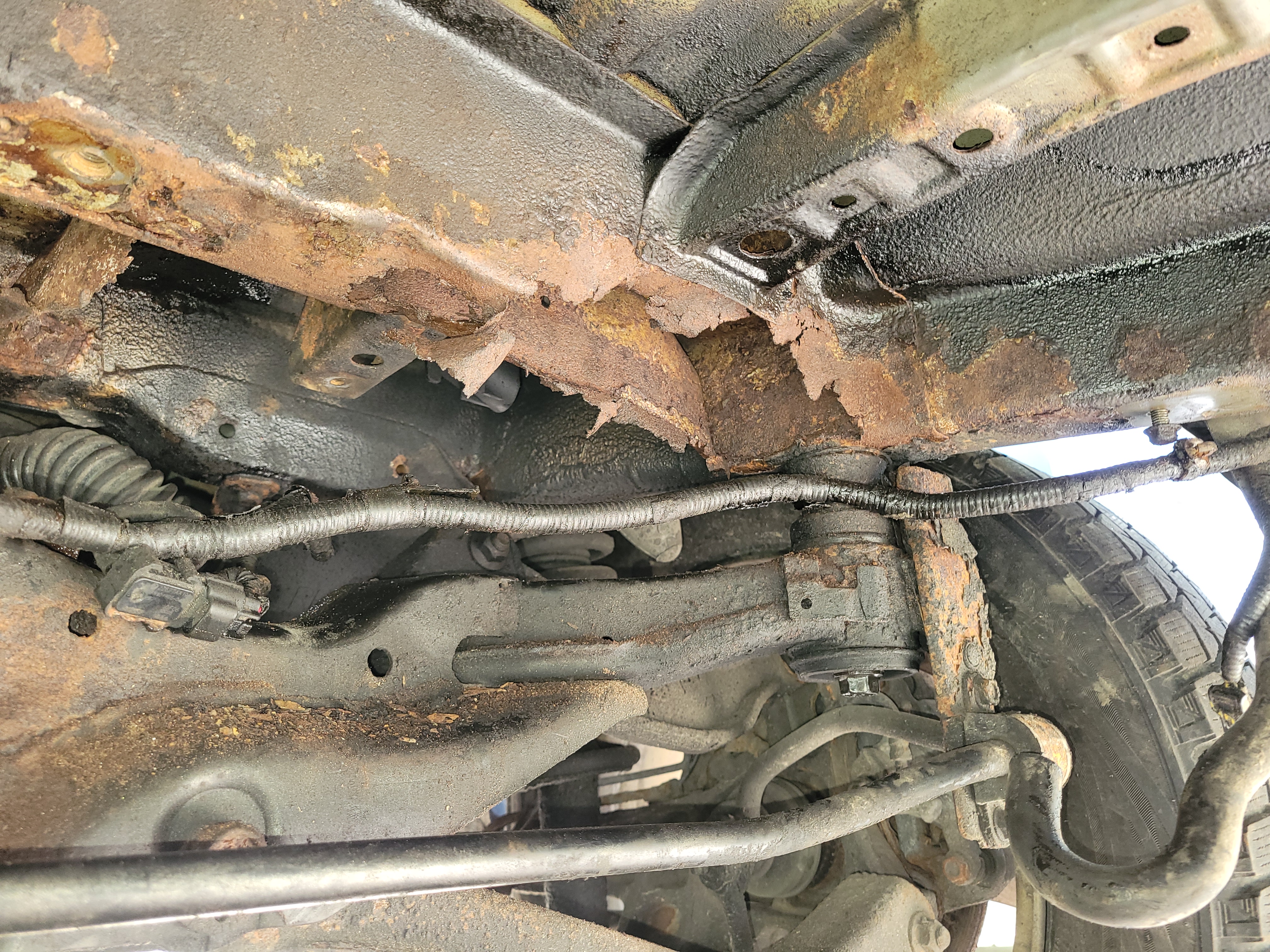

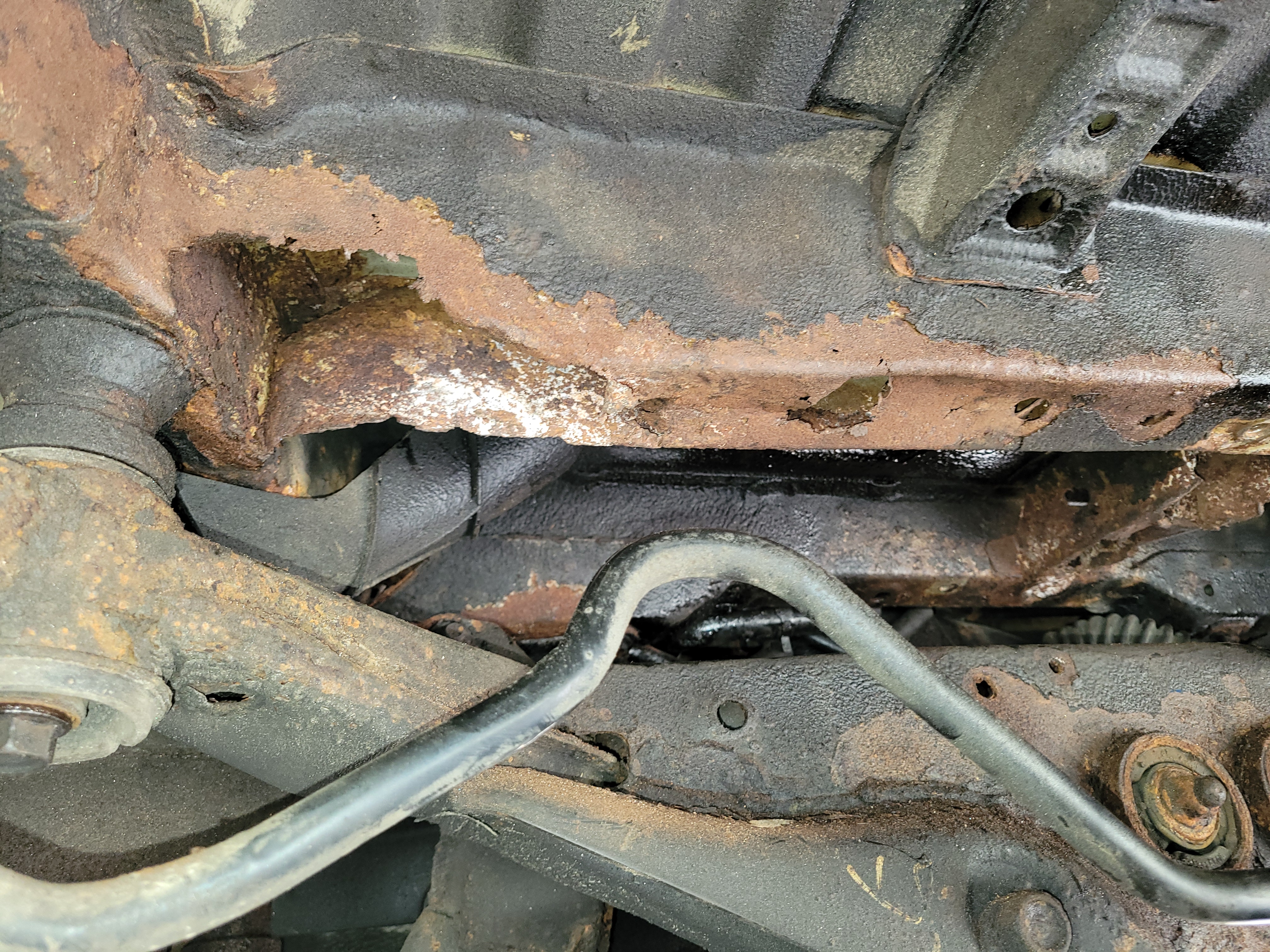

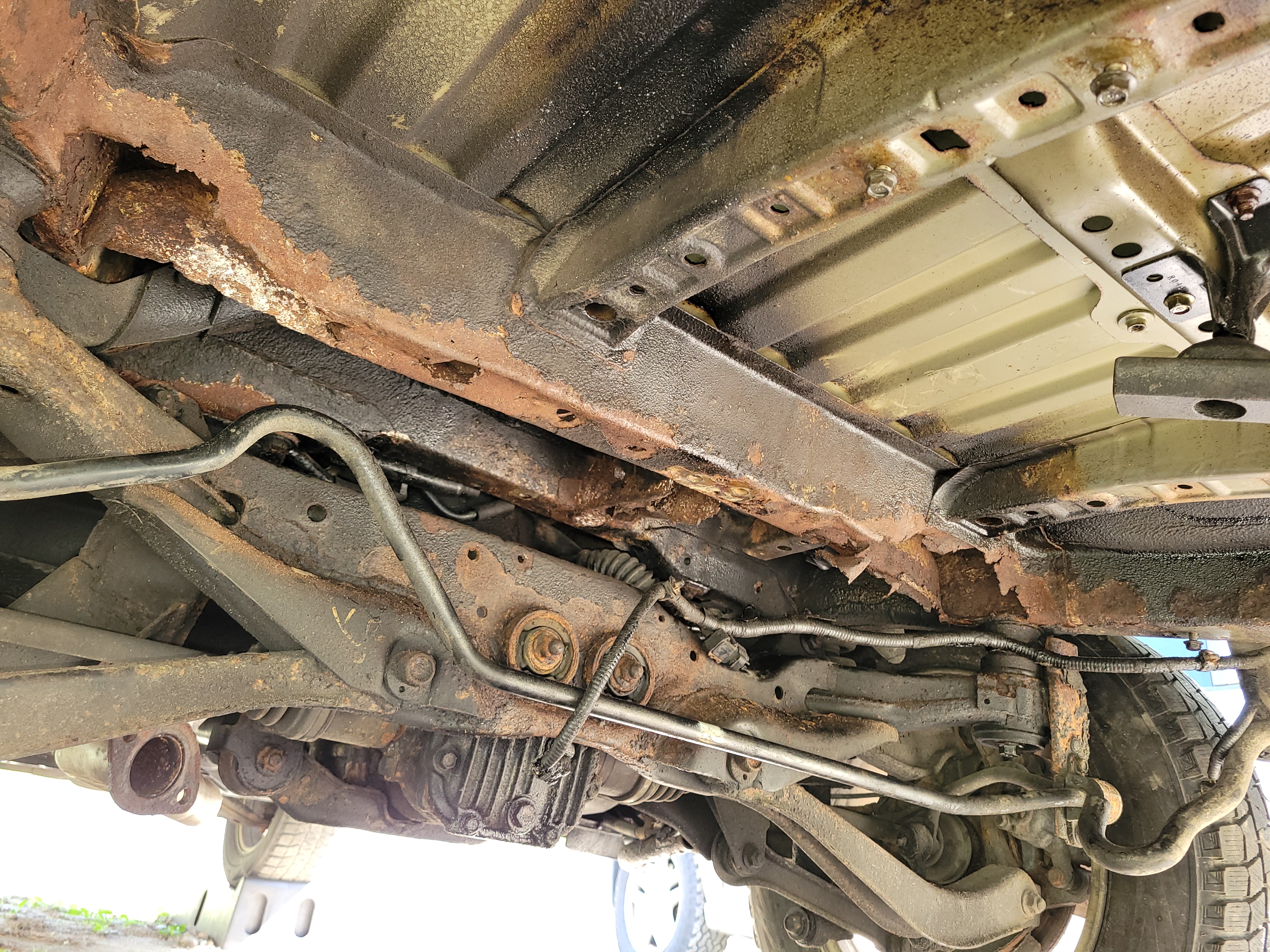

Finally pulled the band aid off. Took the spare tire and holder off. Muffler, charcoal canister gone. Loosened the subframe bolts. Tomorrow i will finish taking the fuel lines off and probably filler neck. All that to cut out, make and weld in the rusted crossmember. I will jack it up a bit higher so i can sit up straight and probably lower the subframe for a little extra room. Im glad i have my 06 to compare it to lol.

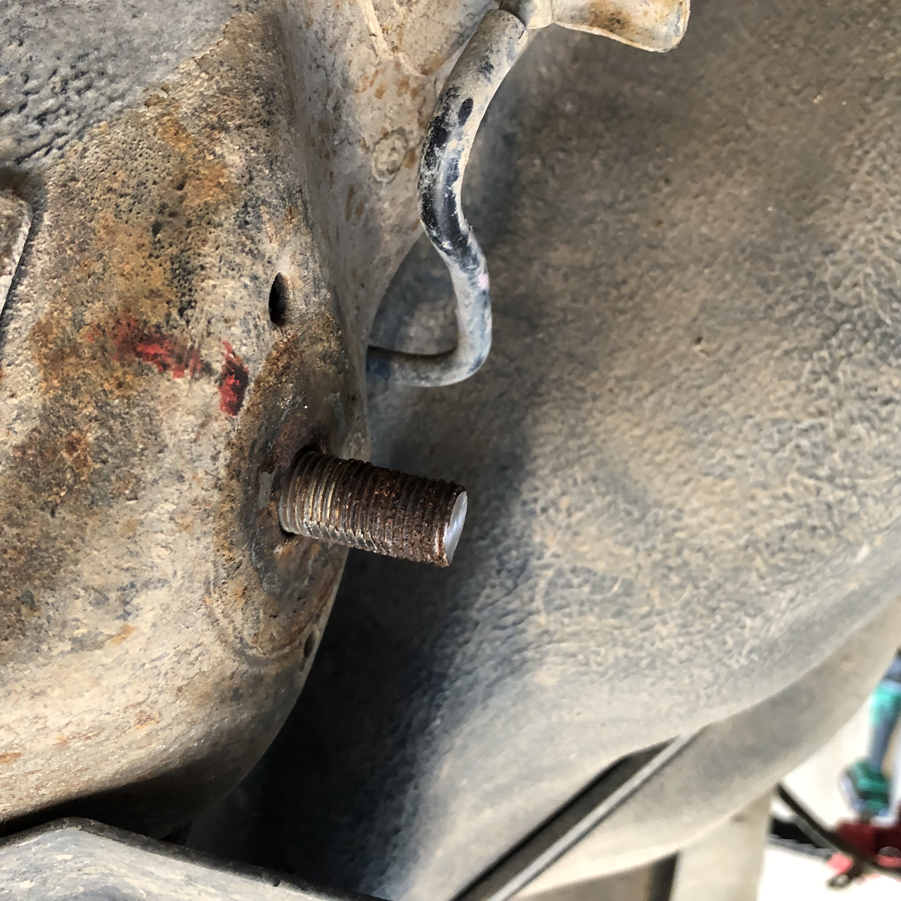

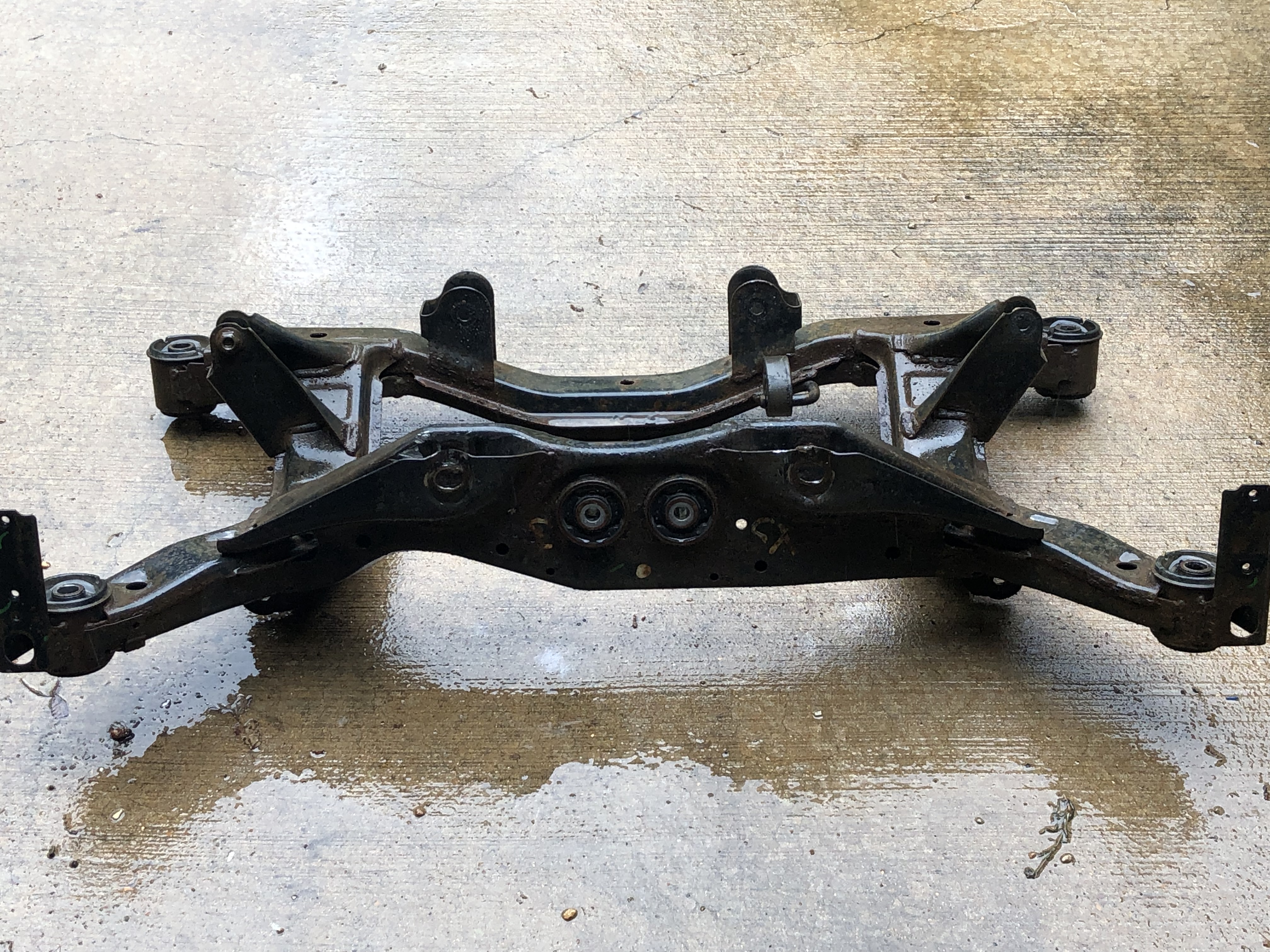

Finally made some progress on a rear subframe removal as well. Broke both the front bolts, but got it removed and in the process of drilling out the drivers side. Passenger's side has more bolt left, so I'm hoping to be able to eventually get it unstuck.
Trying to find a place in town to blast and prep the frame and some suspension components to try and stop the rust, then it's re-assembly (the fun part!).
- And yes, I do see the damage to the brake line :| Got a little tight with the angle grinder flattening out the bolt stub :shock: ... that might be the next project.

That rust looks really familiar. Just picked up my first Subaru last weekend (2005 Baja Turbo). About all that is really rusted is that one frame crossmember and the bumper braces. Unfortunately, it also seems to need a clutch, as it started slipping on the drive home.
