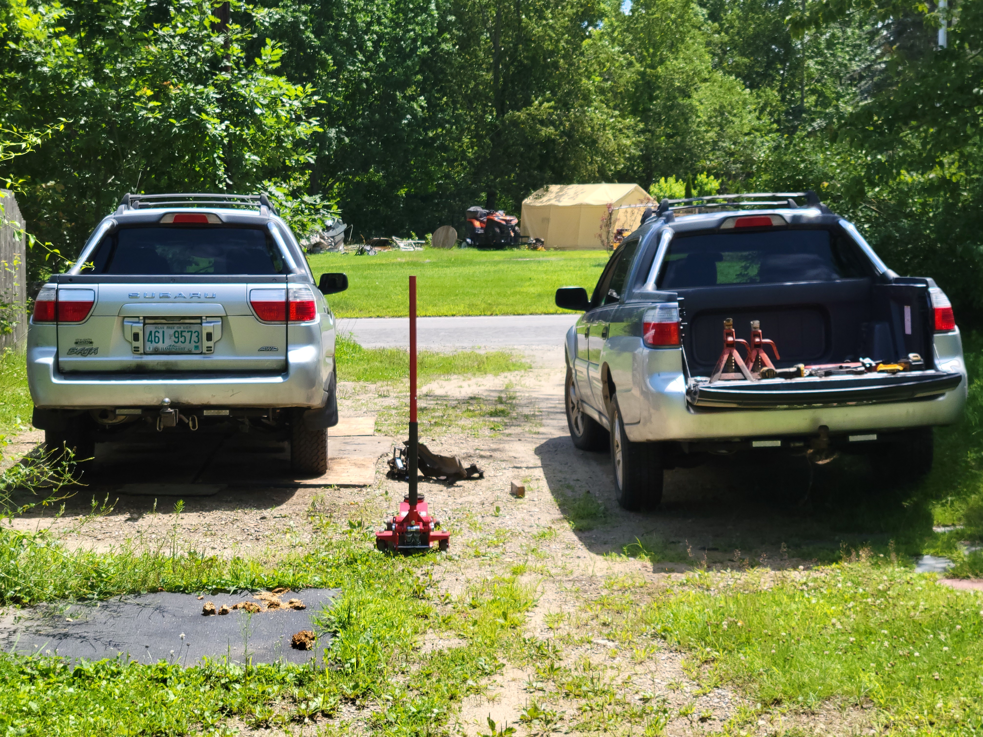

Post by 06Suparu »

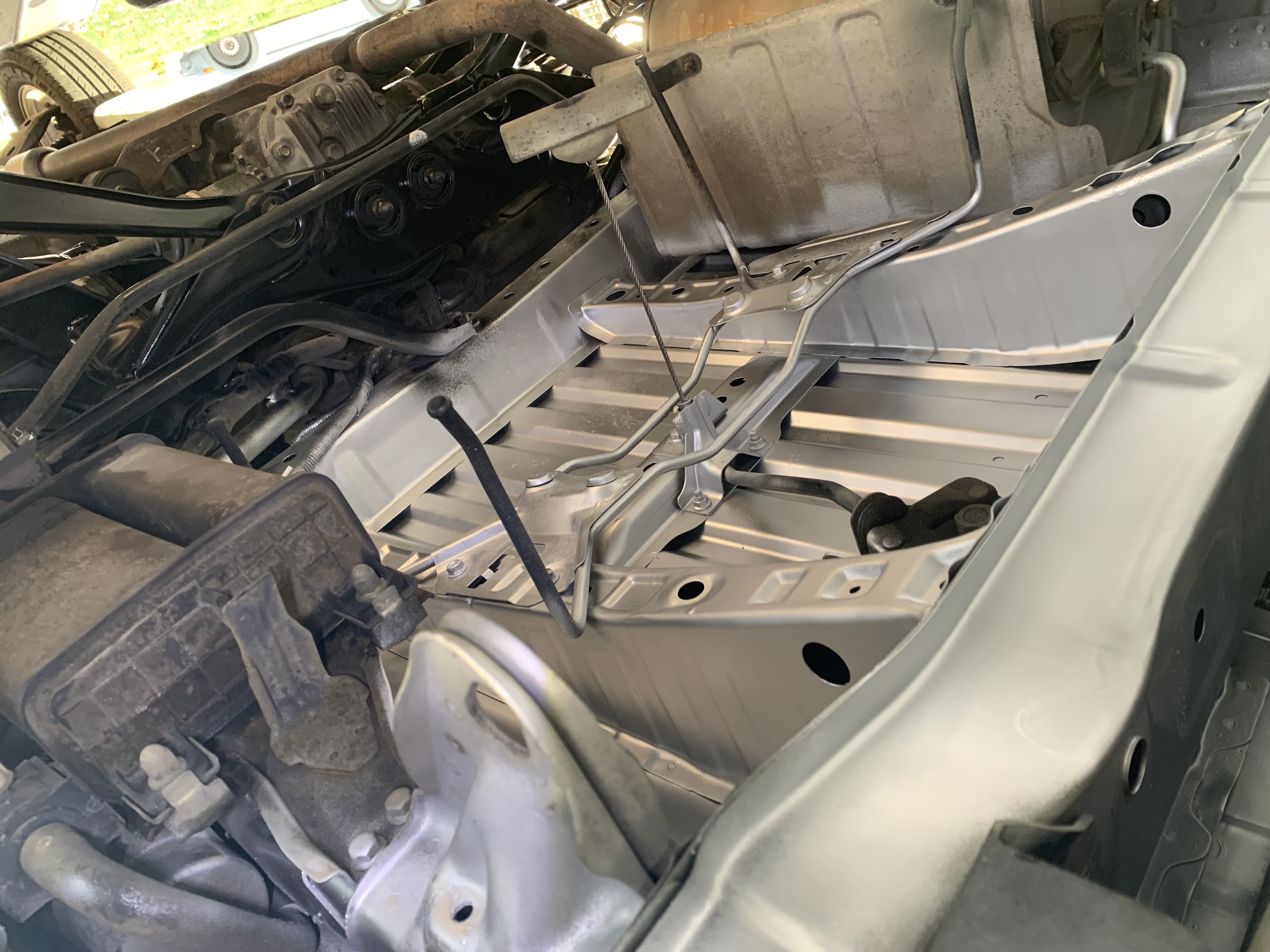

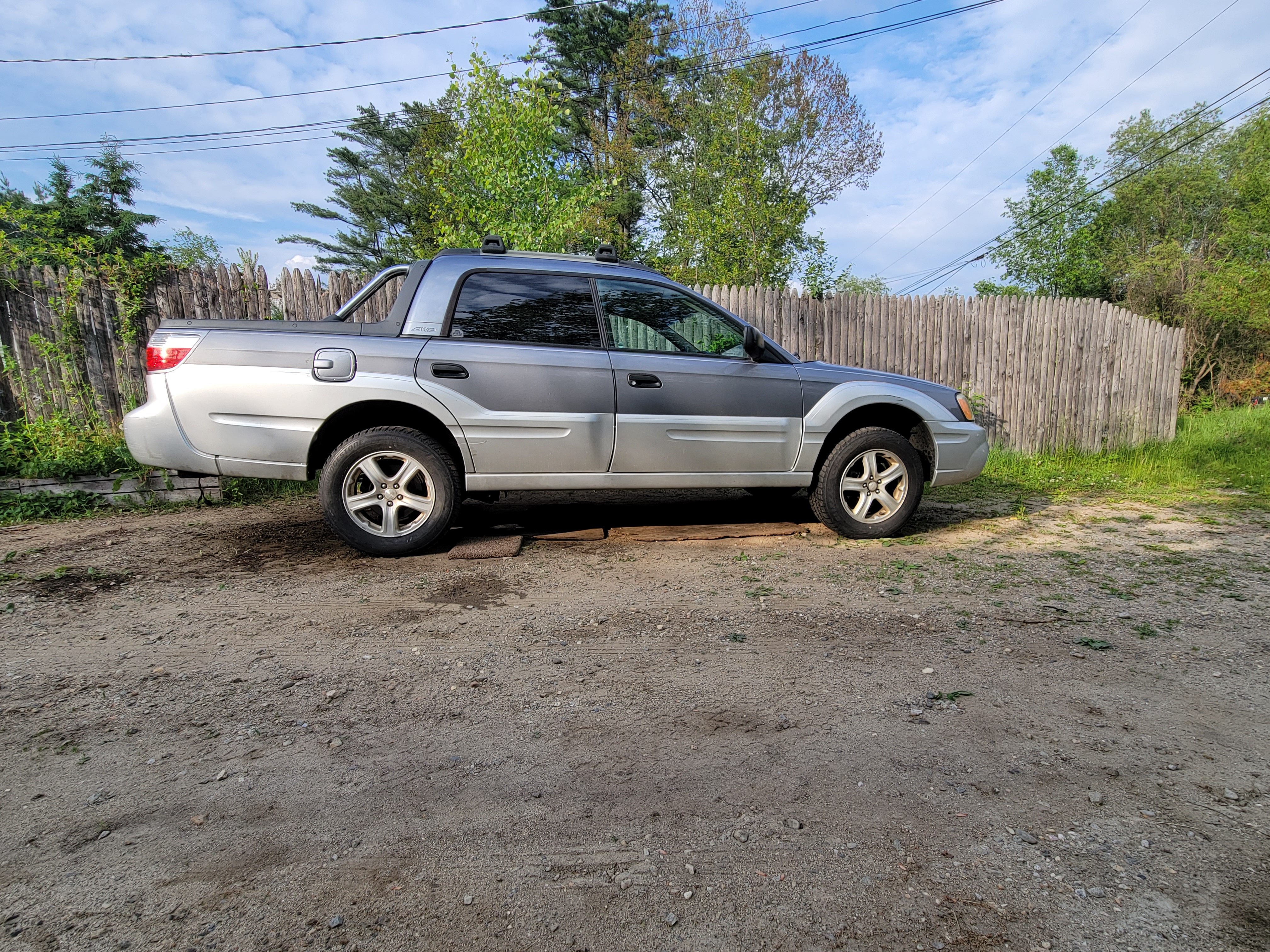

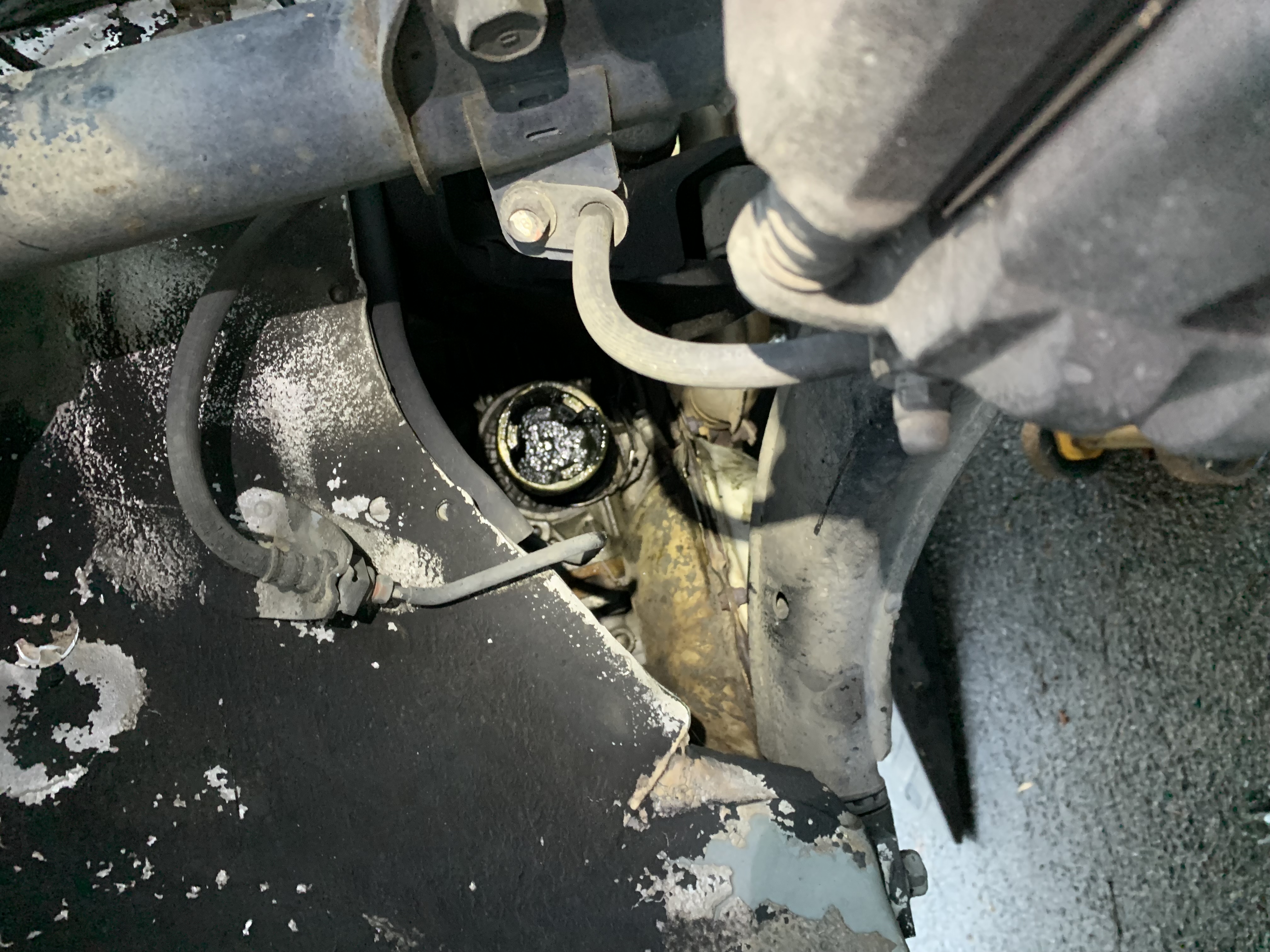

Its easy enough to make the crossmember. Its slightly over 36 inches wide. Home Depot sells 36 inch long metal. Its a pain taking everything out though. It was a learning experience lol. My advice is to start with taking off the passenger rear tire. You need to get to the fuel filler pipe and its bolted behind the plastic inner fender.
06Suparu
Posts: 124
Location: New Hampshire
Post by 06Suparu »
And the lift is in. I see a fuel leak. Its probably the fitting i put in to replace the rotted vent line. I will fix that tomorrow. Also replaced the driveshaft with the Outback wagon i have for parts. That solved the shutter when i drive. Just need an alignment now and replace a leaking trans line at the radiator.
06Suparu
Posts: 124
Post by 06Suparu »
So close to done. Had to replace the radiator because the trans fitting had a small hole close to the radiator. Decided to put another bottle of CLR in and run straight water for a month or so. Put new rotors and pads on the front. Just sprayed a gallon of black Fluid Film under it. Looks all pretty under there now lol. Cant get it alignes until July so i think its safe enough to do it without them thinking im a dick. I think i will put my all terrains on it after the alignment. Oh and a windshield since my snowblower decided to play a game with it last winter.

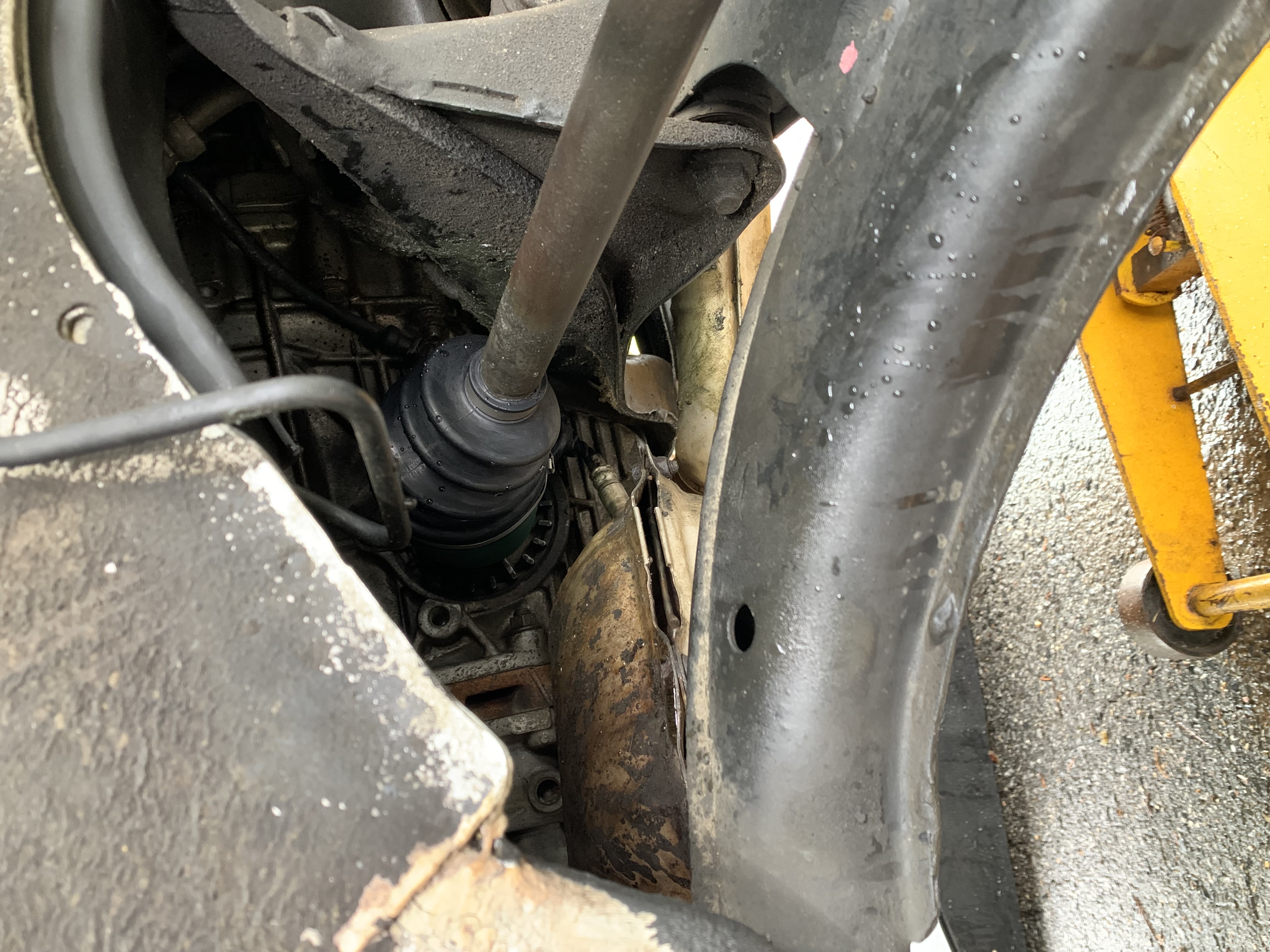

new_2_soobaaroo
Posts: 13
Joined: Sun Jun 04, 2023 5:36 pm
Post by new_2_soobaaroo »
In the past few days, worked on getting ready to change clutch:
- Removed axles (The inner CV boots are ripped, so I'm wondering if the 2" ADF lift that was installed on my Baja before I got it is putting too much angle/stress on them. Love the ride height, though.)
- Brake dust shields crumbled in the process, so new ones are on order. I hate NY rust.
- Started removing transmission bolts.
- Removed intercooler to get access to top of engine.
- Removed radiator and a few things up front, as a timing belt change is about due anyhow. Might as well do it all at once.
- Trying to figure out where my coolant is going to/leaking from. No clear sign of leaks, except everything near the lower radiator hose is covered in old, dry antifreeze. I'm thinking water pump is leaking, but I haven't gained access yet as the timing cover bolts are so rusted that I can't get them free. Just rounded off further. Did I mention I hate rust?
- Discovered that right side wheel bearing is very loose. Yay! More work to do.
- Also need to replace the lower radiator mounts, as they are almost non-existent. I hate rust!!!
- Was working on removing the starter when it started to rain.

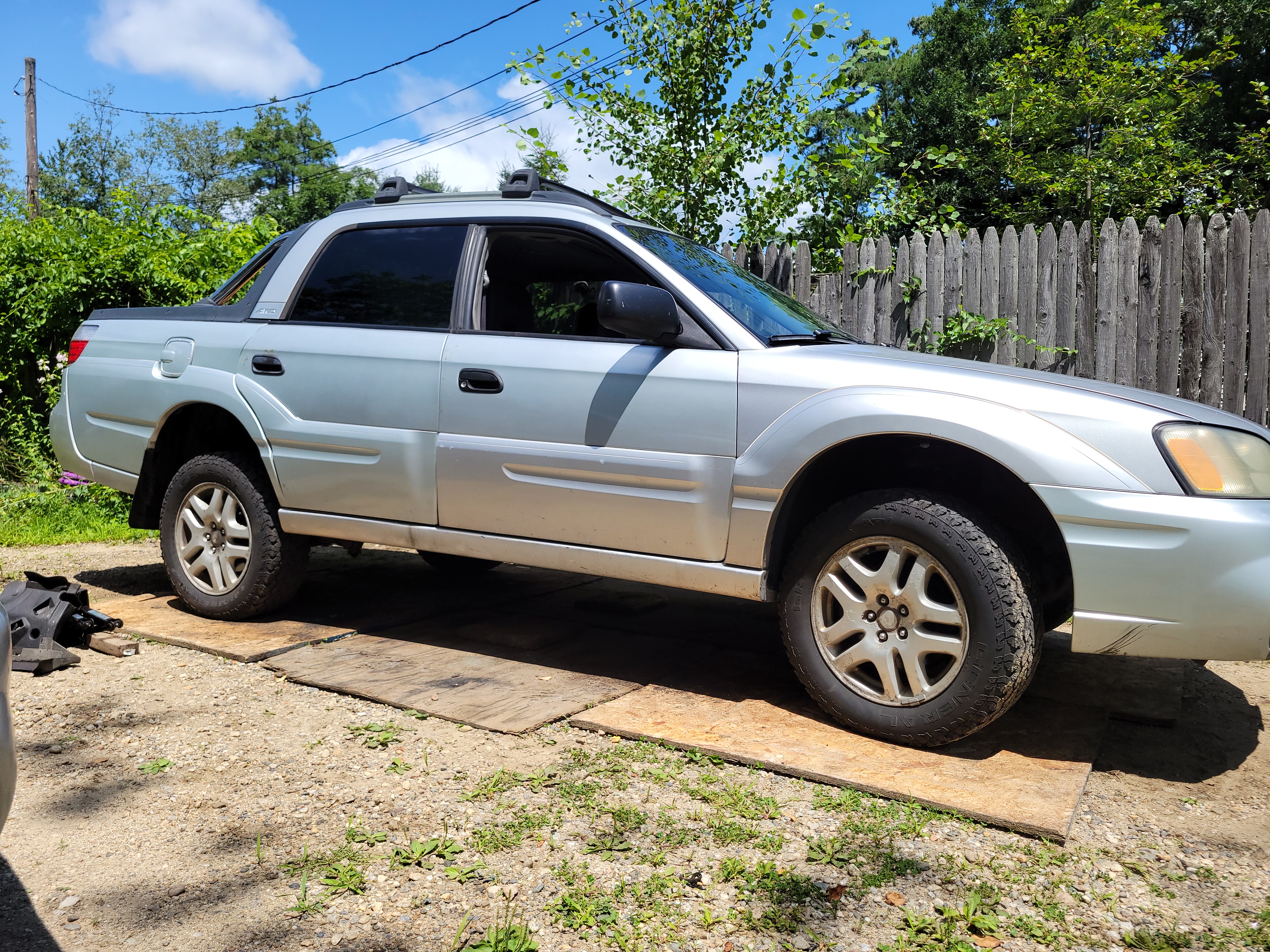

06Suparu
Posts: 124
Post by 06Suparu »
Brand new struts and springs front and rear. 2" lift. Tacoma struts for the rear. Its about 2" higher in the rear that my 05 with stock Baja springs and struts and 2" lift.

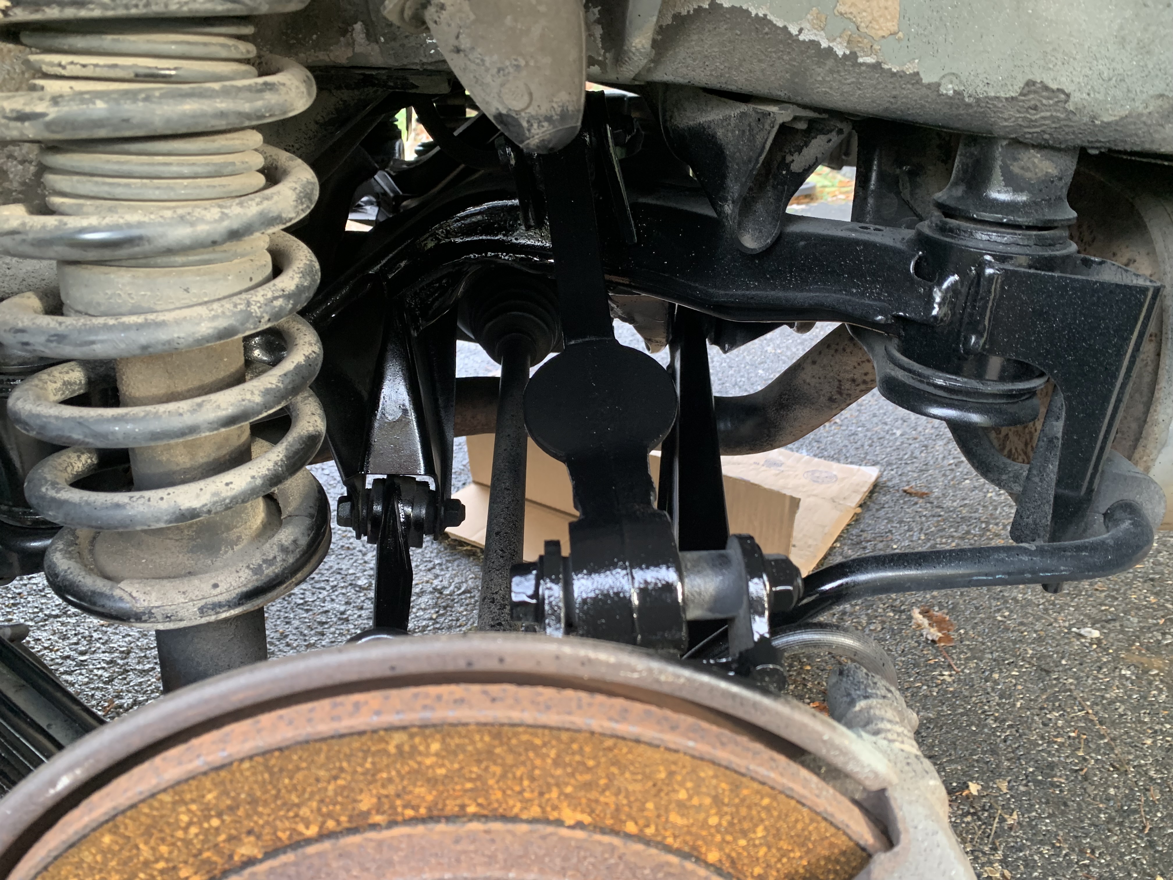

dease42
Posts: 36
Post by dease42 »

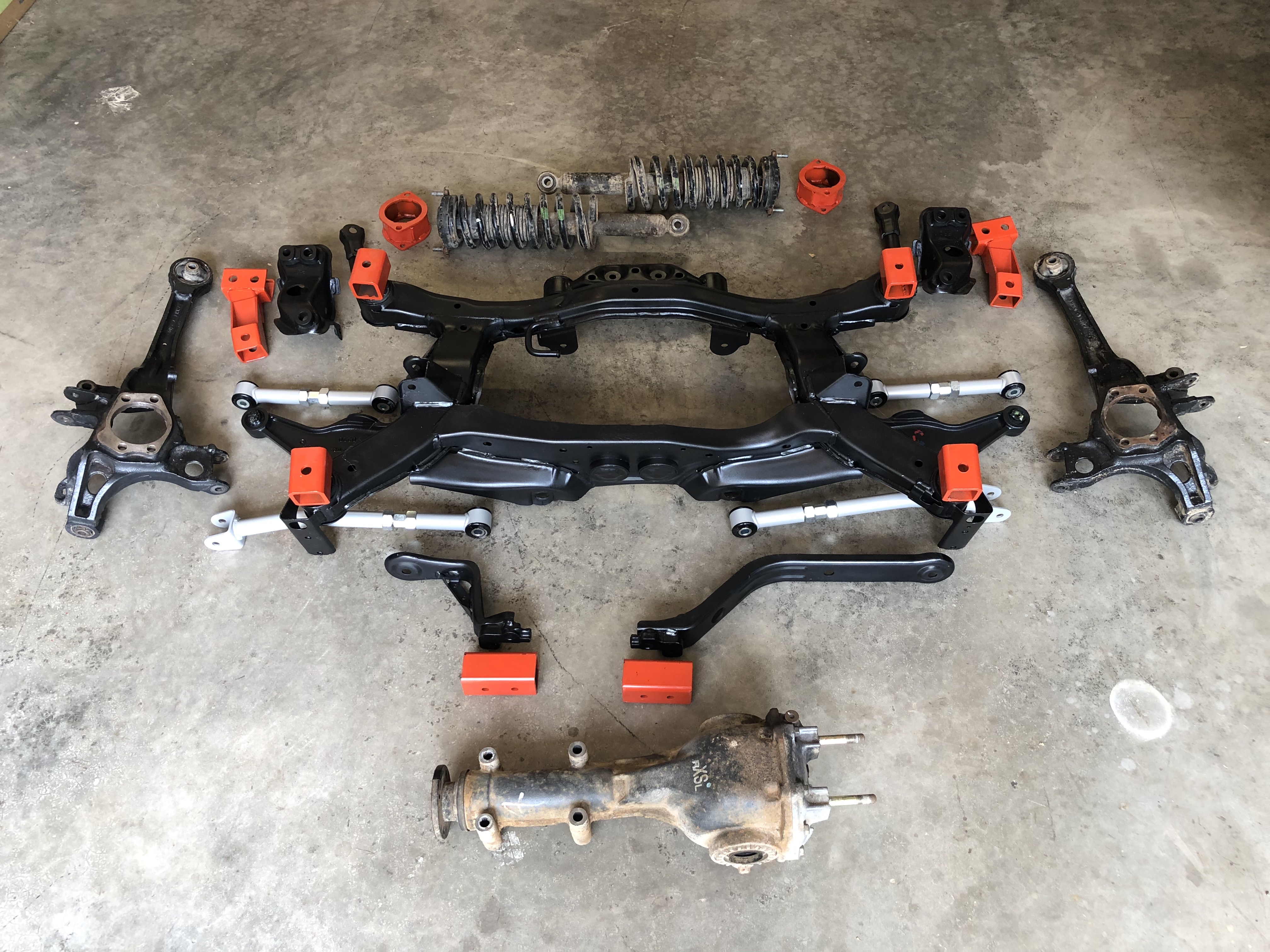

Been working on a suspension refresh - was installing a new lift when 2 of the rear subframe bolts snapped. We're months later, and I'm finally getting it back together. The delay gave me time to work on a couple other things and blast and repaint a lot of the underside.
Tasks in progress:
- Clean and repaint subframe, diff, brackets, arms and lift blocks.
- new rear adjustable arms
- Locking Center Differential mod with switch.
- Front / Rear Camera installation and wiring. (not shown)

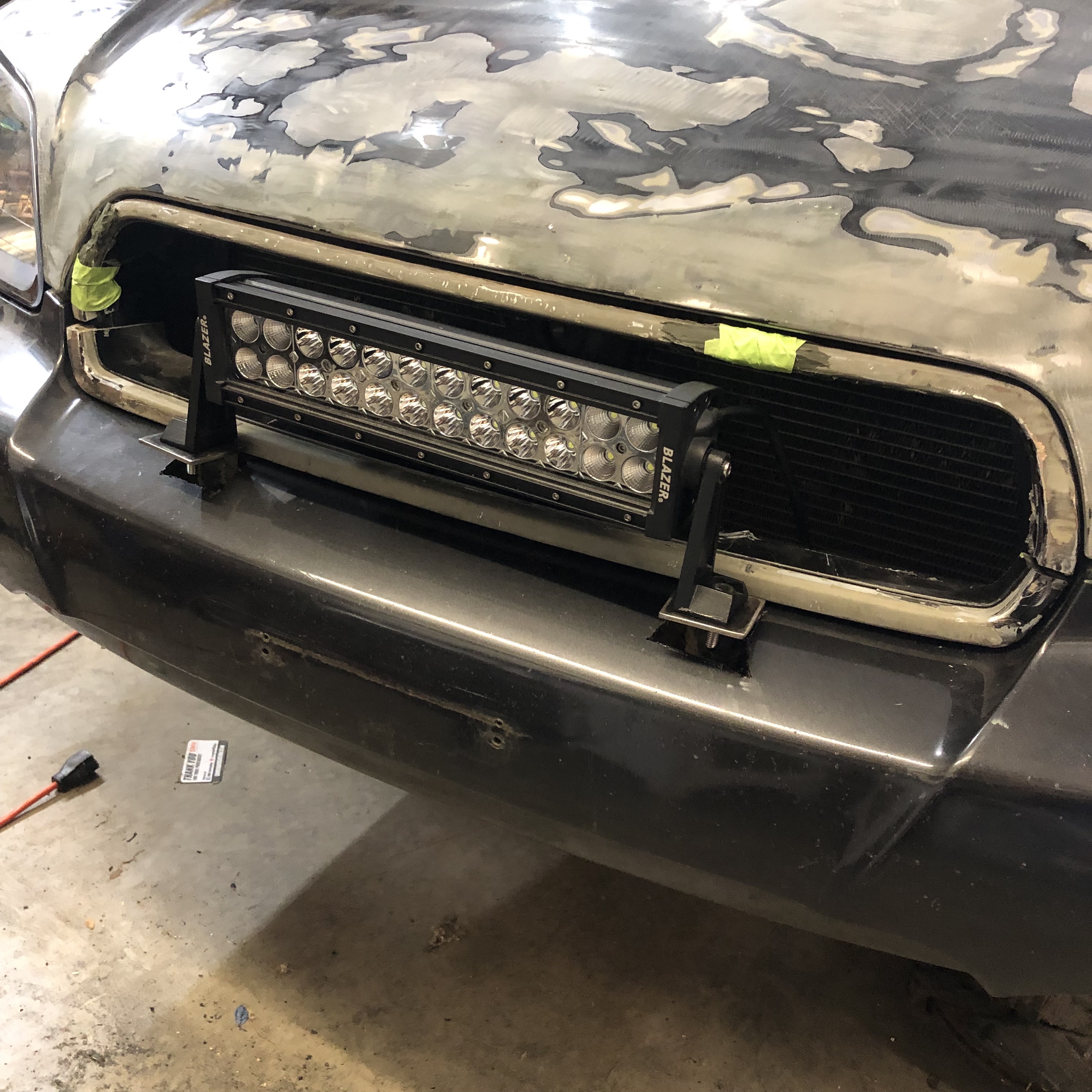

- Light bar custom mounted on bumper.
- Rust and dent repair on the hood. (This has been such a learning experience, but dude.. I am bad at this. Mad Props to the body folks).
- Custom grill (and no, it's not because I mis-measured the width of the light bar.. it was for safety's sake. Really...)
- Custom switch board in radio cubby.
dsmguy
Joined: Fri Oct 13, 2023 1:39 pm
Post by dsmguy »

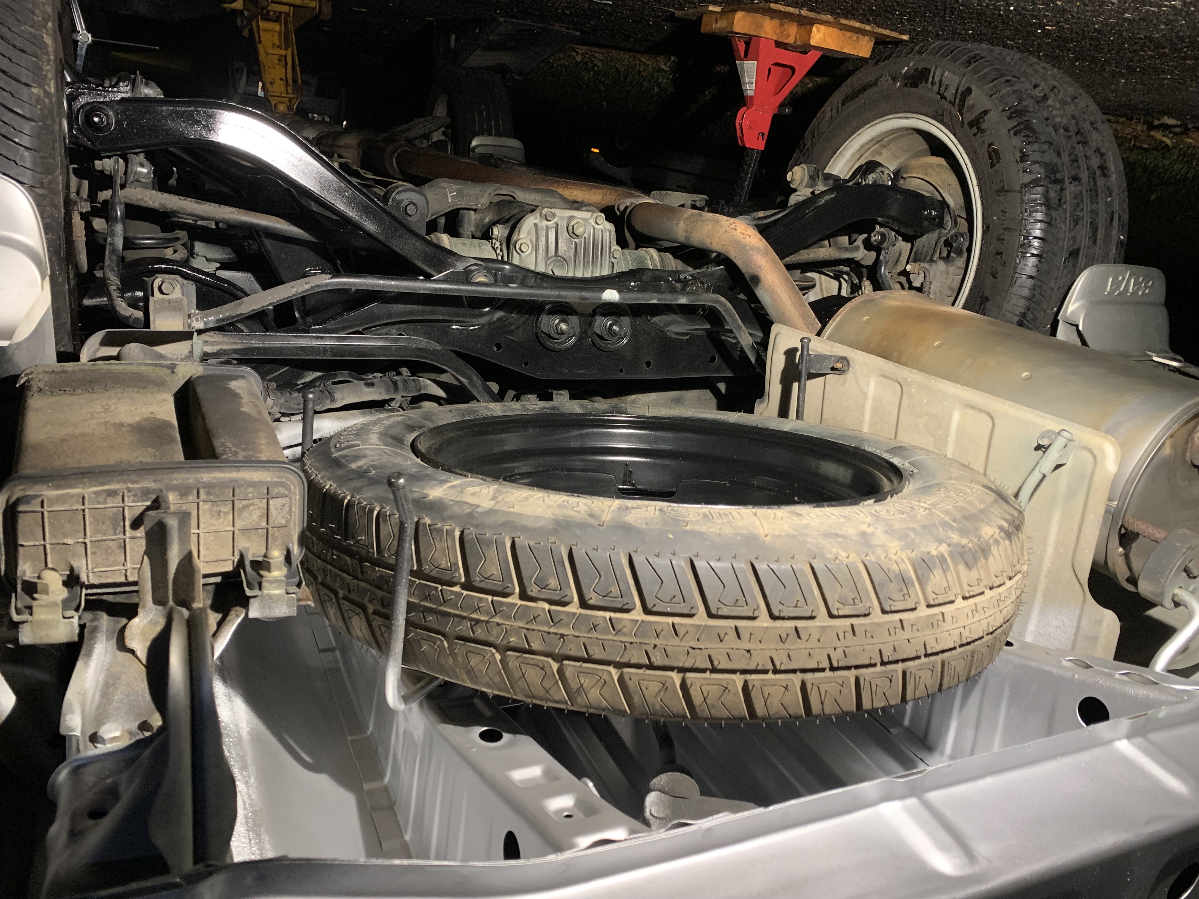

Wire brushed away any of the minimal surface corrosion from the underside of the Baja, then primed and painted everything including the spare tire for the heck of it. Hoping to keep this minimal-rust car on the road for years to come!

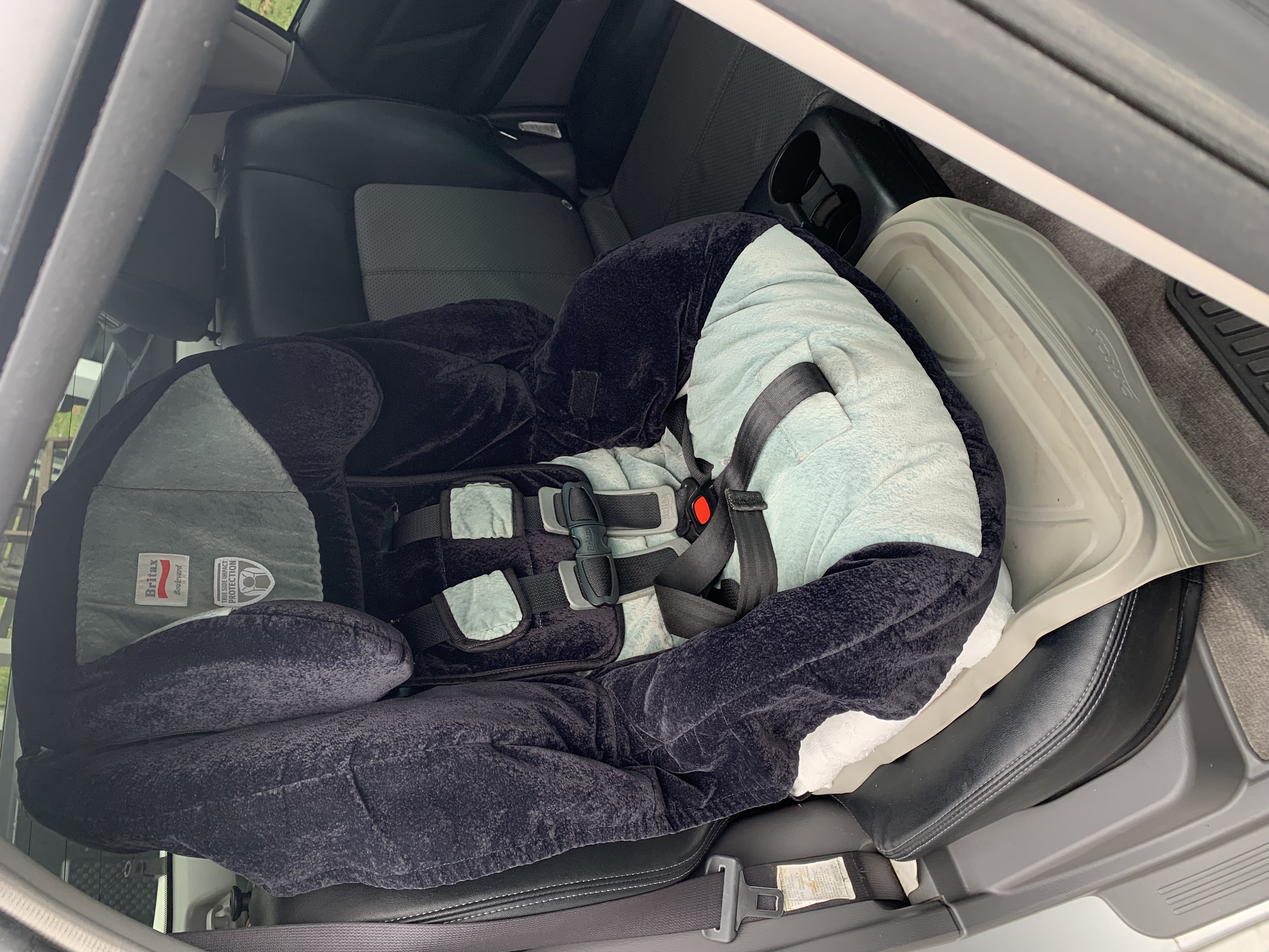

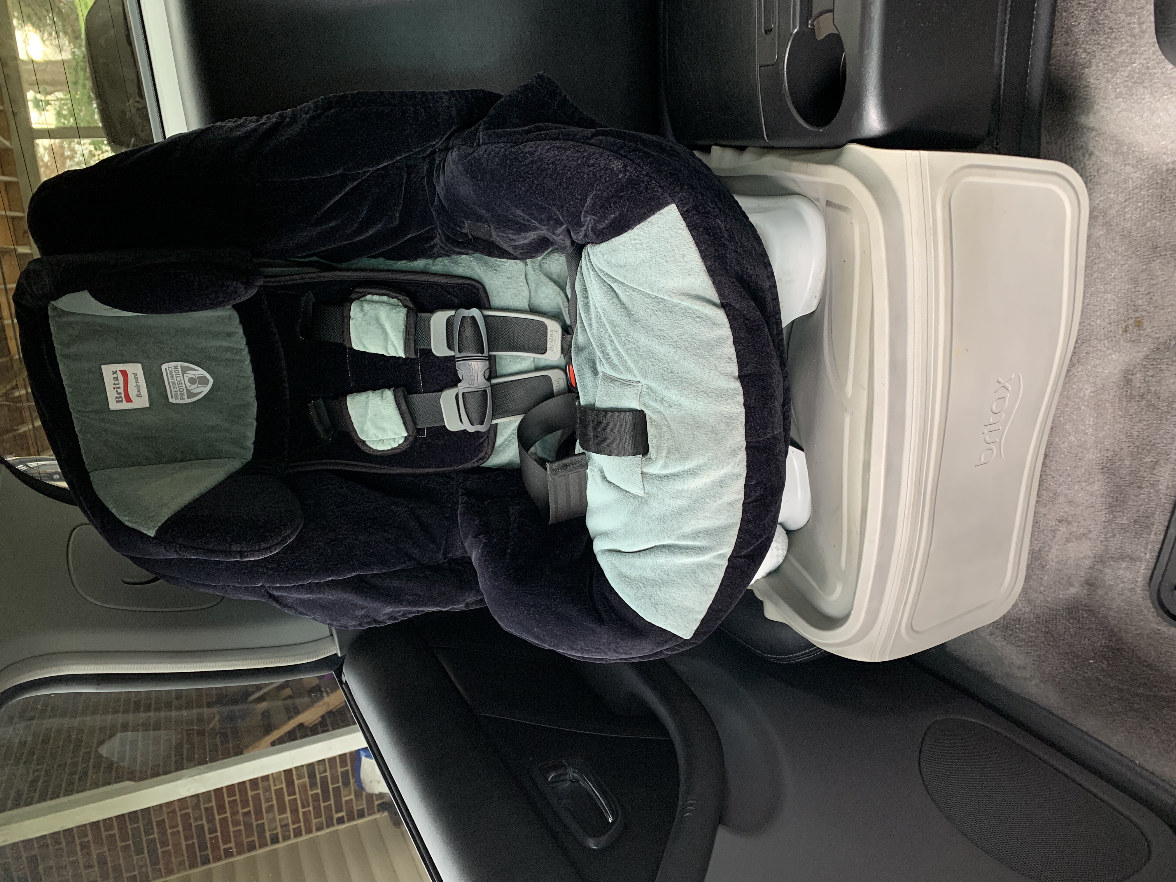

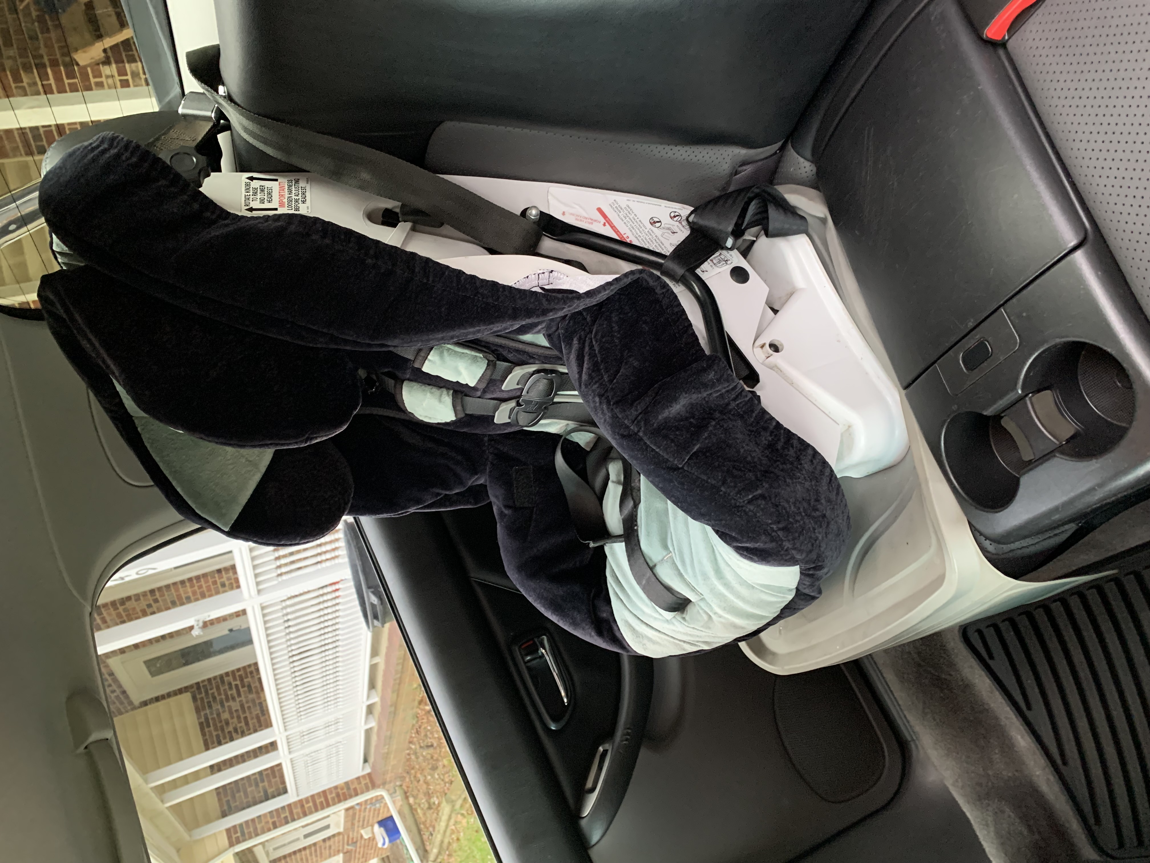

Yes, I know this makes me officially an old guy, but I took some joy in installing these child seat protector mats to minimize the leather seats from getting dimpled and rippled up from the kid seat. Only time will tell…

dsmguy wrote: Sat Dec 09, 2023 1:42 pm Yes, I know this makes me officially an old guy, but I took some joy in installing these child seat protector mats to minimize the leather seats from getting dimpled and rippled up from the kid seat. Only time will tell…
Is this only a base cushion protector? I’d be interested in a review after some use.
Yeah, this is only just to protect the base cushion from marks or crazy indentations from forming from the tightly strapped kid seat. No backrest protection. I like that they are a nice grippy rubber material and they don’t let the seat slide around like the fabric-based mats.
When I first started shopping for this, I saw that WeatherTech makes one, but it was $40+ $12ish shipping and I couldn’t see myself paying over $50 bucks for this, so I got this Britax brand mat used off FB Marketplace for like $12.
I’ll circle back in awhile after I put a few month’s use on them, and hopefully report that they did their job to protect the seat. We’ll see man
