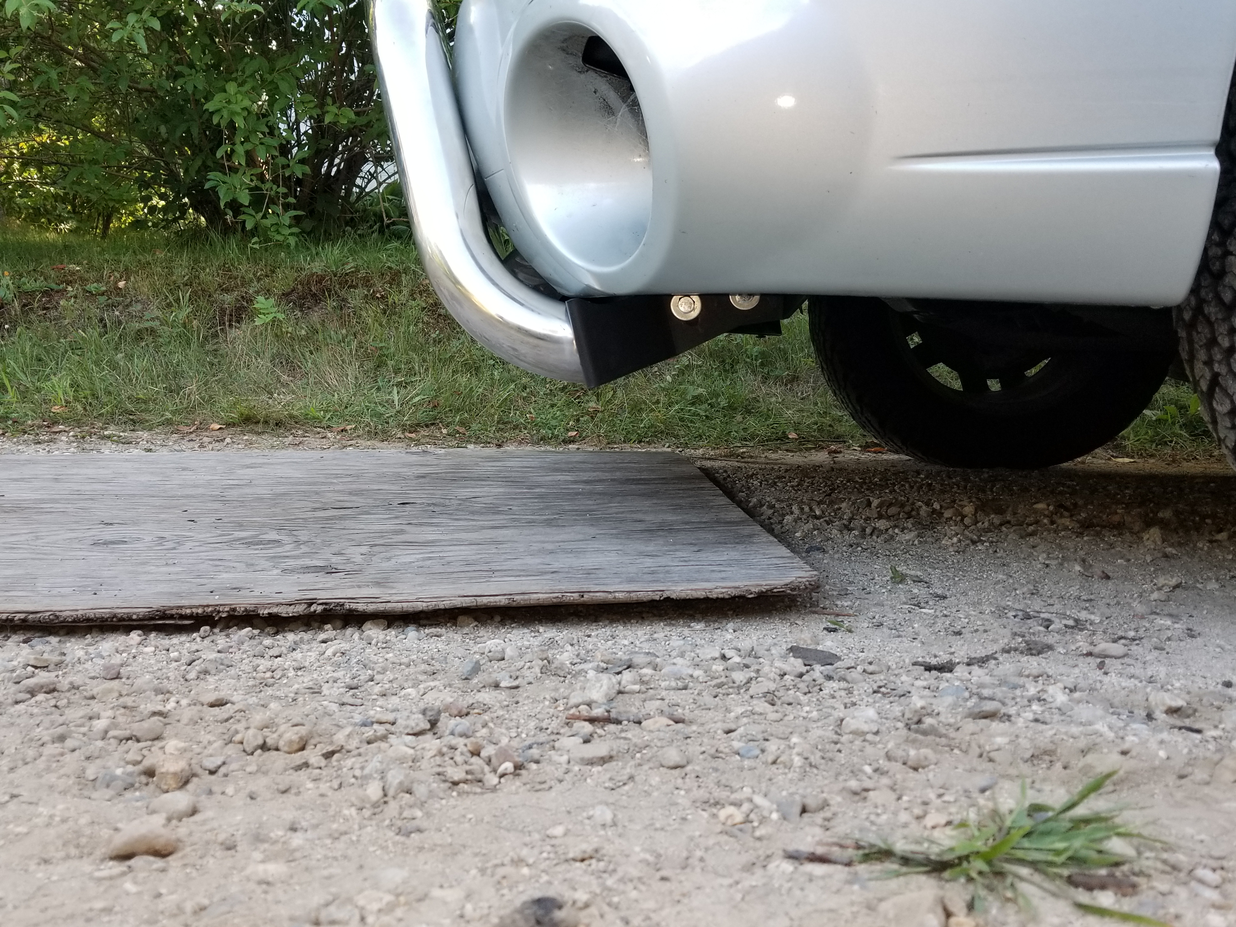

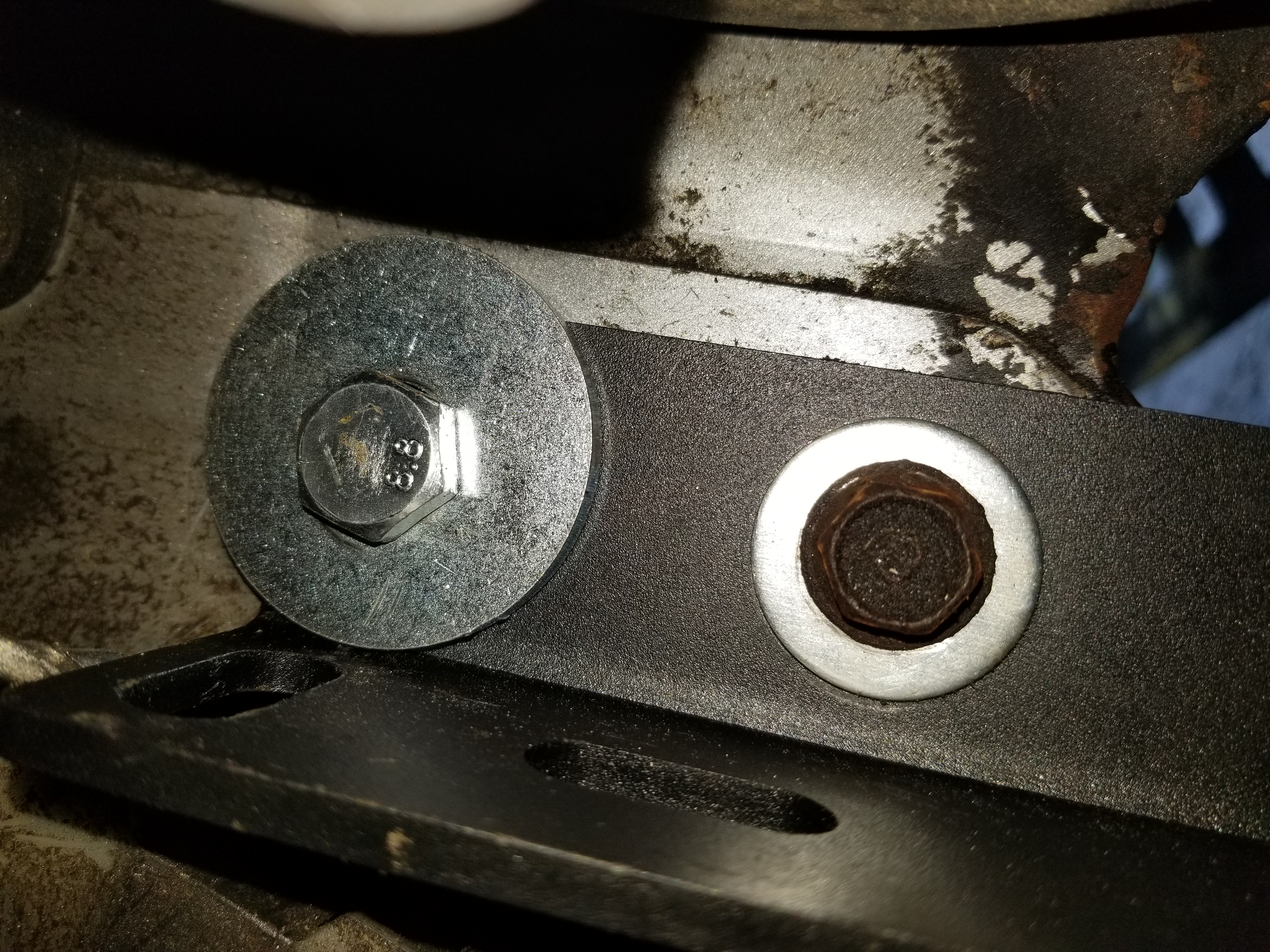

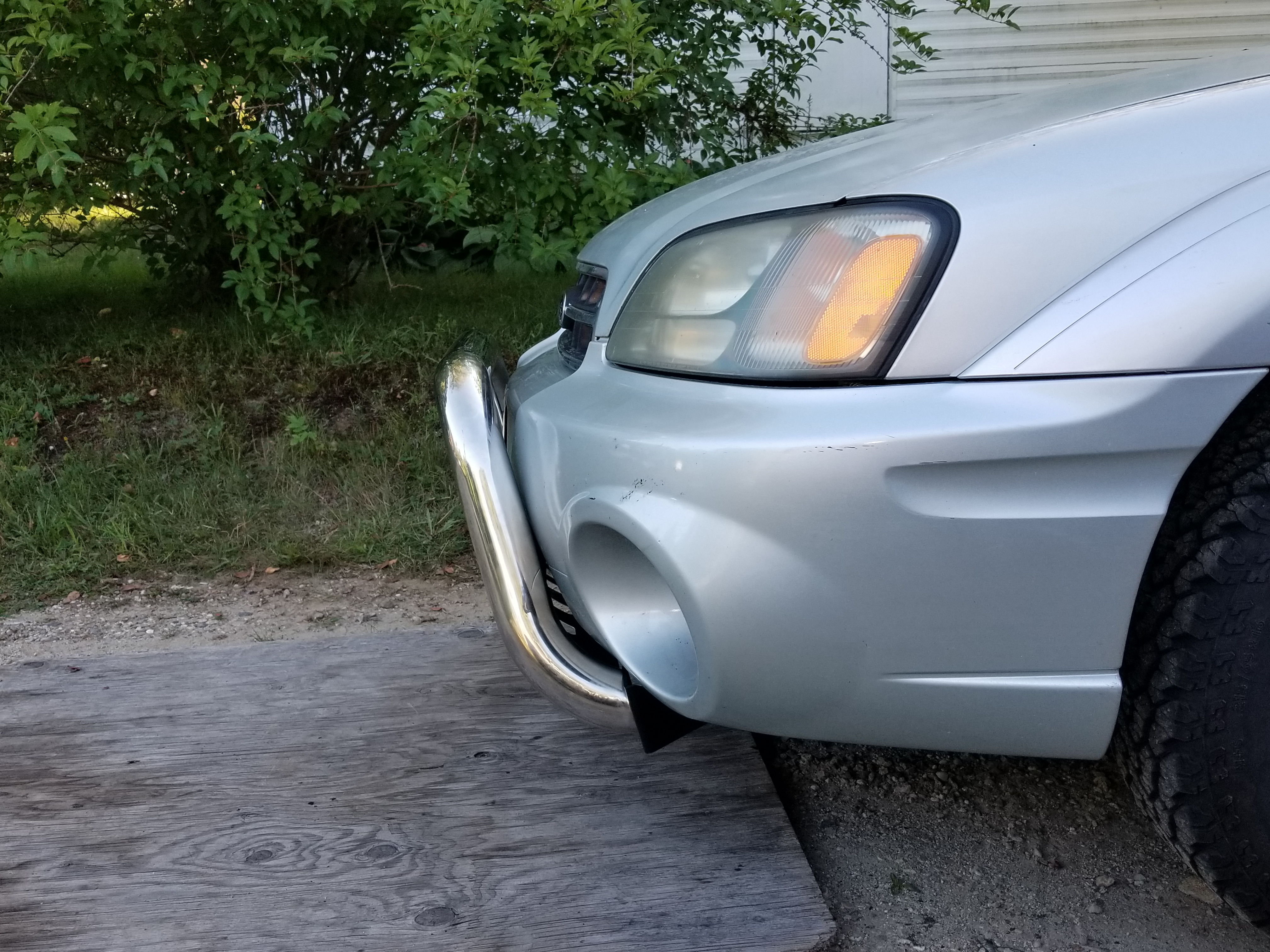

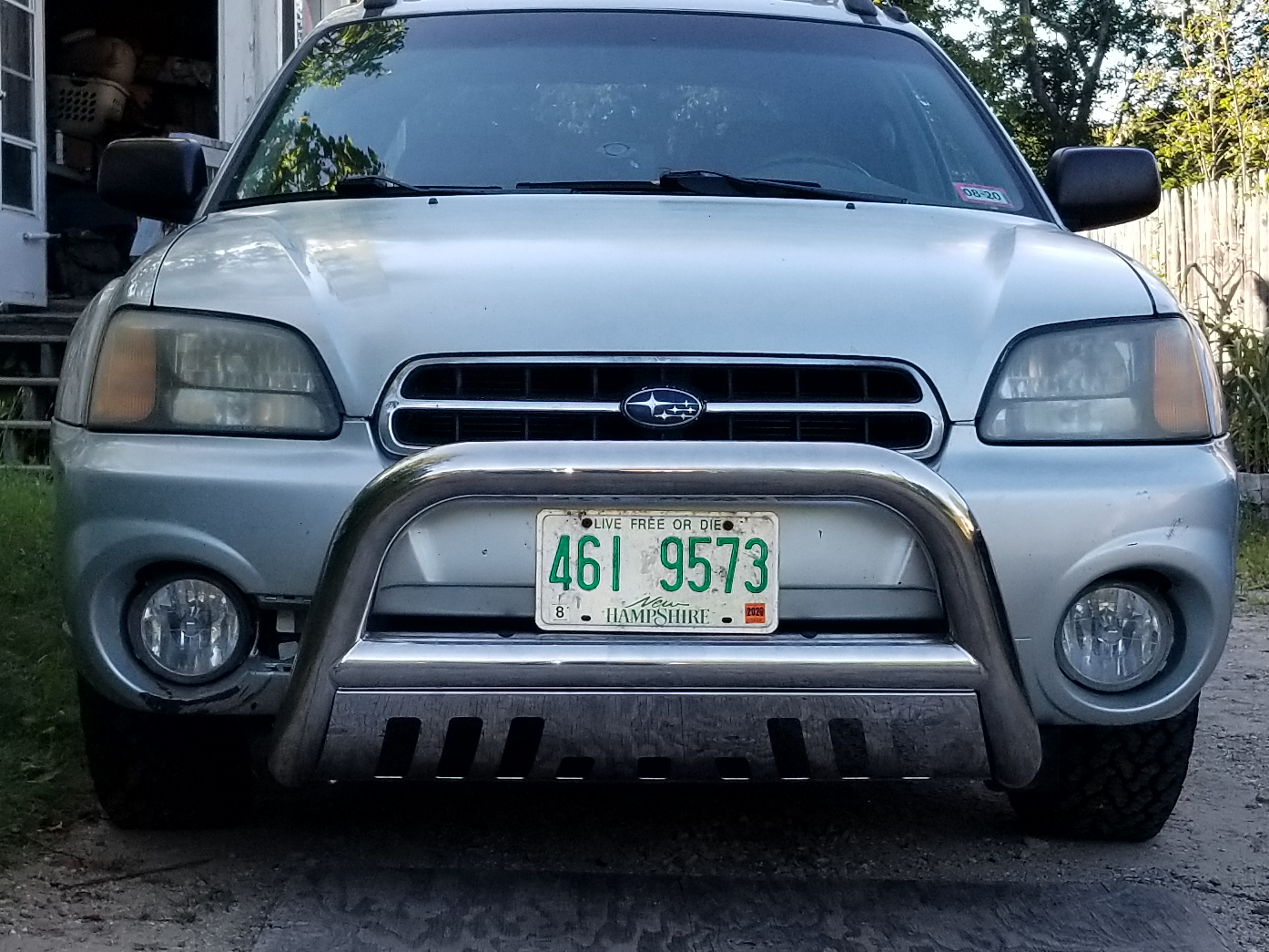

Well folks, it works!
Not a bad install.. (and apparently I got lucky with a black one). Line up the bracket using the open not-hole on the bumper and mark where the existing 14mm bolt is, then drill a hole in the bracket. I clamped the brackets together and drilled once to ensure the same location both sides. Then it's just a matter of fitting it together and tightening it all down. Since it's not a direct bolt on, there's a little give in the final placement.. even grunt-tight, but nothing more than a few centimeters.
The bar is nicely made (same Amazon link as above), not the thickest metal, but not bad for the price.
With the angle of the brackets, and the construction materials, I would call this more of an aesthetic mod than a true bull bar, I wouldn't use it to push much more than light brush. But, the brackets are sturdy, and I don't believe it would be fold back into the radiator without a fight.
I believe there's a possibility to use both existing bolts on the bumper, and have it straight out from the frame but you'd need to cut the bumper cover. I also think there's a real opportunity to use the sides of the brackets for a custom skid plate.. but that's for another day.
All in all, for the options available to us, this was a great find. Thanks for the info!!
Finished Product
It looks like the foglight cable is threaded through the hole.. it's not. This is with the new hole already drilled and in place.
from the other side
Hole Drilled
All bolted up. You can see the slightly downward angle on the brackets. Not the strongest setup..
Closeup of the bolts. Had to scavenge a couple of my own.
Side shots. I have a 1" lift on the car.

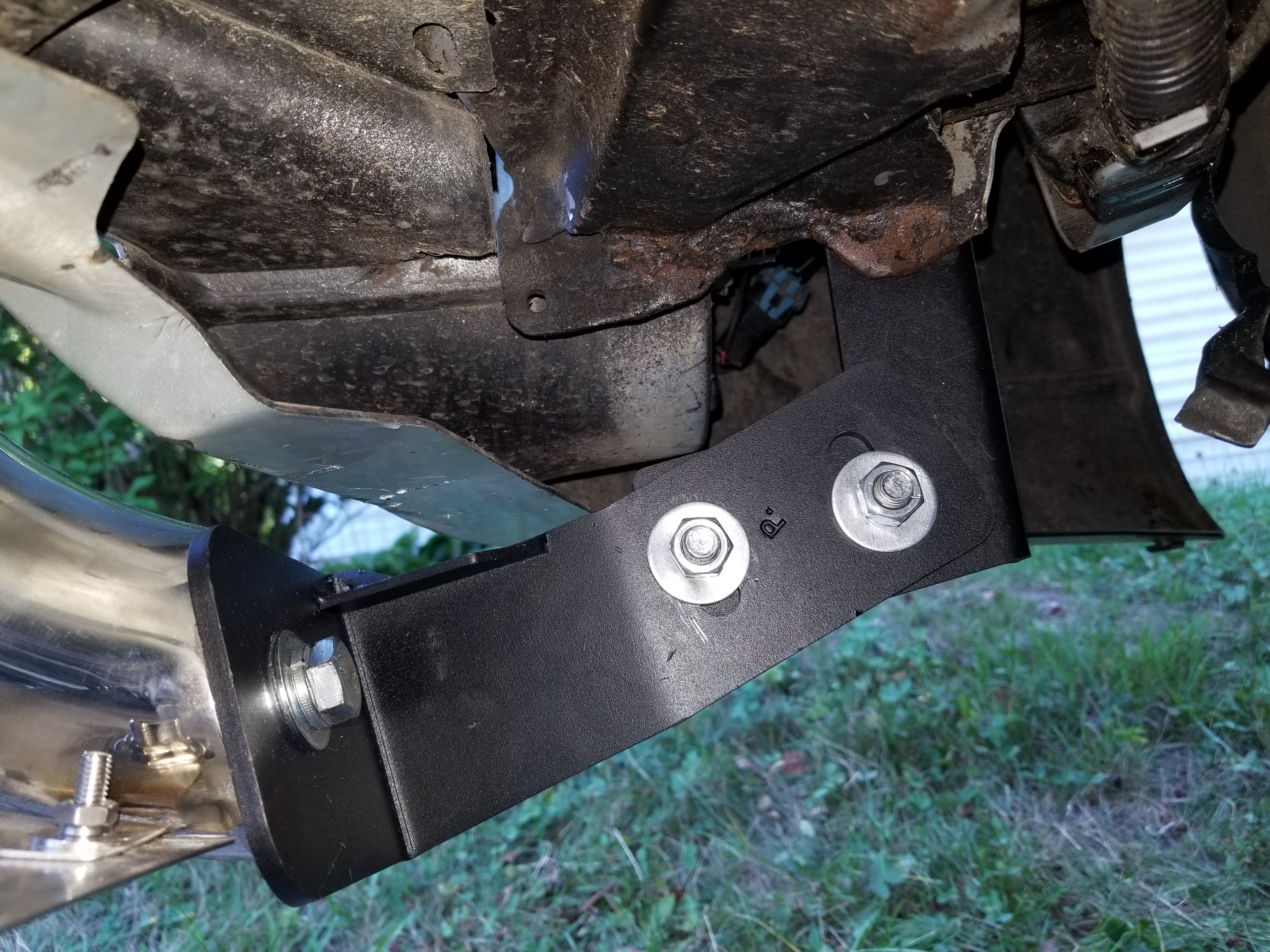

I installed mine also lol. My brackets look about the same but not where it attaches to the bar. I drilled 2 holes in the brackets to make a straighter angle.
- 20200820_174705.jpg (3.94 MiB) Viewed 33765 times
- 20200820_174656.jpg (3.87 MiB) Viewed 33765 times
- 20200820_174535.jpg (2.64 MiB) Viewed 33765 times

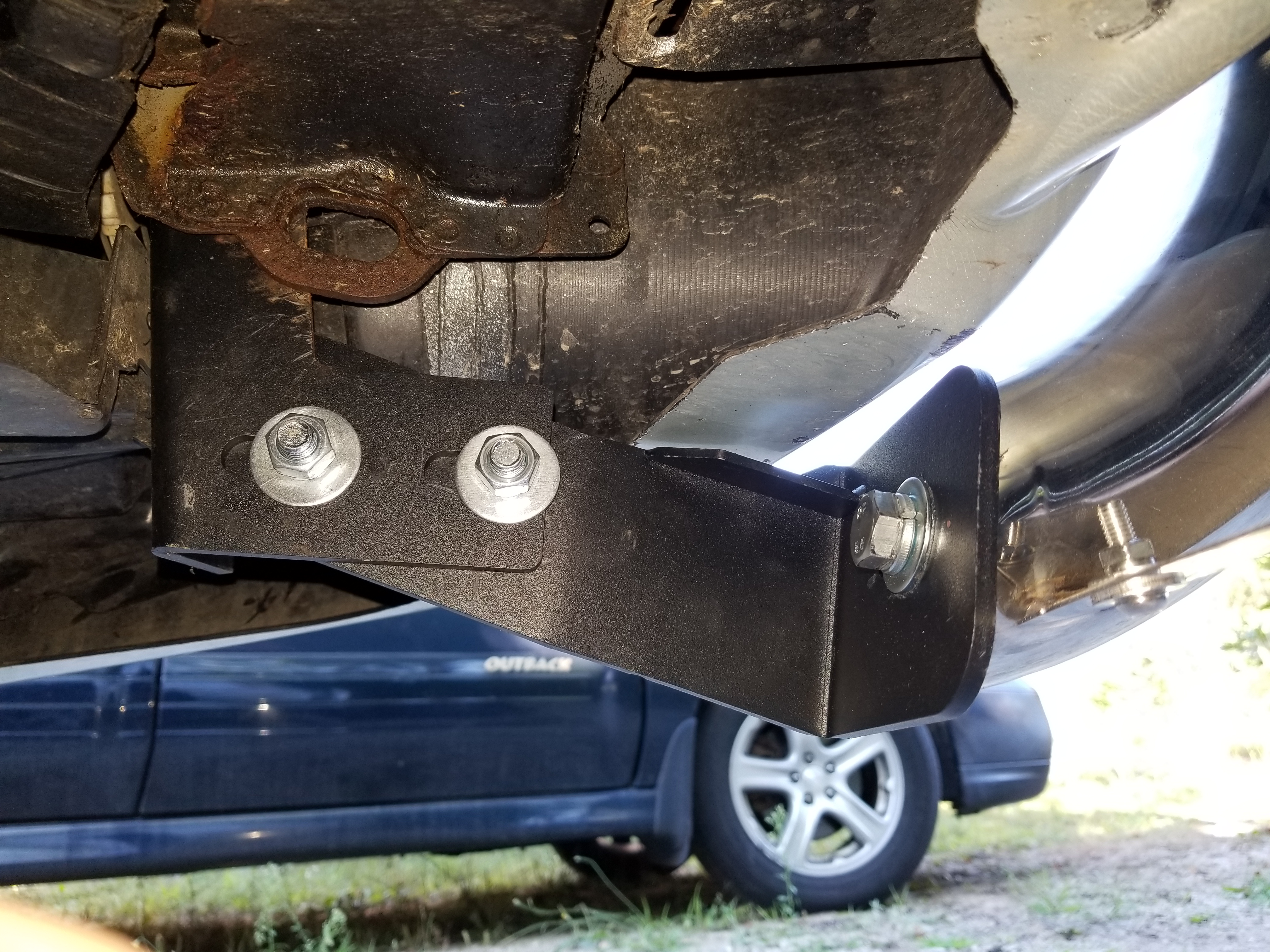

This is how i attached mine. The big bolt on the top of the side bracket was part of the kit and i drilled through the frame for a good solid mount.
- 20200820_174300.jpg (4.03 MiB) Viewed 33767 times
- 20200820_174312.jpg (4.84 MiB) Viewed 33767 times
- 20200820_174328.jpg (5.71 MiB) Viewed 33767 times
Re: Pushbar and side bar options
Very cool!!
Originally I had assumed the hole would be through the frame, and was very happy to only have to drill the bracket.. but yeah, that looks way stronger.
Nicely done!
