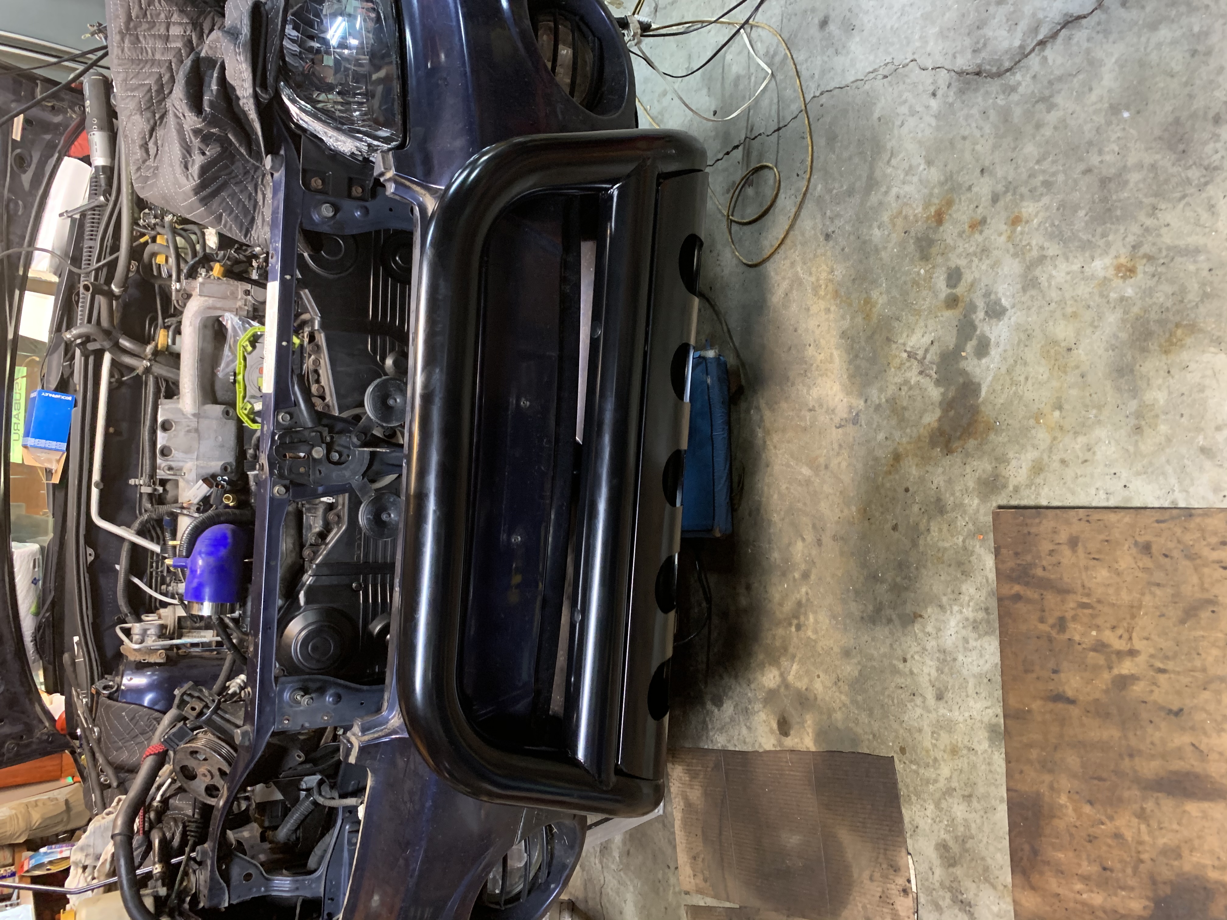

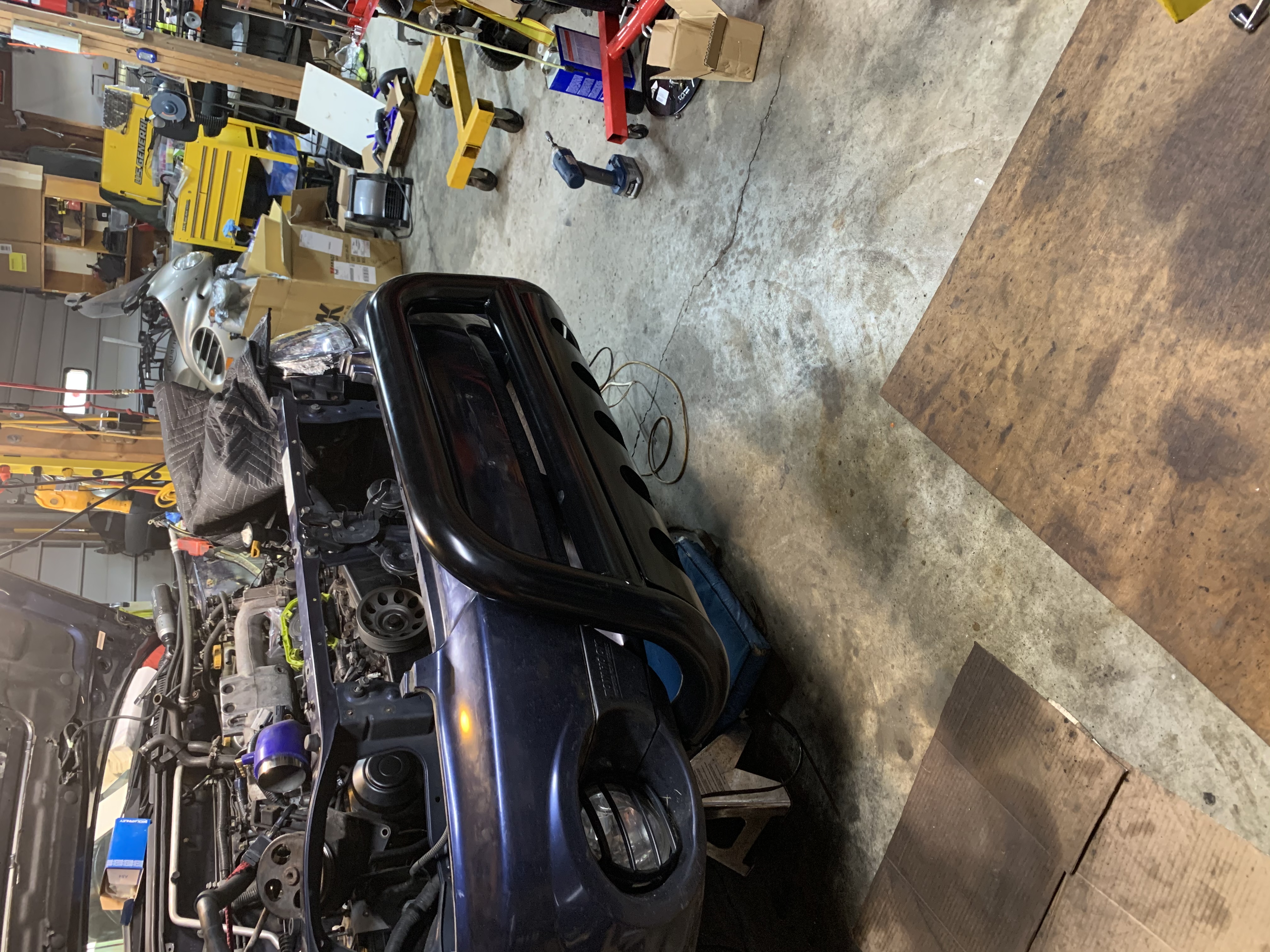

Amazon has this Tacoma bull bar
https://www.amazon.com/dp/B01LZ8XIX6/re ... AFb4A447TV
for $97 so I ordered one for my 2005 Baja. I mounted it yesterday. It feels solid and looks great to me.
I hope to fab a skid plate and mount a winch if possible as well.

Looks great! (out of stock at $141 now). And the mounting points already on the bar would work with the two solid holes I identified! Which mounting points - and how many - did you use?
Re: Pushbar and side bar options
Attaching the bracket to the car I used one bolt on each side. I was thinking I’d have to drill for a second bolt on each side but after mounting it to see how things fit, the brackets pivot and lean up against the bumper frame and can’t pivot further. So one bolt per side was sufficient. Then there are two bolts per side mounting the bull bar to the brackets. It feels very sturdy to me.
BTW, I got it for $97 tho I see it is now $141 and not in stock. It is likely all Tacoma bull bars will fit like this one.
This addition is only one item of many I’m doing right now including a 2 inch lift. I will post pics when all is done.
