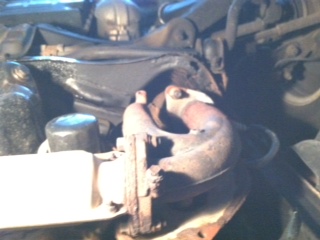

I took my Scooby to a dealer/servicer in Brooklyn for a once over and was alarmed when they told me all the problems they claim must be fixed before I drive to Norfolk, VA (my new home). I suspect they over exaggerated, but I'm not schooled on the mechanics of the vehicle and hope to get some help from this fine group. Here are the issues they say need to be fixed/replaced along with their estimates for the parts/labor in USD$:
1) new Engine Cross Member due to wear on passenger side -- 399 / 245
2) replace Tie Rod End (front passenger side) -- 243 / 196
3) replace all 4 Struts -- 559 / 392
4) Rear Suspension Trailing Links & Bushings -- 402 / 392 (more if difficult to remove)
5) Turbo Leak -- 315
6) Alignment -- 100
From my perspective, I wanted a Baja and of course I realized a used car will have issues. I didn't expect > 3K of issues however. I discussed with seller and he thinks dealer/servicer is just executing on their business model. I saw the Cross Member degeneration while it was up on the rack and did notice a slight knocking when steering wheel is at far end of radius and so feel anxious about that specific issue, but the seller thinks it's ridiculous. He agreed to look at it and do any needed welding to strengthen it. I think the turbo leak is an unfounded claim. All the other issues…I have no idea if they need to be done immediately or over the course of say the next year. The car drives nicely, and I am already infatuated. I don't want to lay out any more money than is absolutely necessary right now unless it's clear that doing all this work now will help me keep Scooby healthy & happy for years to come. Obviously, my safety is of utmost concern so any and all replies about the cross member issue and tie rod end are particularly welcome and the sooner the better.

It's hard to say without seeing the Baja, but from the sounds of it I would stay FAR away from the dealer. Unless the car was abused and driven through salt puddles and never washed, I doubt it is as bad as they say. The struts I can believe if they are original. The turbo leak can happen at any time. Possibly the tie rod?? but that price seems like they are replacing all 4 ends, not just the bad one?
What is the "Crossmember Degeneration"?? Other than in the case of an accident, I have never seen a bad Subaru crossmember?

When mechanic at dealer walked me through the issues, he suggested the crossmember was not structurally sound and could give way if i drove over a large enough bump (seller's retort to that statement was "you'd have to drive into an elephant at high speed" to bust the crossmember). Mechanic at dealer also said that since it holds the engine in place I should definitely have it fixed immediately and that the instability of the crossmember could lead to failure of the tie rod end on the passenger side. Made me nervous! I am taking it to another mechanic today for a 2nd opinion. Will try to get a decent pic to add to this thread.

I am a certified mechanic, that being said my best advice with out seeing it myself would be to bring it somewhere else and get another opinion from a reputable mechanic. Sounds like some smoke blowing going on. Some of those issues could be legitimate problems, but I'm not liking the story already. And please post a pic of this cross member.

Appreciate all the input so far. Here's a pic of the crossmember degeneration (my term, so blame me rather than the mechanic). ![666 [smilie=666.gif]](./images/smilies/666.gif)

Here's where things stand today. 2nd mechanic also says crossmember needs to be replaced and also the Tie Rod End on passenger side, but they saw no Turbo leak and thought all the struts probably should be replaced, but not imminently. Only thing they added to the mix was that the coolant hose needs to be replaced.
Seller is big believer in the power of welding and has told me that although he is willing to replace the crossmember free of labor charges, he thinks welding metal around the existing crossmember will 1) create an even stronger structure, and 2) cost me a whole lot less money since he only expects me to pay for the right metal to use for the job.

Re: This new Scooby owner needs your advice
Scooby-ites,
Any opinions out there about welding a crossmember instead of replacing it? Could welding be a reasonable alternative, or is there no way around replacing that crossmember?

This has been stated, but did you tell the 2nd repair shop what to look at, or just ask to give it a once-over?
Also, that tight wheel turn knocking could also be the center diff. Thrr is another post just below yours about it. Good luck and go for a third opinion.

2nd mechanic did get leading info since he's had a long term repair relationship w/my pal's Volvo.
So I took Scooby back to seller today who claims the welding will be adequate. He's gonna replace the tie rod and coolant hose and will do the best possible alignment he can and will try to get OEM parts as cheaply as possible. His resolution seems reasonable to me so I will hope and chant for the best.
