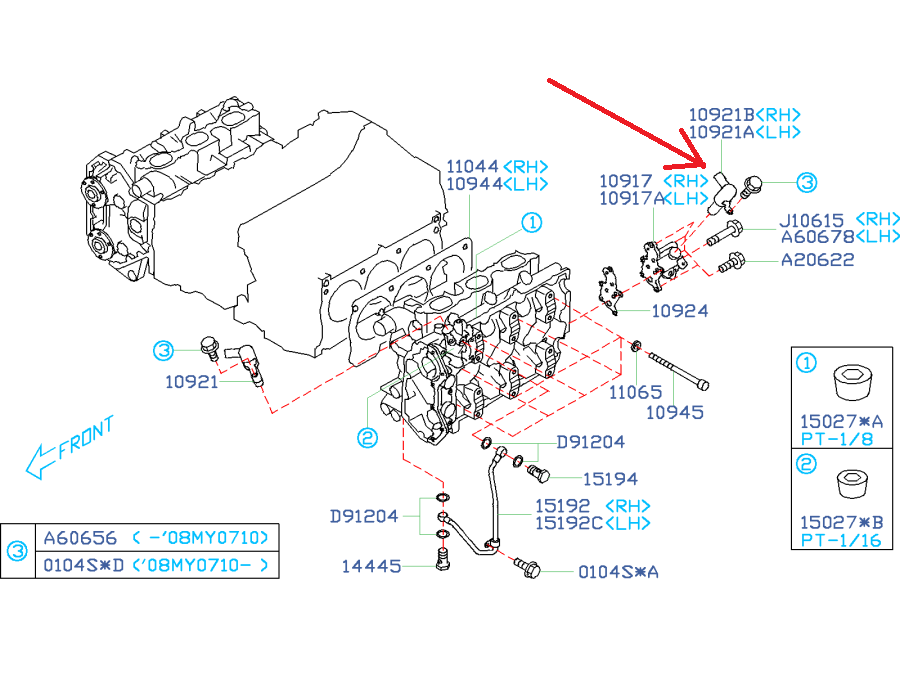

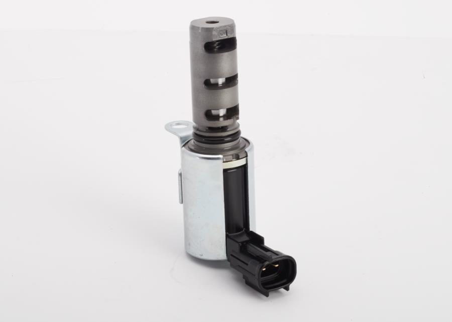

Maybe OSV is "Oil Solenoid Valve"? At least, based on a quick search.
Seems like it looks something like this:
10921AA040 4.jpg (15.34 KiB) Viewed 11281 times
(http://parts.subaru.com/p/Subaru__/VALV ... AA040.html)
And goes here:
(http://parts.subaru.com/showAssembly.as ... ly=6023324)

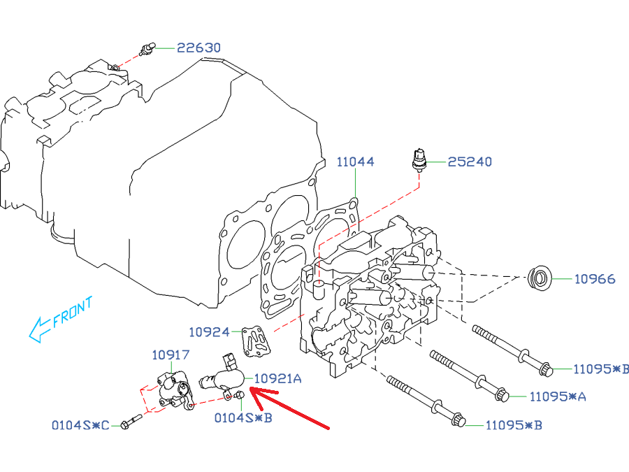

Four-cylinder models also have one for each side, it seems.
(http://parts.subaru.com/showAssembly.as ... ly=6023309)
