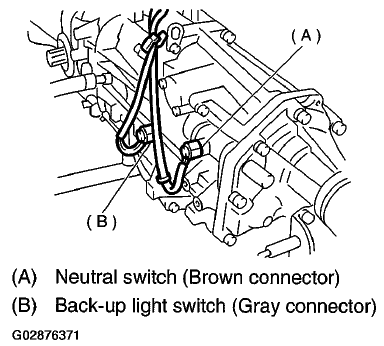

My check engine light came on this morning and the Auto Zone tech said it's "neutral switch input low." Might be a loose, short, or open circuit, a failed neutral switch, or a poor electrical connection. Hey; it's a 5-speed manual. I thought only AT's had a neutral safety switch. Where might such a switch be located on a MT?
Re: Trouble code P0851
So, it looks like the MT has a Neutral Position Switch (whereas the AT has a Park/Neutral Position Switch). Diagram attached of what I think is for the 5MT.

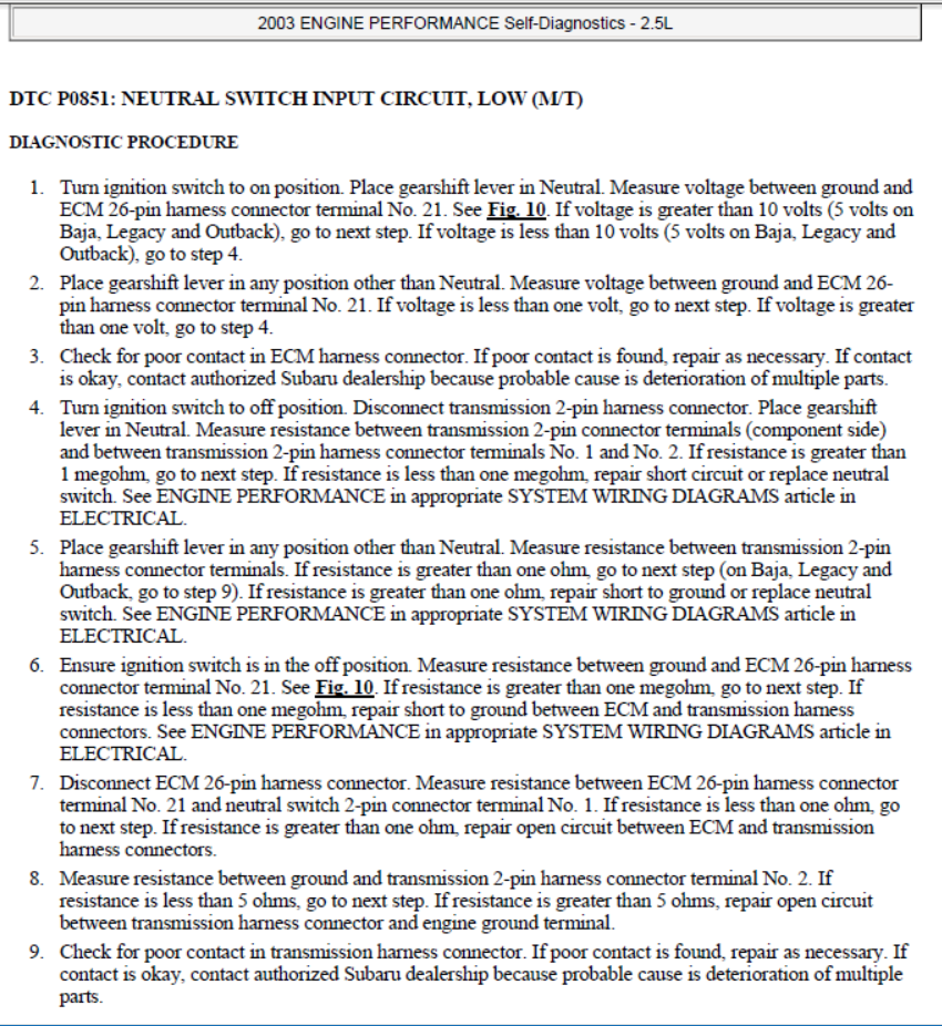

I'll see if I can find the diag procedure for it. I remember that Part Source (and possibly AutoZone) used to print diagrams and instructions from some mechanic's software a while back. Do they still do that?
Diag procedure for MT.
