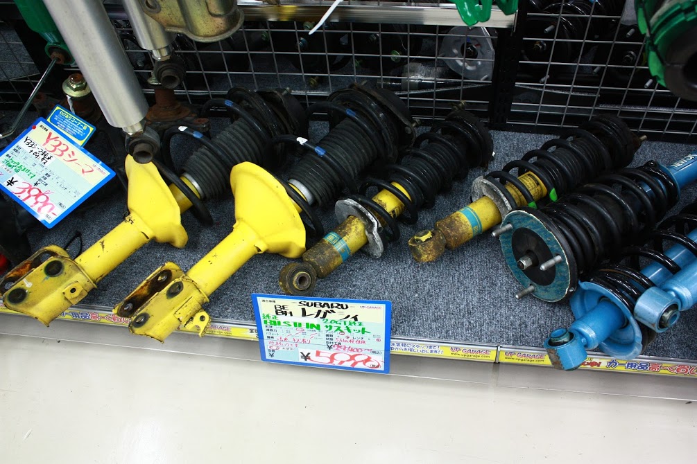

Picked up some used Bilstein shock/spring/mount assemblies from a Legacy GT as a souvenir from Japan about a month ago for $55USD, and finally got some time to start installing them yesterday. Only had time to do the fronts, because I found the inner CV boot finally cracked open, so the time I would have spent on the rears was spent doing that... oh well, it was something that needed to be done, anyway.

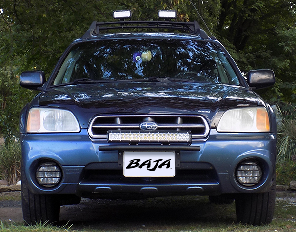

First of 3 light bars installed! [smilie=666.gif]
Other two installed!
Special thanks to Bajaguy for tips & info!

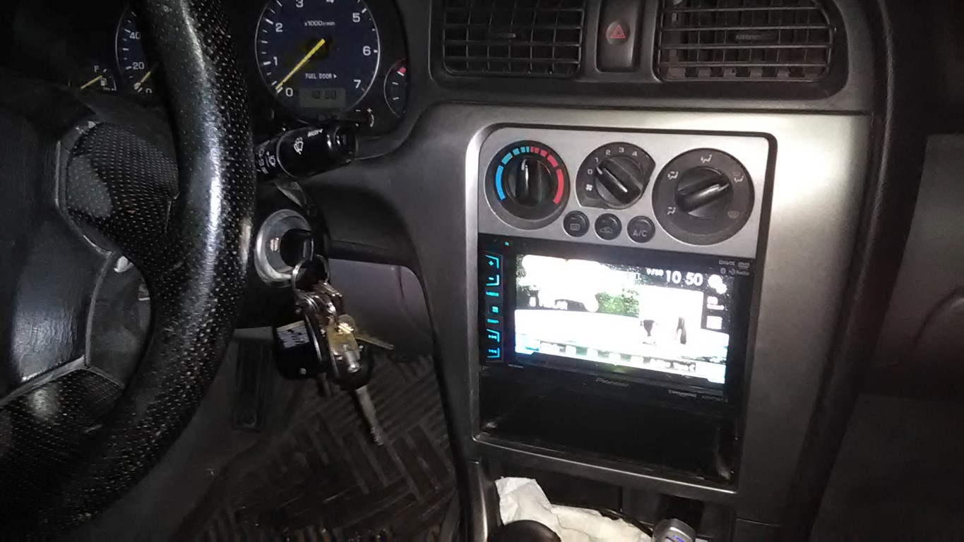

Had a lovely day at the junkyard, got a bunch of replacement bits for my Baja, have been working all evening plunking everything in. Replaced the rear driver-side speaker, got all three climate control illumination lights working again, even found a (mostly) complete set of interior black plastic trim from a Legacy, which I'm trying out now to see how they look. Will probably swing by tomorrow to see if I can find the last bits of trim I need for a full black interior and maybe some more spare bulbs. Might even have time before sleeping tonight to finally fix the bed cover. Here's a crap cellphone pic of the interior stack now: Image

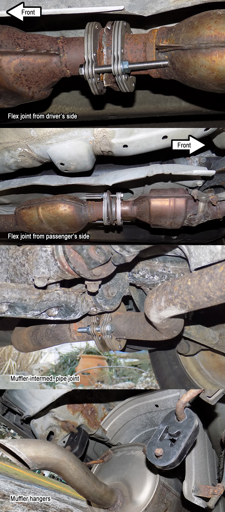

Well, this happened.
Took me 2 hours to pry off everything behind the cat. Sadly I couldn't get anything bigger than a hacksaw blade under there, & I actually had to cut the hangers off on the muffler. Amazing how the pipes are perfectly fine, but the flanges & bolts are completely shot.
$2,600 for a brand-new Baja exhaust, $1,121 for a brand-new Gen-3 Legacy exhaust. Gonna see if my used parts guy can find a replacement from a Legacy.
Image THANKS MARYLAND SHA
https://www.youtube.com/watch?v=AQggo3AfP30
EDIT: Driving to my parts guy today I spotted 3 other lost exhaust parts on the side of the road. I swear SHA uses road salt like Old Bay.

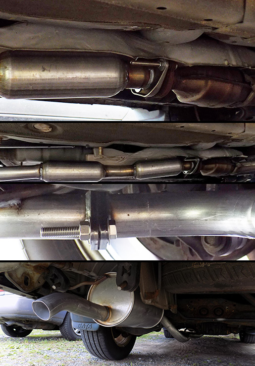

Well, after 5 hours in the cold I got the exhaust fixed. The original bolts were toast but the flanges were still good... sort of. So I just braced them with two more flanges and longer bolts each. Had to saw off the rubber hangers in order to pull the exhaust, so I got beefier ones. As a result, the muffler hangs about an inch lower than stock. Overall the fix was around $100.

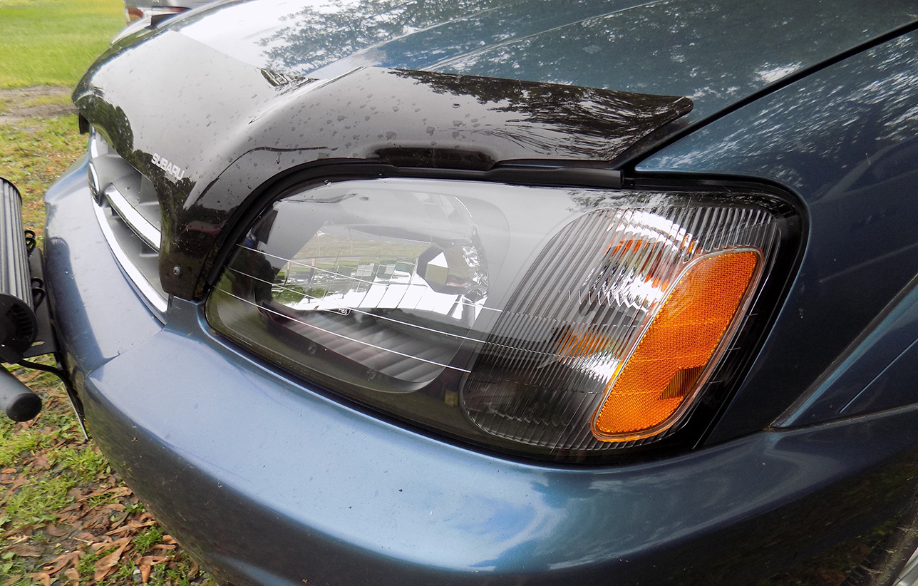

Finally caught a break in the rain to put in the new headlight housings!

Installed a new catback exhaust. Originally went with a Walker midpipe and Bosal muffler, but the Walker pipe arrived full of unfinished welds with 1/2in holes. So now it's a full Bosal catback.
My baja is so quiet now!!!
Manifold still leaks but it's nowhere near as bad as the flex joint leak was. Now we'll just have to wait and see if it makes it through a salty MD winter.
