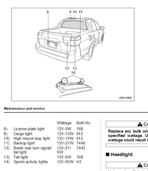

I'm not familiar with lighting & wiring on cars, but regarding the rear lights, all of the three lights function as brake lights. There is also a set of bed illumination lights (cargo lights) mounted beside the third top light that was baja-exclusive. Here's the light diagram from the owner's manual, maybe this will shed some light (no pun intended) on the part?
Just in case, here's also a link to the '06 owner's manual on file here. Note that only the 03 Classic and 04-06 Turbo (identified as "Baja-B") models only featured the 4-beam headlights. Also note that Sport Activity Lights are an optional add on.
http://www.scoobytruck.com/pdf/2006_baj ... manual.pdf
Lighting starts on page 11-63
