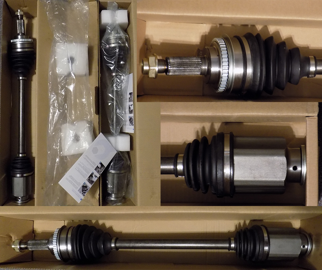

Well the 1A axles came today and WOW these things are beefy. Will have them installed next week.

They sure look beefy, Guacamole, please let me know they work out once you get them in, is your Baja Sport or turbo?
Re: 2006 Baja Sport
flyboyaviator wrote: Sun Oct 28, 2018 10:40 am is your Baja Sport or turbo?
Standard sport like yours.
