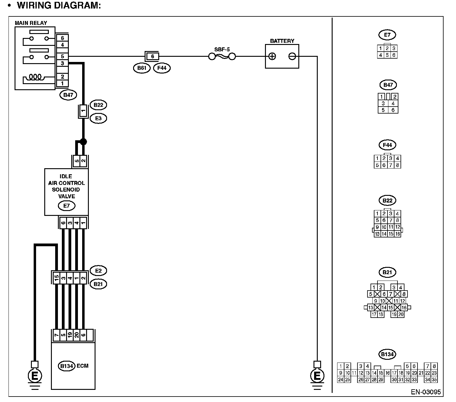

Assuming N/A here.
Past that, you might check the main relay is functioning properly, that all pins in the connector are fully seated, that the wires are not broken from the solenoid valve to main relay or the ECU.
If all else checks out, it could be the ECU.
