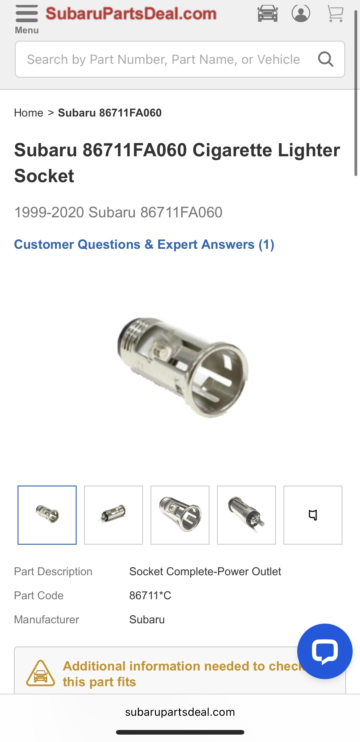

I was finally able to get my hands on a multimeter and it looks like the outlet is in fact getting power so I'm guessing there is something wrong with the outlet itself. I feel pretty confident replacing the thing if that's what needs to be done, but am not sure where to get one! The quest continues
20Baja06
Posts: 95
Re: 12v outlet mystery
Post by 20Baja06 »
Straight from Subaru looks to be a good bet.
TooManyRaccoons
Posts: 15
Joined: Fri Dec 22, 2023 9:36 am
Post by TooManyRaccoons »
Thanks for the link! Got the part last night and installed it this morning. Easy enough aside from the vertical screws behind the ashtray lol. Thanks for the help folks, glad to have my Baja back in top shape
