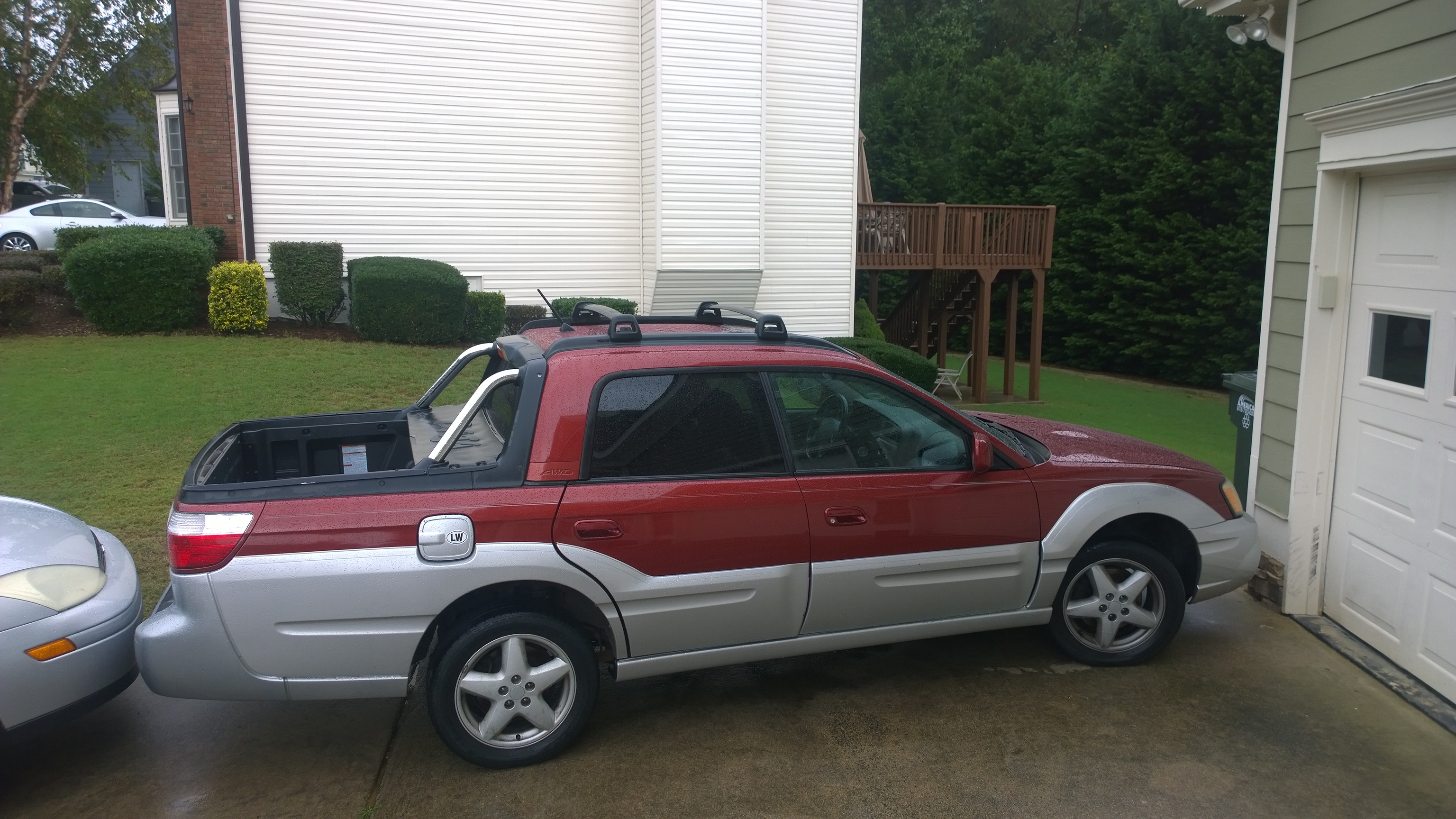

Like you, I just recently purchased my first Subaru. A used 04 Baja turbo, Auto, with 135K miles. The previous owner had done the "big" service that included the head gaskets, timing belt, water pump (the one most owners apparently do at 100-120K miles). He also addressed turbo issues at that time and had the banjo-bolt filter removed. If you are considering a turbo vs non-turbo then I will say this: the Boxer motor needs the 100K service done (timing belt, water pump) with EITHER motor (I think) so it's a big expense to break down the motor and get that done. If both of your potential Bajas have had this service done, then that's a big plus. If only one of them has, then that one is probably the better buy.
The biggest plus about the turbo is the torque (approx. 230lb-ft, I think) and my Baja just feels fast. The downside is twofold...mileage is quite a bit less- 19mpg for the turbo, more like 23+ for the Sport (city)...AND remember, the Turbo engine requires PREMIUM fuel, the Sport does not!
Good luck in your search...a well cared for Baja (like mine) is just a blast to own.
- WP_20141003_10_17_19_Pro.jpg (1.63 MiB) Viewed 8726 times

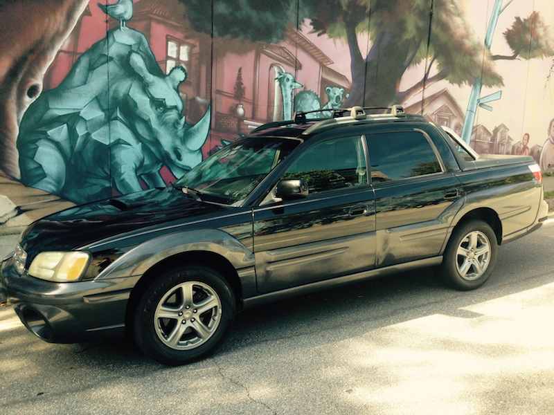

Well, as promised, here is my new Baja!
Loving it, 2005 Turbo 5 Speed manual, 130K, had the timing belt changed at 100K and taking it to a Subaru Mechanic next week to get everything checked out but it has a pretty good looking service record on car fax.
Thanks for the help!
- Baja2.jpg (55.3 KiB) Viewed 8689 times
Re: To turbo or not to turbo, that is the question
Matt, GREAT color combo, and it looks like it is in very good shape. I expect you will love owning it. Enjoy.
