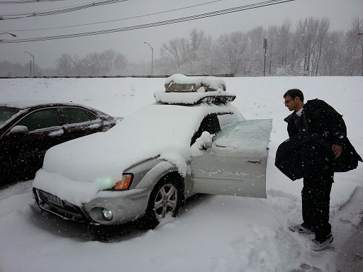

I had Hankook Optimo 4s (http://tires.canadiantire.ca/en/tires/a ... optimo-4s/) all seasons, which I really liked. They were great practically everywhere, including in snow, even when they were almost down to the wear bar.
Not exactly sure what the tread depth was, but about five months after driving them through this: I had to replace the tires because the wear bars themselves were starting to be worn down. And I didn't have any traction problems. I would have purchased those tires again, but I can't find them in the US... seems to be a Canadian Tire exclusive. Probably not the answer you were looking for; just my experiences.
