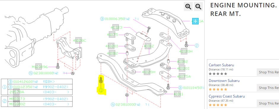

The problem bolt is #1 in this diagram:
http://parts.subaru.com/a/Subaru_2003_B ... 10-03.html

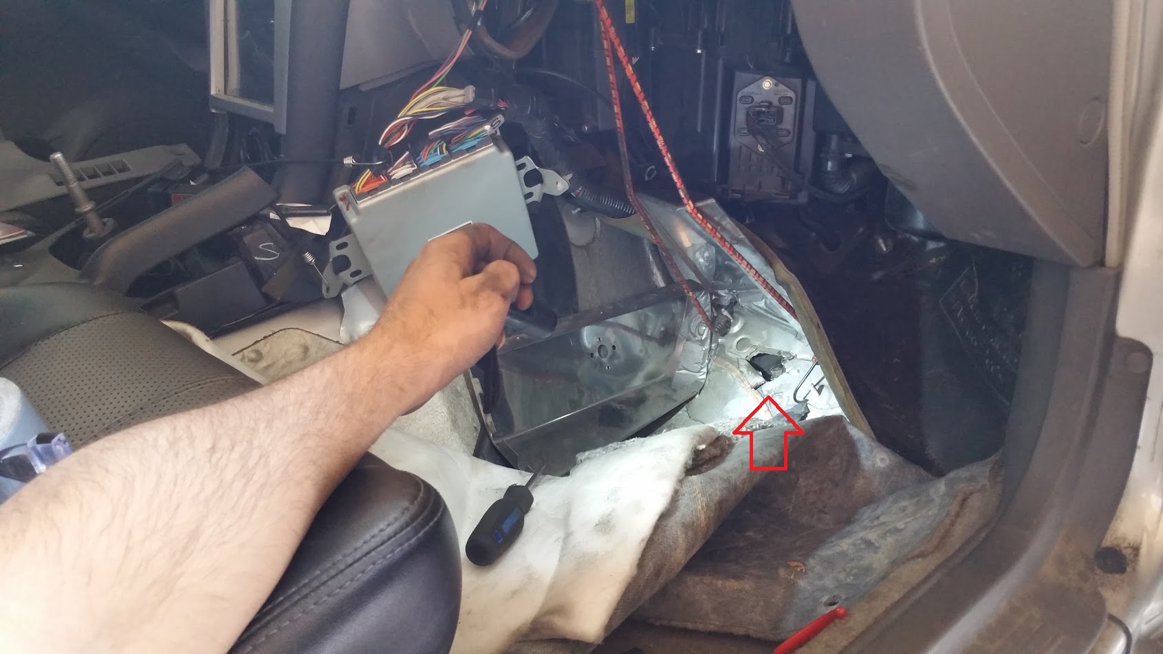

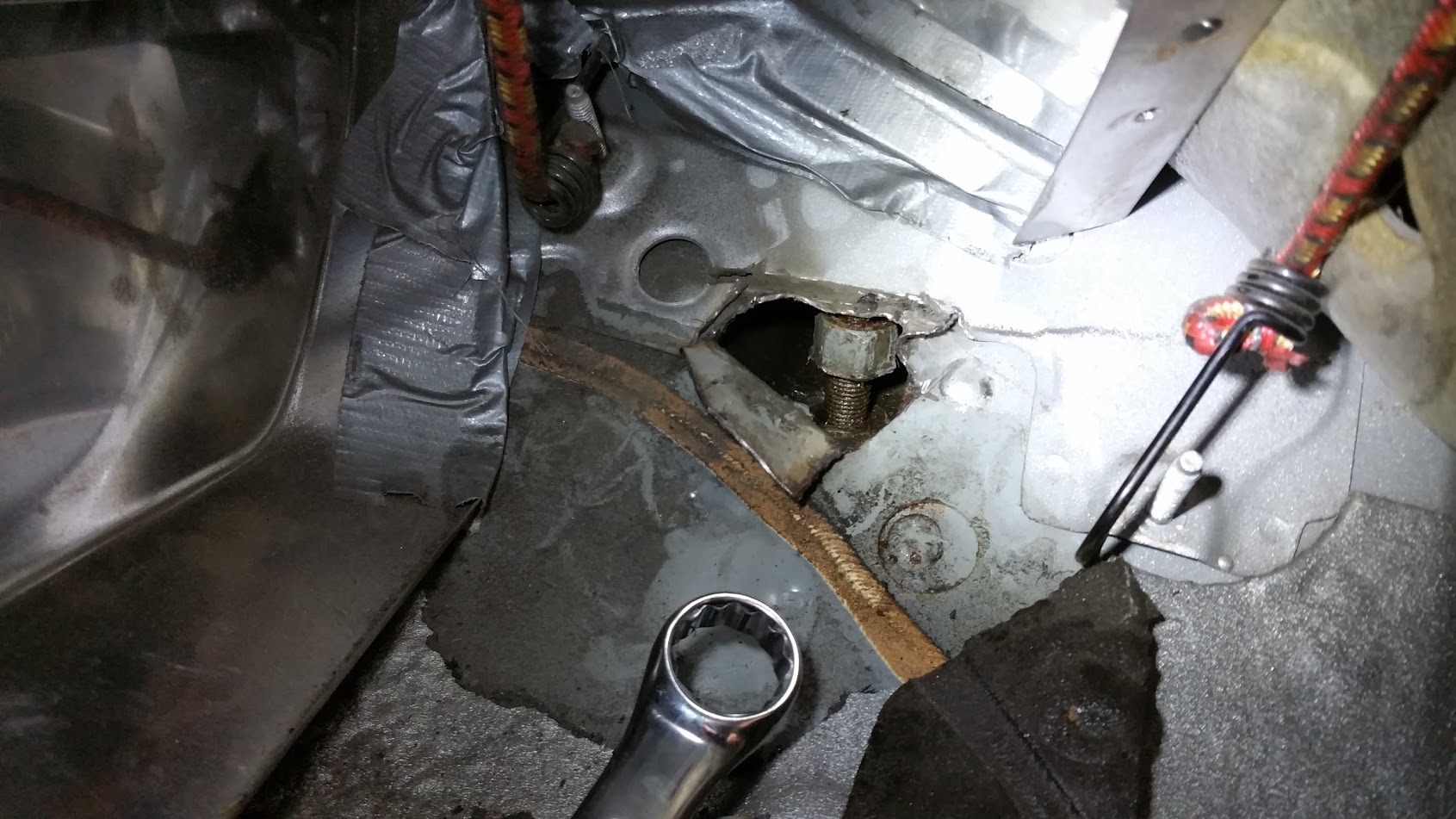

And it looks like the most common solution is to cut a hole in the floor and peel back the metal to access the nut. Problem is, I couldn't find any pictures of where to cut, so I thought I'd post some pictures to help anyone else who might be in this situation. Not the best cutting job in the world by a long way, but it worked...
