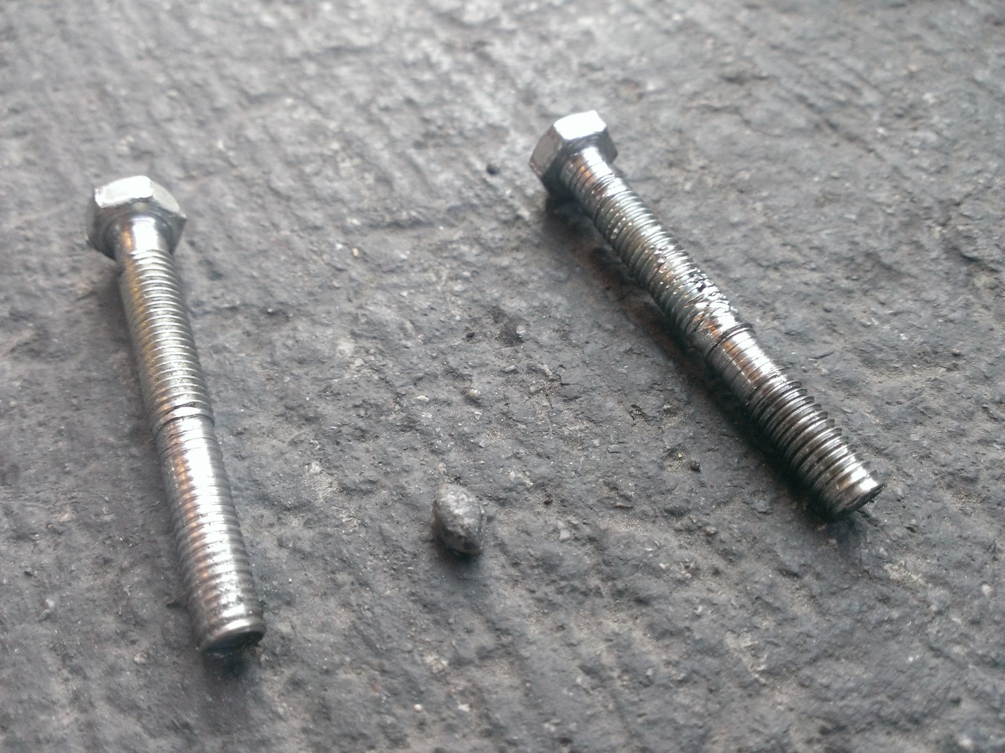

The only thing I would recommend differently from him is to use the AC clutch removal tool, which you can rent for free from many US and Canadian auto parts stores. Don't use the screws to try to push the clutch out...
I had the same symptoms as you, and removing one of the clutch shims worked for me. Working great for a year, now.
http://www.subaruforester.org/vbulletin ... 8578524745
- WP_20150711_007.jpg (400.85 KiB) Viewed 4216 times
