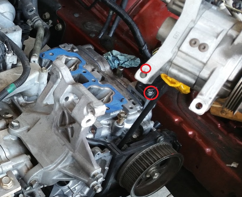

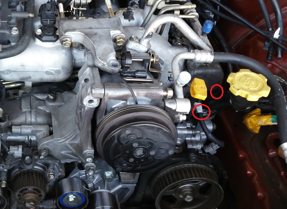

Removing the oil filler neck itself should just be two bolts where the neck meets the head. From there, you can at least check if there's a blockage in the neck, or something obvious like that.
Otherwise, it might be one of the oil passages, but they're not exactly tiny...
