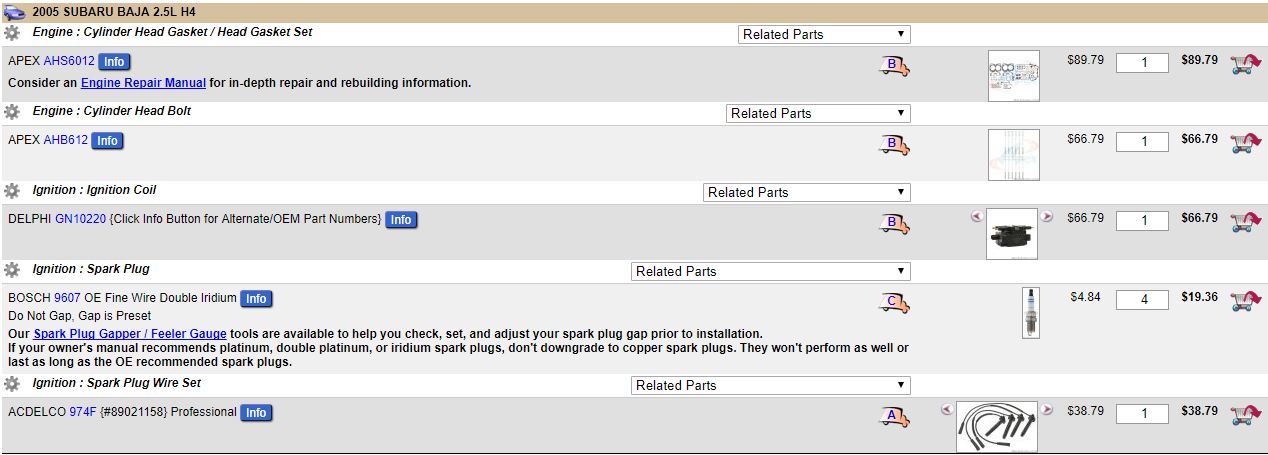

Here's what I'm thinking from Rock Auto:
Baja gaskets and ignition.JPG (99.27 KiB) Viewed 4708 times

Just make sure that whatever head gasket you settle on the description reads Multi Layer Steel (MLS). That was the solution to Subaru's long standing HG failure issues. OEM gaskets on non-turbos might be subject to failure. OEM MLS gaskets on turbo models don't fail regularly. You can research the need for new head bolts. Many experienced builders reuse them and others don't.
