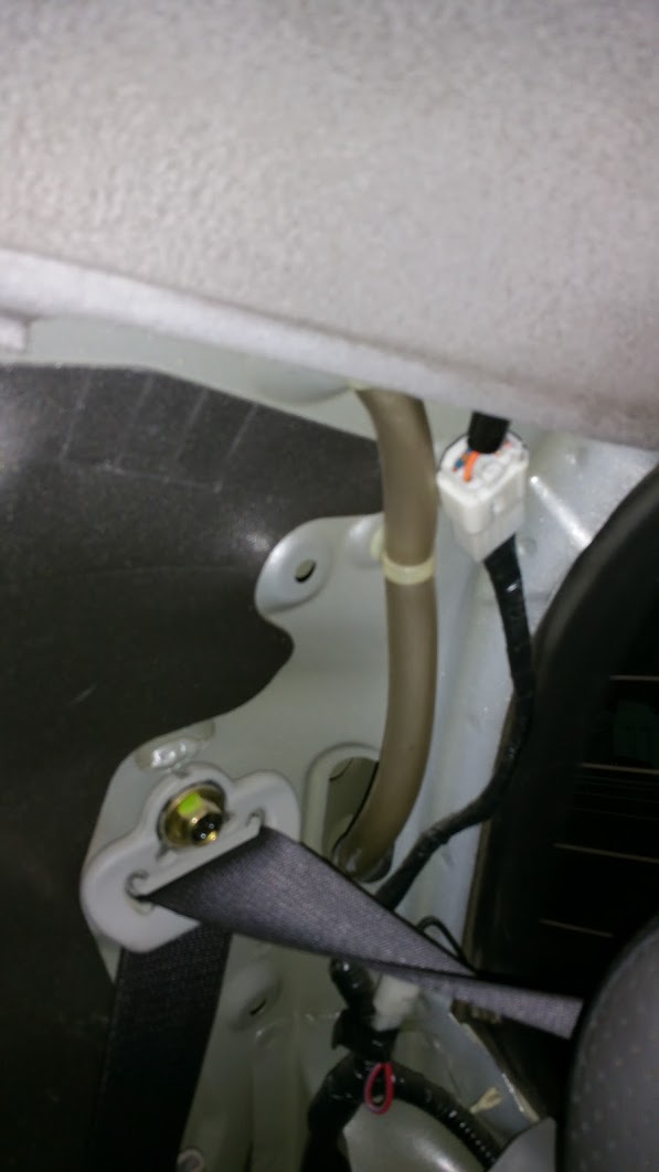

Re: Sunroof drains
Just to add, the drain hose appears to go out of the cabin through a hole near the rear seat belt's upper loop thingy (not sure the name)...
- 20170709_215328.jpg (51.52 KiB) Viewed 9531 times
- 20170709_215348.jpg (443.7 KiB) Viewed 9531 times
