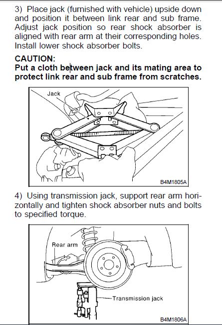

baja rear.JPG (78.42 KiB) Viewed 14458 times
Here is a clip, they even show using a transmission jack to push up on the bottom of the rear shock, while your using the stock flat tire jack to push down on the arm.
I think I ended up positioning it slightly different that what they have in the picture when I added my 1" blocks??
