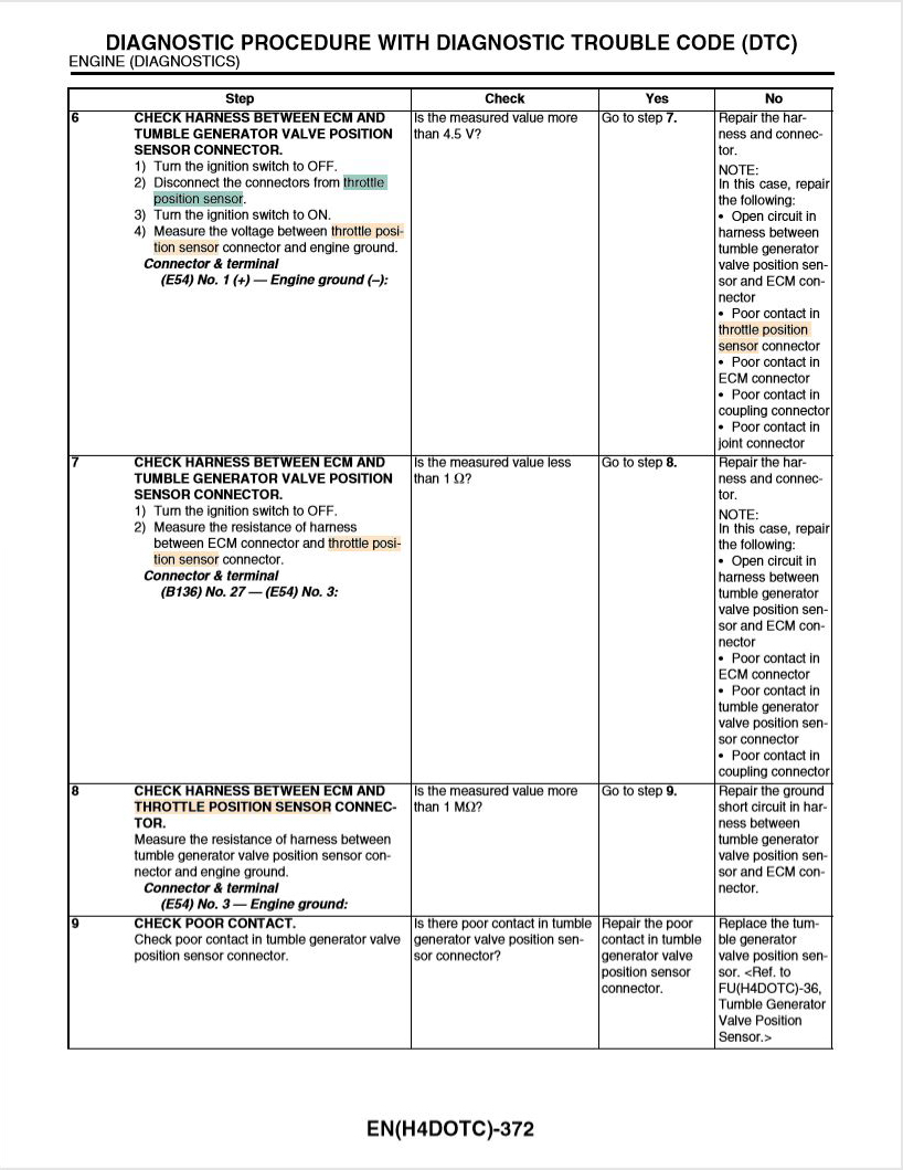

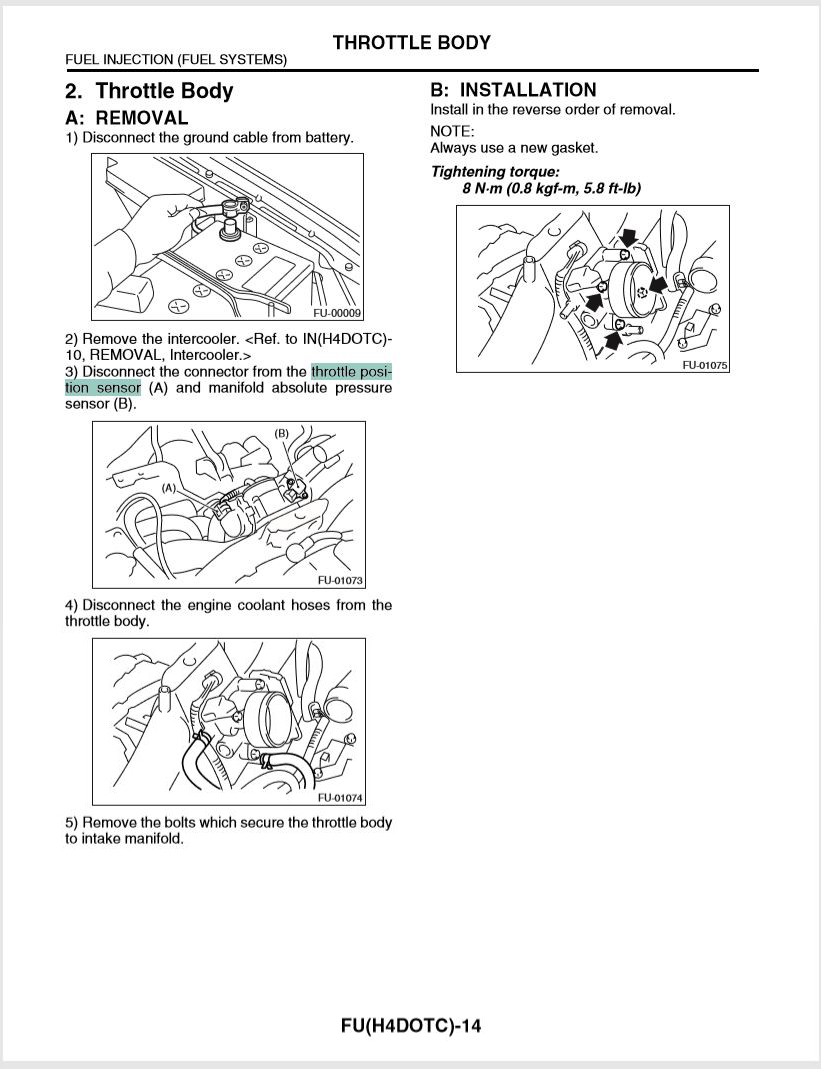

According to the FSM, the turbos have a TPS.
Rockauto also has the parts listed.
http://www.rockauto.com/en/catalog/suba ... (tps),5136
