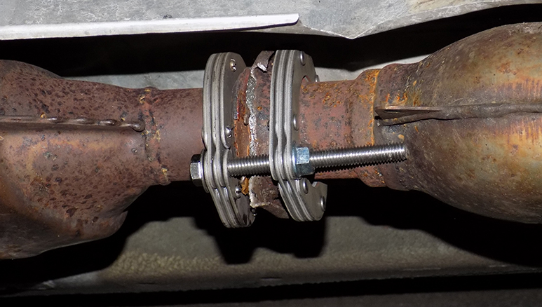

Well now that most of my exhaust is on its last legs & is currently held together with what amounts to a duct tape fix (pic below), I'm currently browsing around for relatively cheap replacement parts. A full OEM exhaust runs about $2600, but I've managed to find a full exhaust replacement for around $500-$600 depending on which parts I get. I got a price estimate for a professional weld job to fix the flanges & holes for around $350... so a an entire new exhaust for a little more money the seems like the better option. Problem is though, most of these replacement parts look like they'll last only a couple years out here in MD where the state highway admin FREAKIN LOVES SALT. [smilie=hate.gif]

You're right, the replacement parts will definitely rot out in a few years. That's the price difference: the stock system is stainless or near enough and lasts a lot longer (in my case, 150k miles/15 years with a few pinhole gasket leaks). so 173/year for OE($2600/15) or 150/year ($600/4 years). both figures ignoring repairability.
Have you checked RockAuto? looks like they have a kit from Bosal that's the *whole* exhaust and RA has excellent cust service and 5% discount codes available about everywhere. add the cheapest cat and it comes to 550 shipped for me. I have prime but I'll buy car parts from RA all day long unless it gets to be 25% cheaper elsewhere. less sketchyness and dealing with multiple retailers and knockoffs and who knows what.
As for the paint, the main thing I'd worry about is any paint will raise the cost. The better the paint, the more costly. yes it'll help and I wouldn't worry about the subaru warning in this case. the reason behind it is that they spent a hefty chunk of change on emissions testing and material longevity of their parts. anything you do to it means they have to argue if there's a warranty issue. the two issues I see with painting is it could increase temps in the cat by retaining heat (not likely enough to notice though) or unpleasant odors from it burning off in a 1200+f environment. I've done it before and it absolutely helps on the pipes but the problem, as in your case, is the joints and water in the exhaust gas. Also, the car I did it to is a summer track toy, not a winter DD. winter ice, snow, salt, brine may just strip the paint off like a sandblaster.

Well shoot... guess I'm SOL. I never saw the full kit until I opened the 03- why don't they have that kit listed on all the NA model years? Anyway, the whole thing's hanging by a thread from the cat back & the cat flange is toast so either way I'm going to have to bite the bullet eventually. Guess I'll just have to start saving & see how long the paint hold up in the grinder! Thanks for the info.
