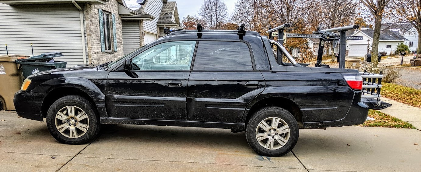

So I bought an '03 Baja Sport (228k miles)earlier this year, with the intention of lifting it, only to later realize the body was a bit too rusty for me to feel comfortable offroading it. We fized the critical rust issues then gifted it to my retired father who always wanted one. For those curious, the rust repair photos can be found here: https://photos.app.goo.gl/ymqqGNXaStQEDyu38
This let to me looking some more and finding "Patches", our 2006 Baja Turbo Auto with 144k miles on it. It had some cosmetic body damage, but no rust.... It wasn't till after the 3 hour drive to purchase it, and a week at the mechanic did we realize what we had gotten ourselves into. With over 10 hours in road trips, we sources parts to replace the turbo, transmission, and do an EJ20X swap. Last week we finally got the lift kit installed (2/2.5" SLO kit), and with that finished the last of our major work on Patches for 2019.
Future projects for her are mainly going to be limited to wiring in the light bar and installing skid plates as well as mounting plates in the rear for recovery equipment.
Additional pictures of the bed rack install: https://photos.app.goo.gl/763VRDsXY9cDMtrv7
The rack was something I had a very specific requirement of. I wanted to be able to haul full 4' x 8' sheets of plywood as well as construction lumber and materials to an off-grid cabin. This does the job quite nicely.
