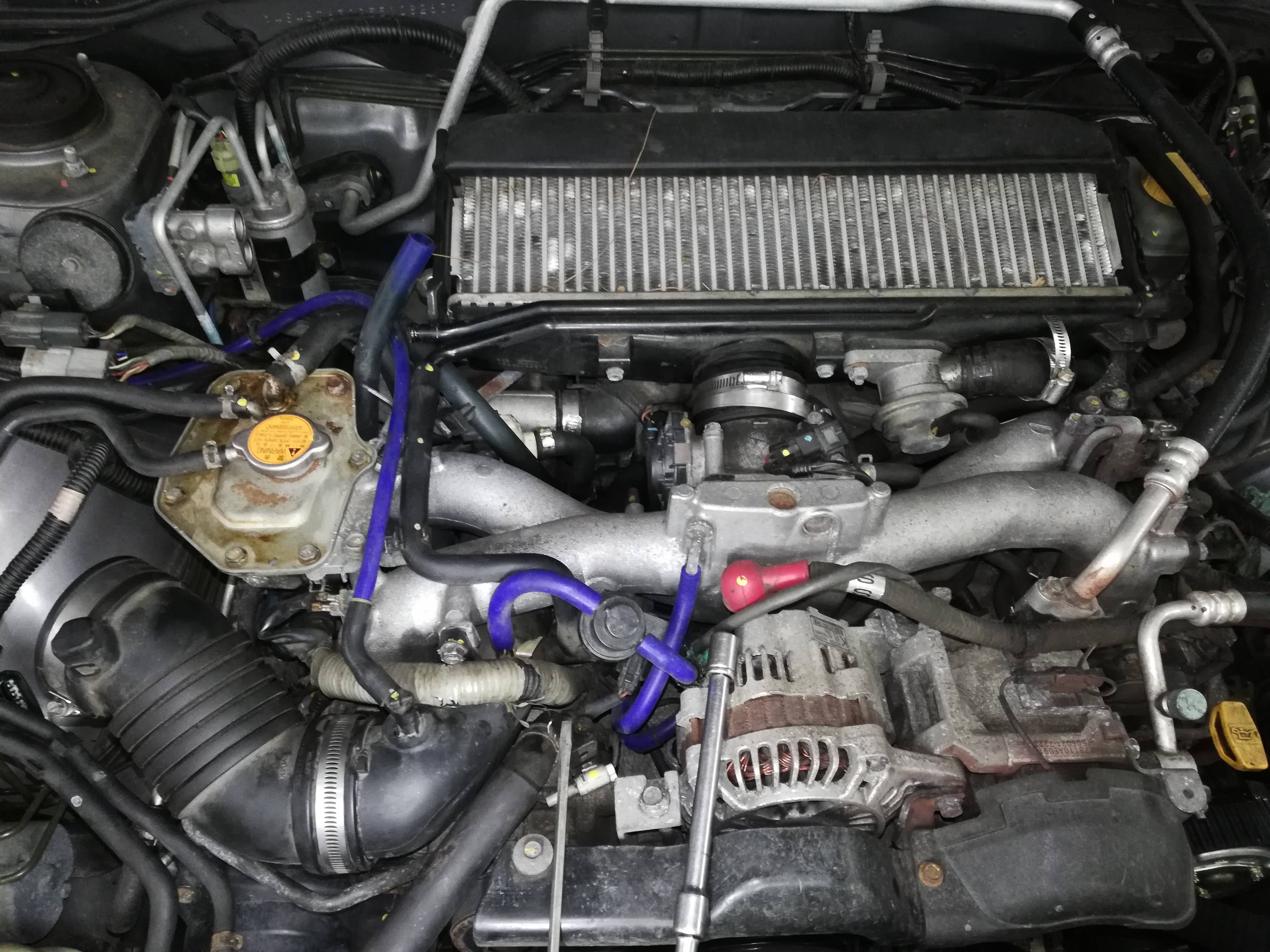

When I pulled the engine out to do head gaskets on my 05 turbo I bought a bunch of silicone hose in various sizes from Amazon. I changed any cracked lines with the hose and it's been working great for the last 20k.

Joe it looks like the 2 steel lines to the inter cooler, the one in the rear appears to not be connected or it is blocked off.

harleyjohn45 wrote: Sun Mar 15, 2020 7:26 pm Joe it looks like the 2 steel lines to the inter cooler, the one in the rear appears to not be connected or it is blocked off.
Harleyjohn, yes, the picture was taken during assembly, they all ended up getting connected prior to finishing up. The only easy access pic I had (short of going outside and taking another) was my assembly library. Thanks!
