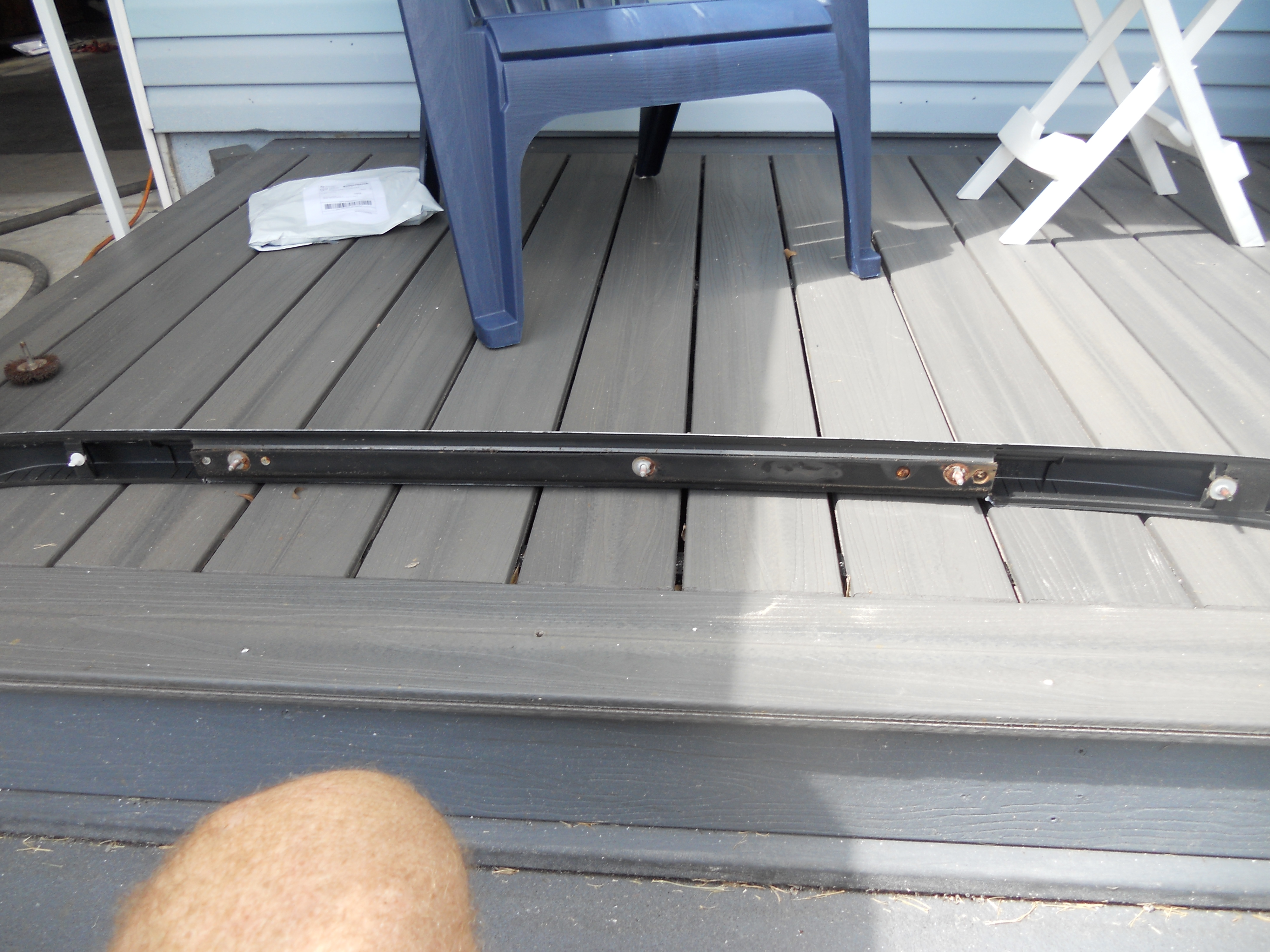

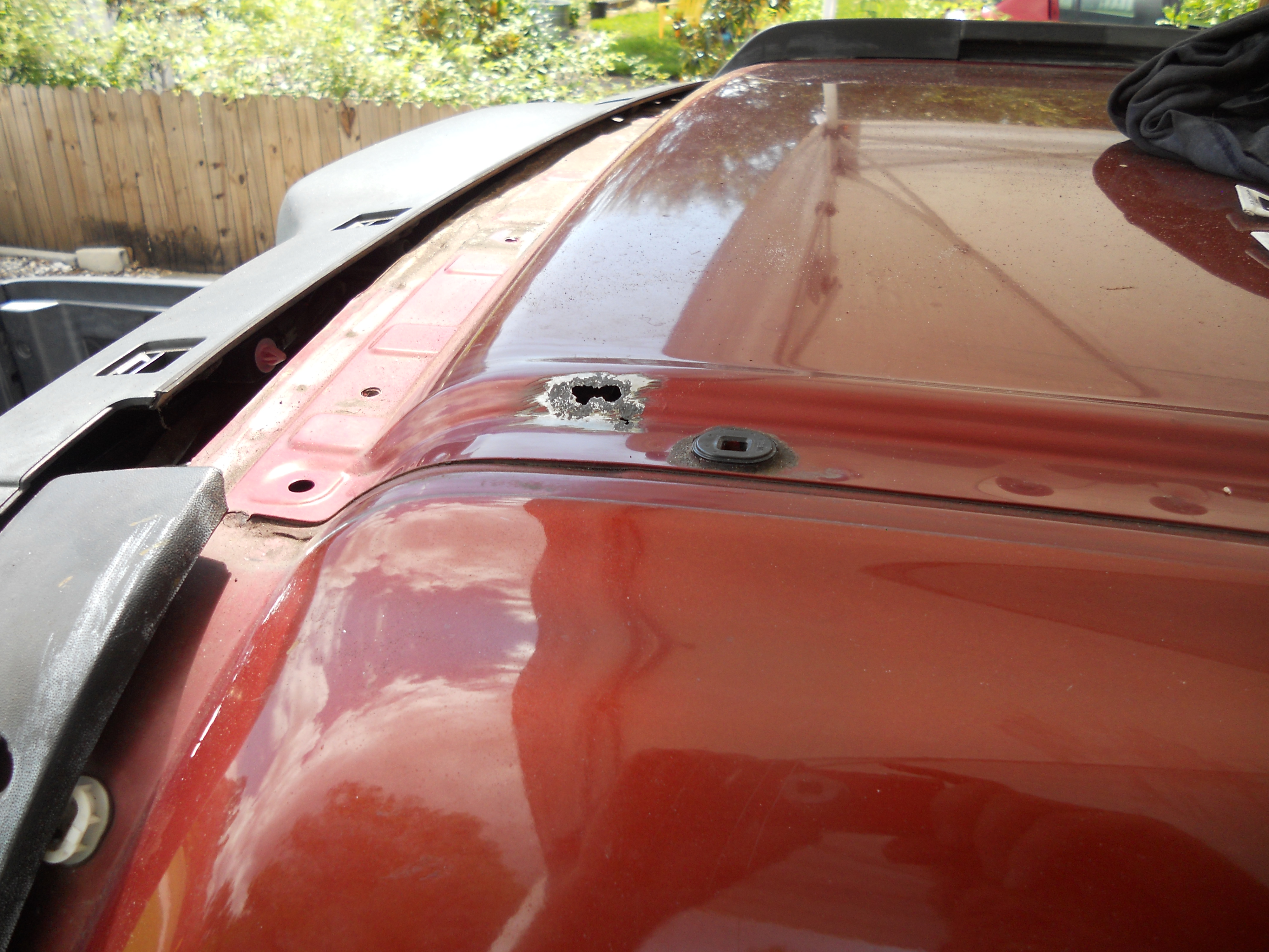

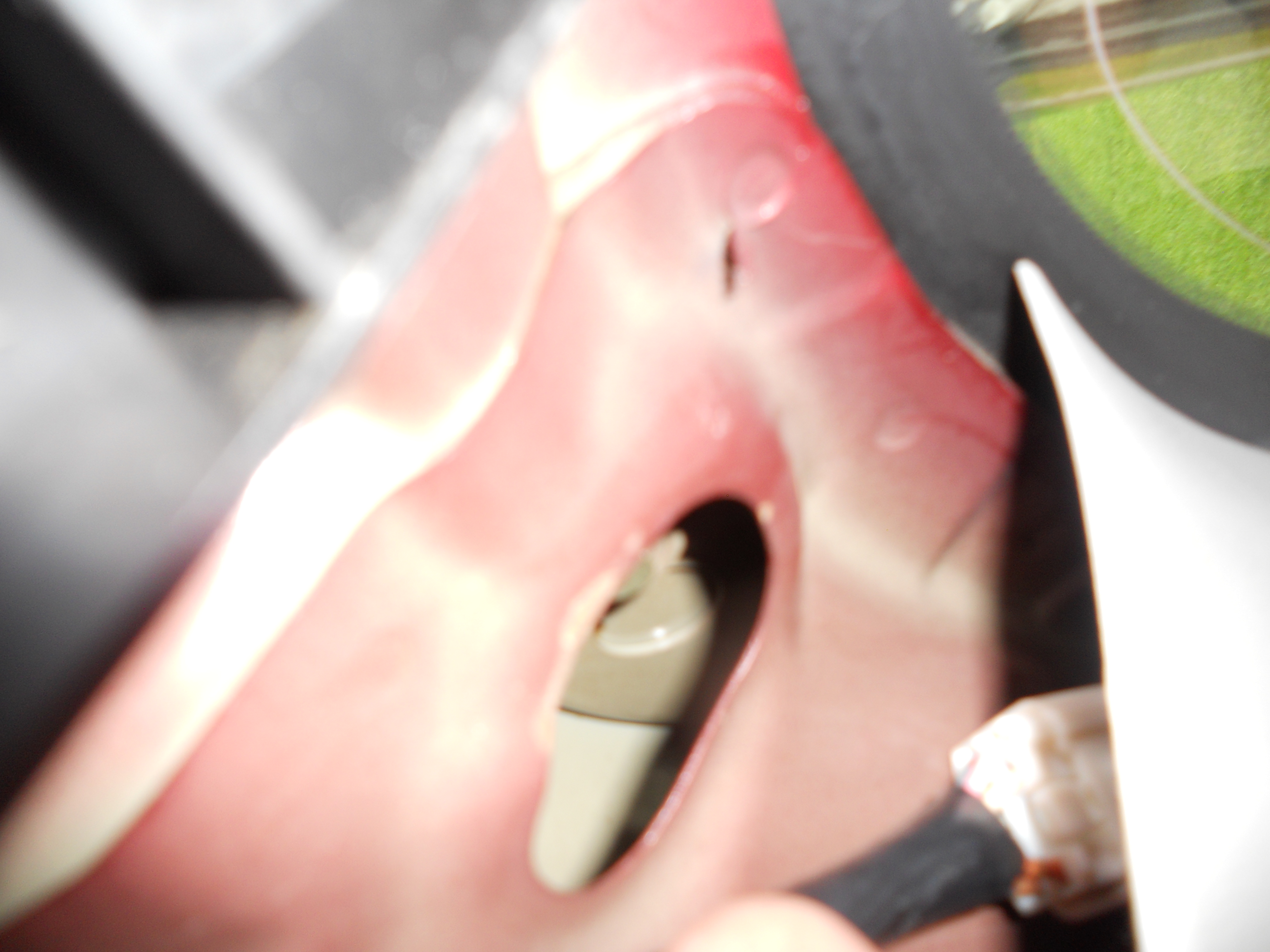

The rails are held in place by 5 10 MM nuts. There are 2 pairs over the doors, and the 5th is hidden in the rear corner. You will probably have to remove the headliner for GOOD access. You may also have to remove the top rear plastic trim outside above the rear window. YES, the square plastic covers will break :evil:. There is a round cover under the upper corner fairing for the chrome brace bar. Once the rails nuts are removed, the rail will come off. Don't be surprised if you find rusty spots - I did.
hidden nut in corner
Rail removed
Rail removed
Rust spot from rail leaking
