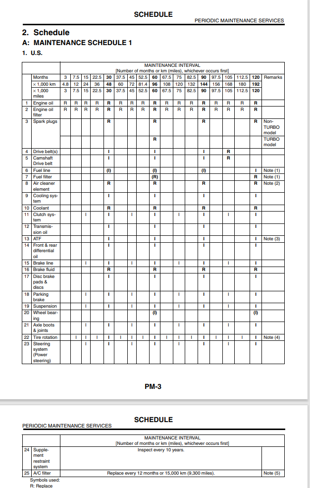

here is a screen shot of the maintenance schedule for a Baja.

Thanks for the advice, ram, and the maintenance schedule.
I'll be sure to replace any hoses and other rubber parts if I do end up buying it, as well as checking the timing belt.
