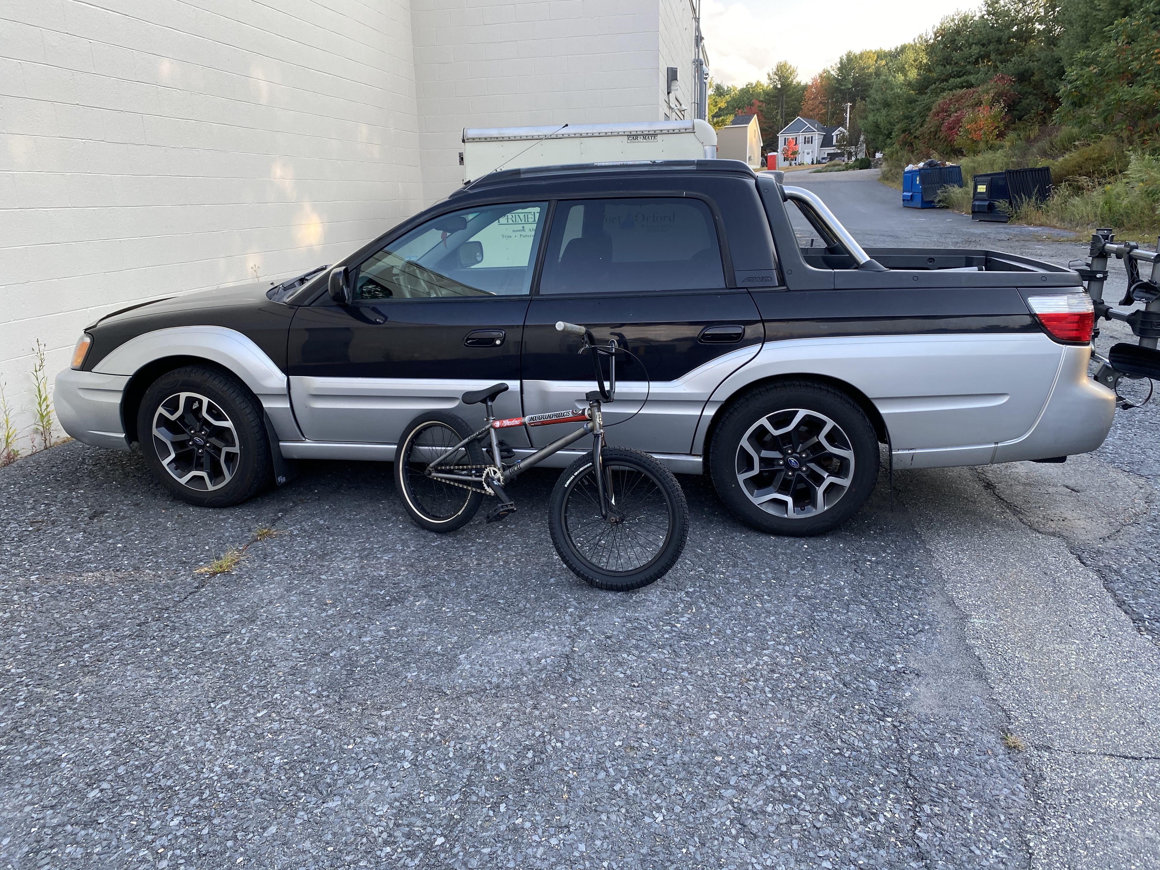

gkonvicka wrote: Mon Jul 27, 2020 12:14 pm I swapped out my OEM 16" wheels for 17" Crosstrek wheels and tires. Have not have any problems.
I have 2003 Baja. I’ve heard the later models have more clearance, but would my 03 be able to run the 17” crosstrek wheels with 225/55/17 tires? Size is essentially the same.
With all stock, what’s the biggest tire I can run? Wanting to go taller and something more aggressive.
STEVEW
Posts: 46
Re: New Baja owner: wheels/tires size question
Post by STEVEW »
Arkie wrote: Thu Oct 01, 2020 6:36 pm
I have Crosstrek wheels on my '03 w/ 225/55/17. They fit perfectly. I'm not sure if you can get much bigger of a tire on without lifting it though.

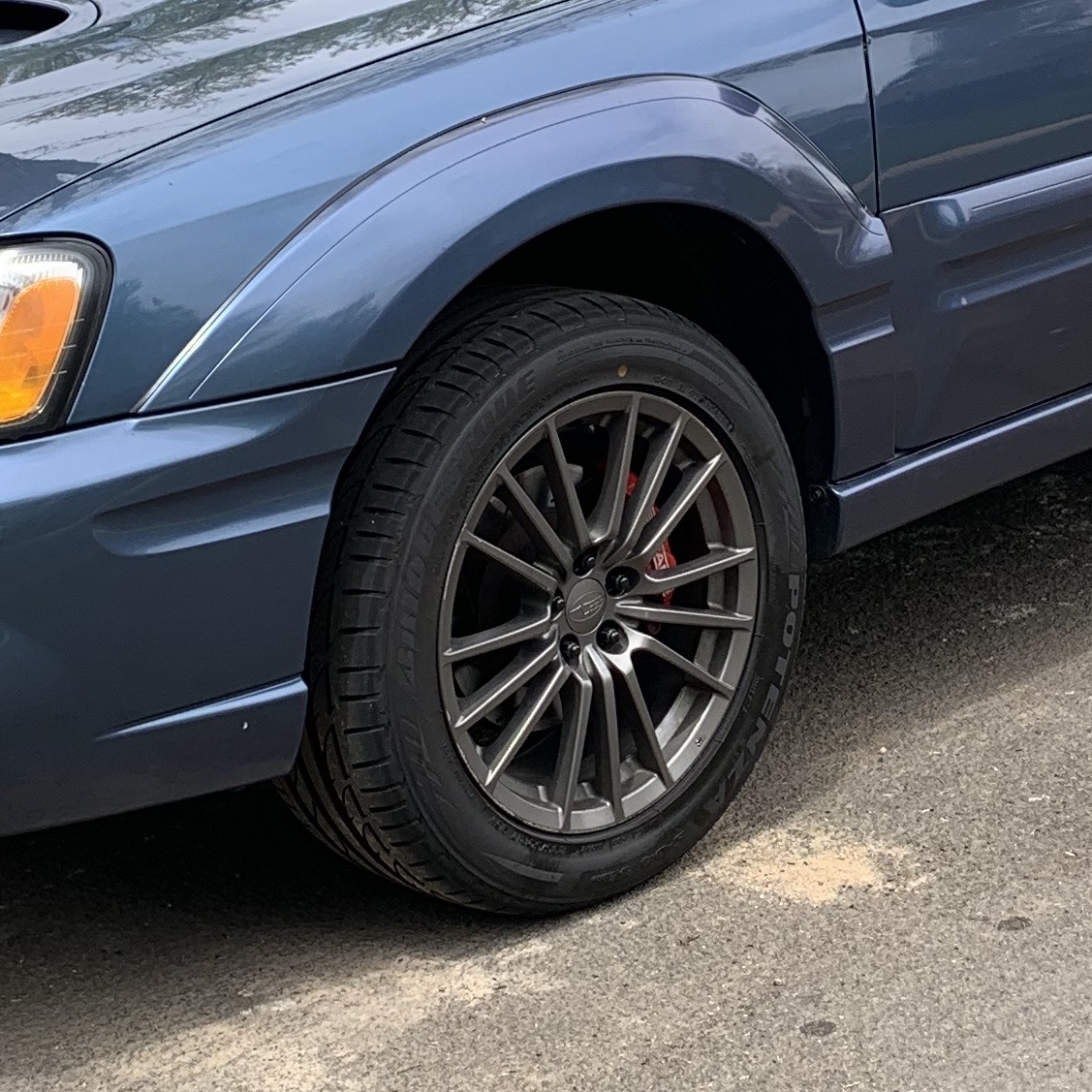

I’ve been running on ‘11-‘13 WRX limited wheels with 235/50R17, if you are considering going ‘big’ in the width direction. 8” does well in my world. The bonus is they fit over the OEM 4/2 pot brakes.
