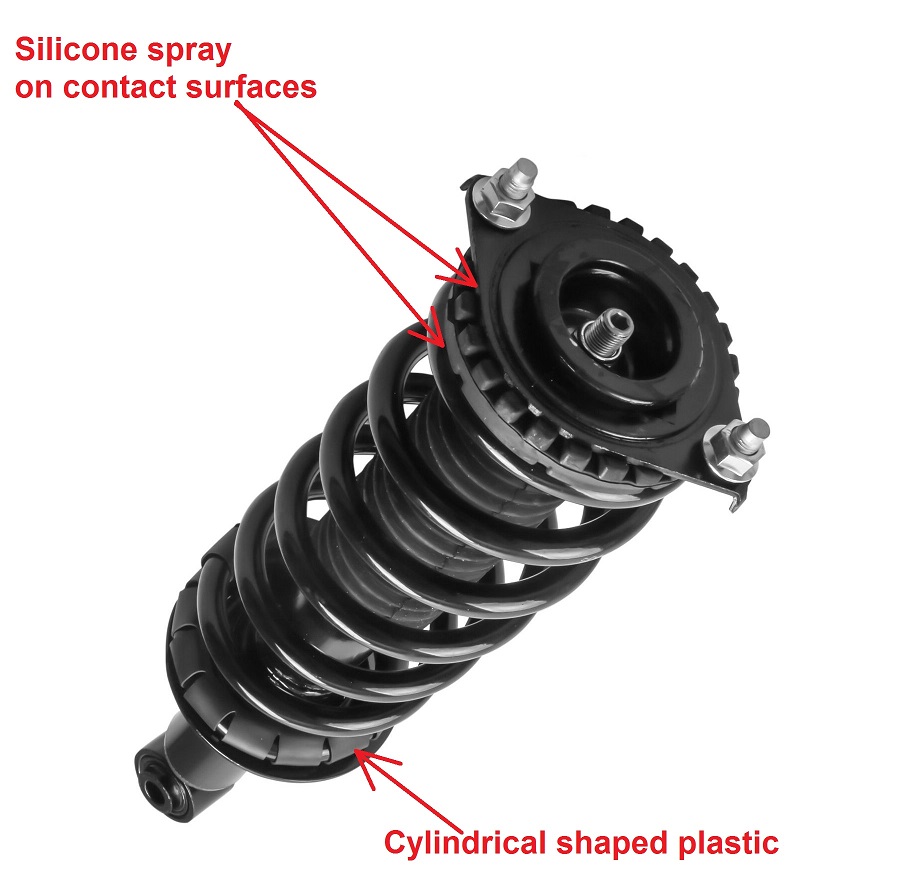

There's an annoying constant little squeak that sounds like rubber on metal coming from back there. It's not too loud at all but it's like Chinese water torture! I've been trying to live with it but I just keep thinking that maybe I didn't install those Strut Mount kits correctly which could possibly cause damage or maybe cause them to not last as long as they should or even fail somehow. If they are installed correctly, maybe they just need some silicone spray on the top rubber pieces to kill the squeak. That's one possibility.
The other is that when I removed the old strut assemblies, there was a small piece of thin plastic on each one molded to the cylindrical shape of the bottom last few inches of the coil rod that was between the coil and the plate it rests on on the strut. The old plate had come a bit loose from the old strut so the old plastic pieces were all chewed up.
(See the attached stock photo.)
I'm assuming they were there to begin with to either prevent excessive wear between the coil and the plate and/or to stop squeaking. I thought I could do without it and I didn't bother trying to re-use the chewed up pieces because they were too cut up to re-use. There weren't new ones either with the new strut or new coil spring so I didn't give it much further thought. Maybe that was a mistake!
I was thinking of cutting a small piece of silicone sheeting to stick in the place of the old ones or molding a small piece of No. 2 plastic which can be easily reformed if you heat it up in an oven at 350 degrees. (I get the plastic from laundry detergent jugs and always place it on parchment baking paper first in the oven!)
That would mean completely removing and disassembling both damn strut assemblies, installing that small piece and reinstalling the whole shebang all over again.
