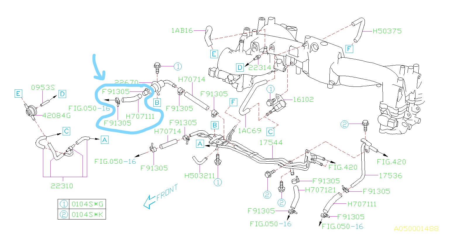

PROBLEM FIXED!
I finally found half a day to work on it, over the holiday weekend.
I believe the fuel overpressure was caused by that short, 45 degree bent, fuel hose that goes into the Fuel Pressure Regulator. I can't confirm if it was 100% blocked by the kink in the straight hose I had on there; but it was definitely restricted.
Part number for the hose is 807707111 on the Subaru parts pages; and it's about $4.00 USD.
For the curious, this is what I removed and reinstalled to access it:
- Top Mount Intercooler and Y pipe
- Short "S" tube from bleed valve to turbo intake
- The turbo intake assy (and all the associated little tubes/fittings)
- Vapor canister purge solenoid (and that little rats nest of vacuum tubes in front of it)
Doing all that, got me pretty clear access to get the old crappy straight hose off; and the new 45 degree pre-bent hose back on, with new fuel line clamps as well.
Leak checked, then reassembled everything; and it started up on the first crank. Purred like a kitten.
An oil change, and I was off for a Sunday drive.
