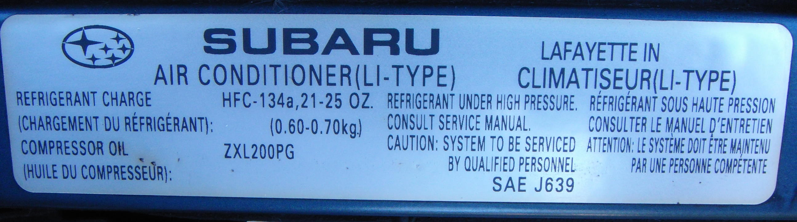

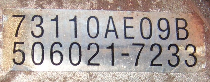

Are there different styles of a/c Compressor?
Hello Everyone
I need a new a/c compressor and
I'm unsure what "style" I have.
After market sites list "DKV14G Style"
compressor, which implies there is
more than one style.
Is there more than one style, or are
they all DKV14G? I don't see any
other choice, so it seems like DKV14G
is the only style. But if it is the
only style, then why list it at all?
I looked at the sticker on the
compressor (attached) hoping that
the numbers would help me find
the style - no luck. Neither
of the numbers have any hits on
the major search engines.
I was hoping maybe one of the
online Subaru sites where the
VIN can be entered would list
the style. No luck here either.
Subaru lists the part number as 73111AE09B
and mine is . . . . . . . . . . . . . 73110AE09B
Why am I showing the part numbers?
The Subaru 73111AE09B is linked on
after market sites to DKV14G Style.
Does the 73111 vs 73110 make any
difference to the style?
I need to order a compressor, but
want to feel sure I'm ordering the
correct one.
First Pic is the underhood sticker
Second Pic is the compressor label
I hope someone can help?
Thanks . . . . Brian
2006 Baja, Non-Turbo, Automatic

Thanks so much for the information and
your generous offer. I appreciate it.
I have already ordered a new one after
finding my exact codes in the pics of
one compressor.
My compressor would work intermittently
and is likely the clutch. Also varying high
side pressures after a full charge.
I'm in the process of installing it right now,
along with a new expansion valve and
receiver dryer.
Thanks again . . . . Brian
