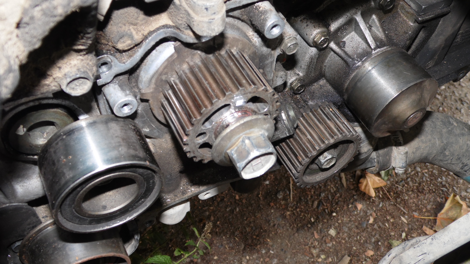

As I had mentioned before, the timing belt broke while I was driving down the highway. The engine shut down quickly and did not make any abnormal noises so I am hoping the engine is still good. I got everything apart just fine, but had to put the crankshaft bolt back into the crankshaft to rotate the crankshaft to the timing mark. Now I can't get the blasted thing off. I have tried every trick on YouTube and that I could find on various forums. Below is a photo of my problem. Anyone have any ideas on how to get that blasted thing off?

Thats easy. Under the throttle body on the back of engine/front of transmission is a big black rubber plug that covers the flywheel. Pop it off and put a screwdriver or small prybar in and that will stop the engine from rotating while you are trying to get the bolt out of the crank.
Re: Stuck Crankshaft Bolt, Balancer already removed.
Another trick: put a breaker bar and socket on the bolt, brace the bar against a solid place on the passenger side of the car and bump the starter. Dennis

Thanks for all the replies. None of them worked.
As for a battery operated impact drill, there is not enough room, unless I take the radiator out (and I really don't want to do that).
As for touching the starter I think I have worn out my battery doing that when I first took the bolt off.
Lastly, there is not an inspection port under the throttle body on my engine. There is a mount that connects both the engine and transmission to the frame of the body. Yes, I looked it up on the internet, all I have at that location is metal. So I put the throttle body assembly back together. I had such high hopes.
- Update - Not being one to give up on an idea that everyone seems to be saying is there but I could not find, it turns out that the images I found were wrong. I found the part number for the cover on another forum so I looked it up on Subaru Parts and found a diagram of where exactly it was. Sure enough; there it was. https://www.subarupartsdeal.com/parts/s ... AT;5=BAJA). I found a hole, stuck a screwdriver into it and what do you know, I got the blasted bolt from unknown parts off. :D Thank you oh so much, without you telling me about it I would never have even known to look for it.
