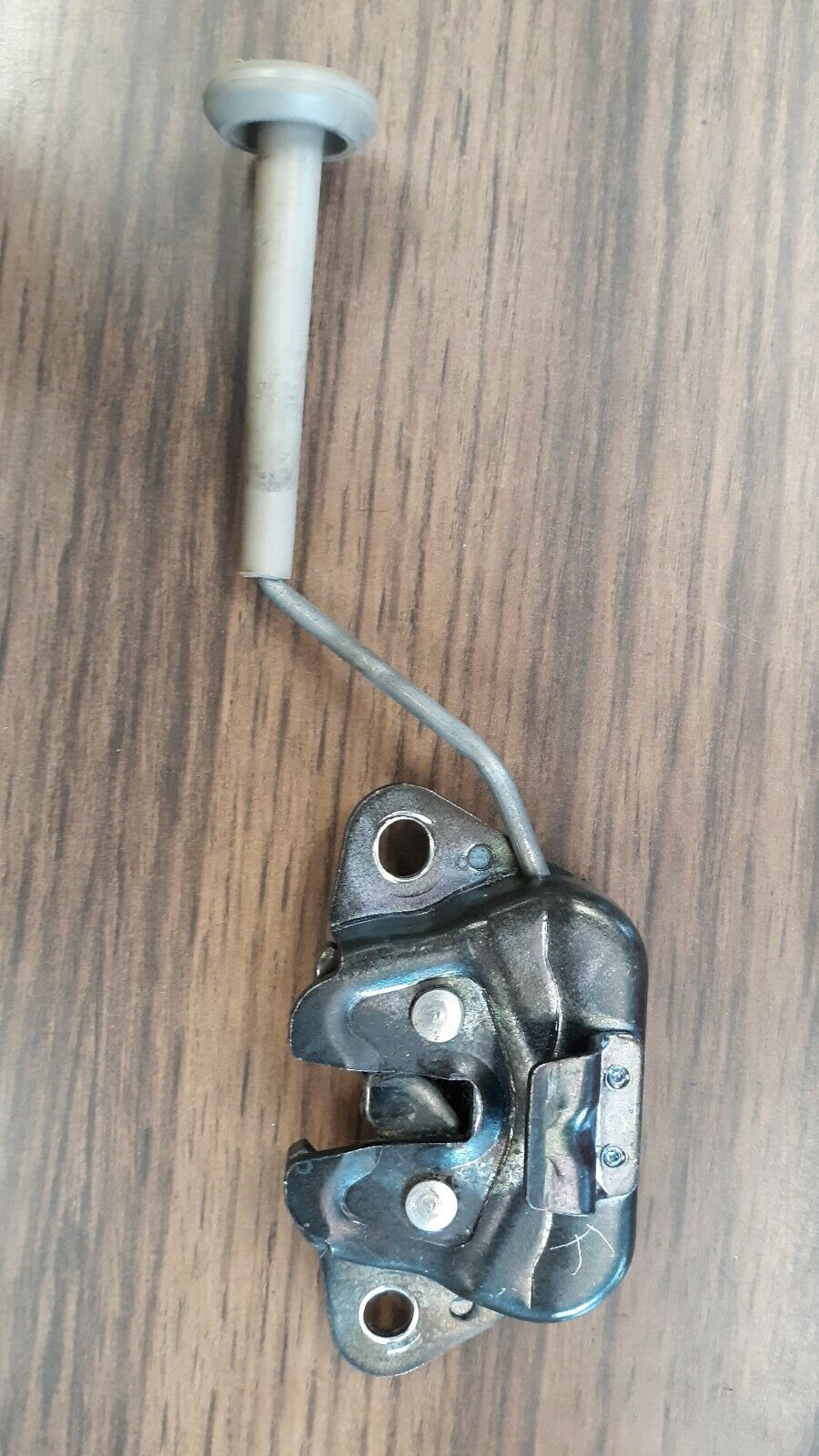

Now that the locking mechanism is free, wiggle it out from the foam and gaze upon its complexity (or lack thereof). (note that I used the unbroken one in this pic)
Step 4:
Now we need to remove the broken shaft (the red plastic piece) from the actuator rod. It's held on just by a tension spring and a small 90-degree hook. Simply pull down the spring and twist the shaft 90 degrees in the opposite direction of the hook and pull it out. (note that I used the unbroken one in this pic)

Yep, totally Baja-exclusive. The latch hardware itself is the same as a 2000-2004 outback, except for the transfer bar and the knob assembly since OB rear seats are split into 2 segments and they don't need to be linked.
Here's one pulled from an OB:
Want to know something really stupid? The part number for the Forester knob is 64580FA510MU, and it fits EVERY Impreza-based model from 2003-2014.
