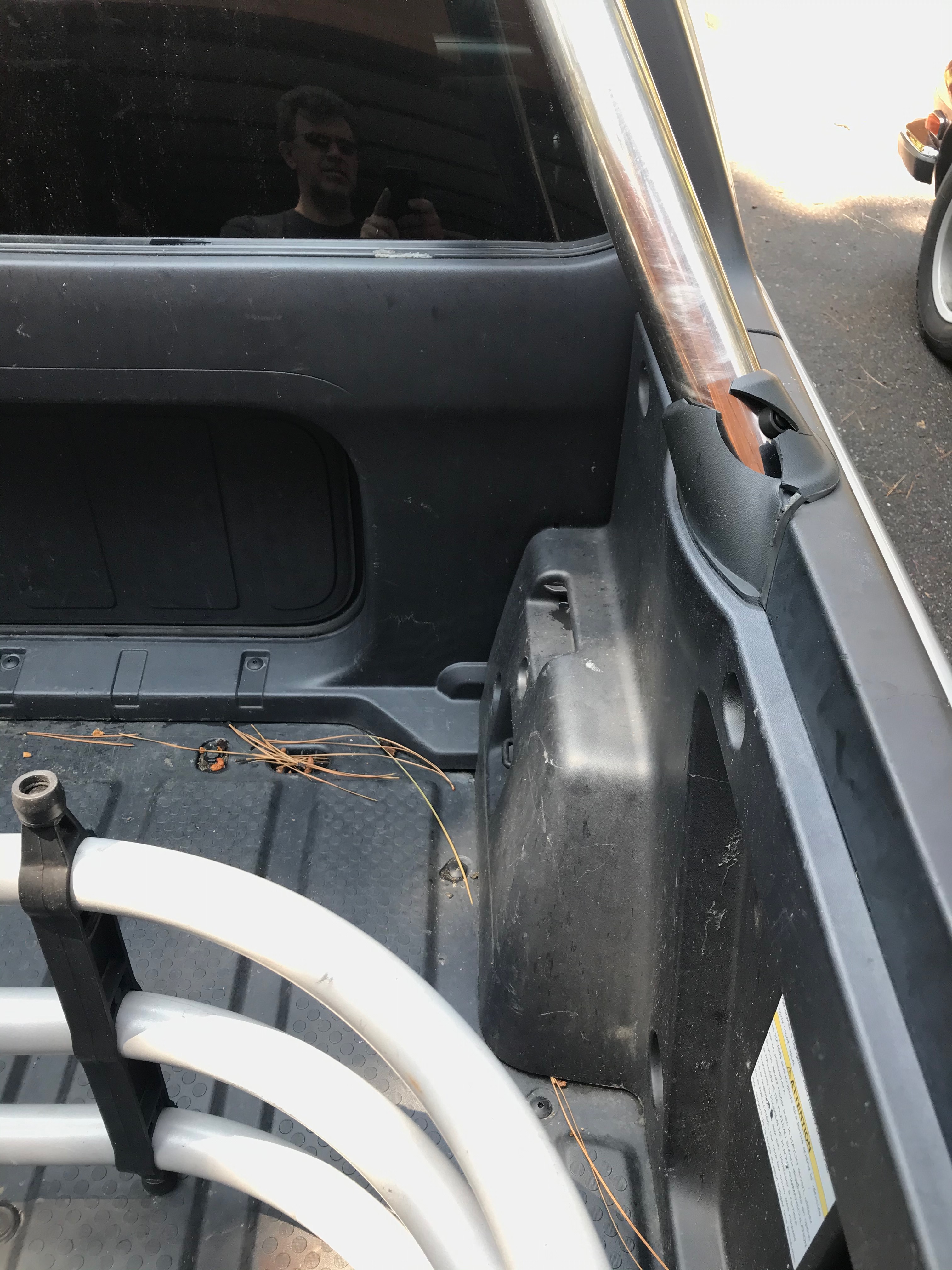

Hi,
I have a cracked plastic boot at the bottom of the RHS bar in the trunk. See the picture.
I ordered a replacement part from Subaru.
How do I go about replacing the plastic boot? Do I need to first remove the side panel of the trunk? What else? What is the sequence of the steps?

Did this job today (replaced cracked boot/cover of the trunk bar).
It wasn’t bad. However, after removing the side panel and the trim, one also needs to remove the trim on the side of the cabin leading to the top of the bar. Because the covers must slide on top of the bar through the top, not the bottom.
One piece of advice to those who will be attempting this job. Get enough of side panel and trim clips ahead of the job: you will likely break a few when taking them of
