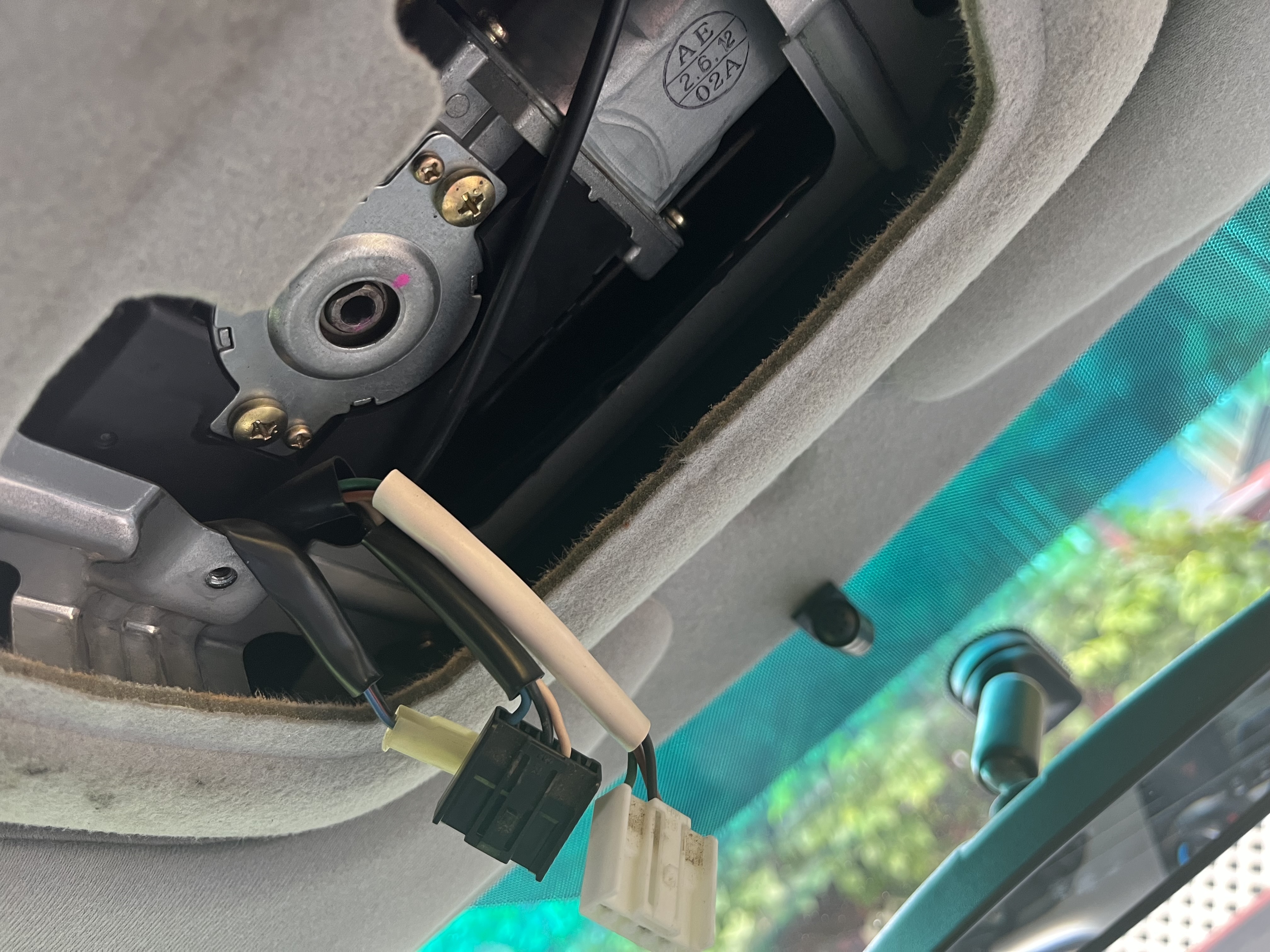

Moonroof switch opens fully/fast. But 100%
dead/non responsive to close. As simple an issue with the switch or likely an issue with the motor?

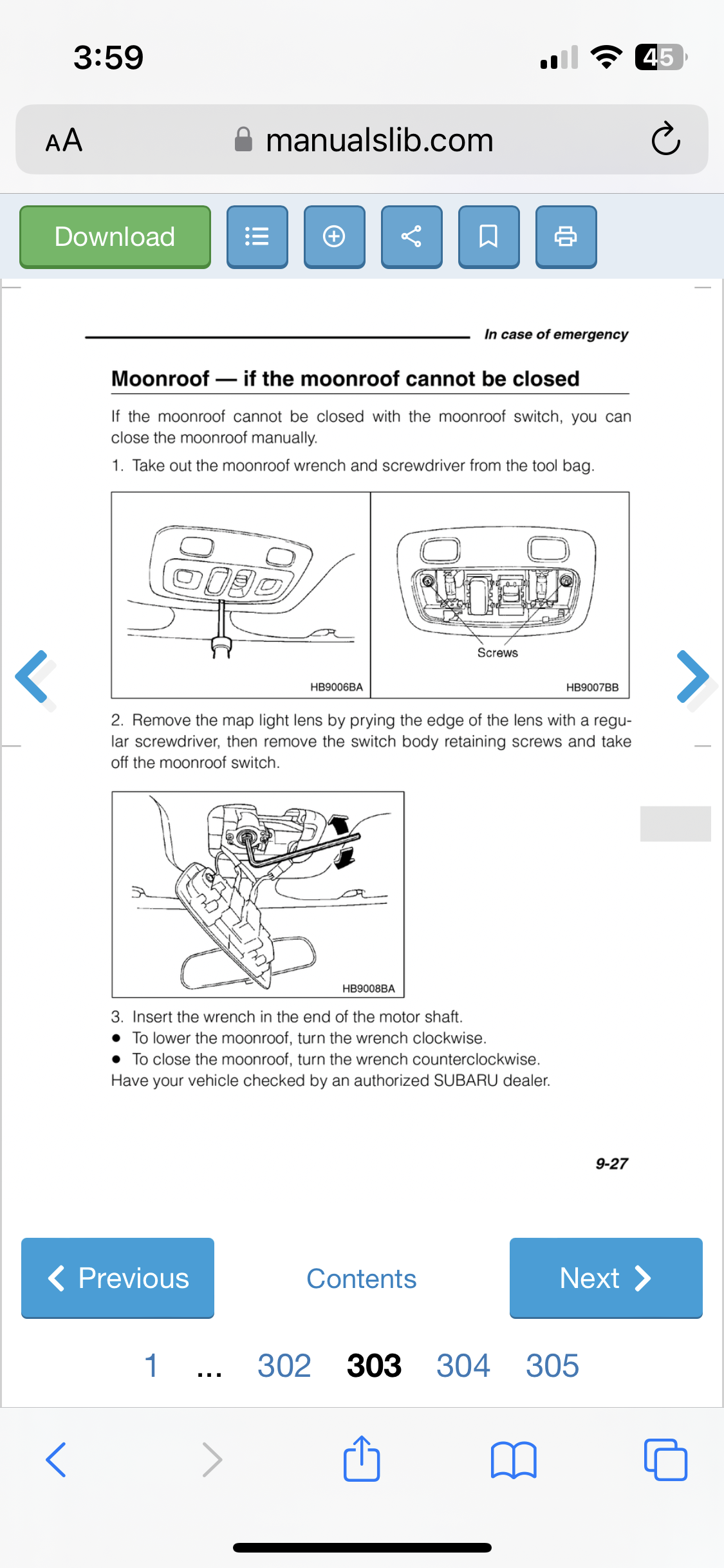

Closed with Allen Key. Opened again smoothly with switch… but then back to the key. Not a case of resisting or jagged close… just nothing.
