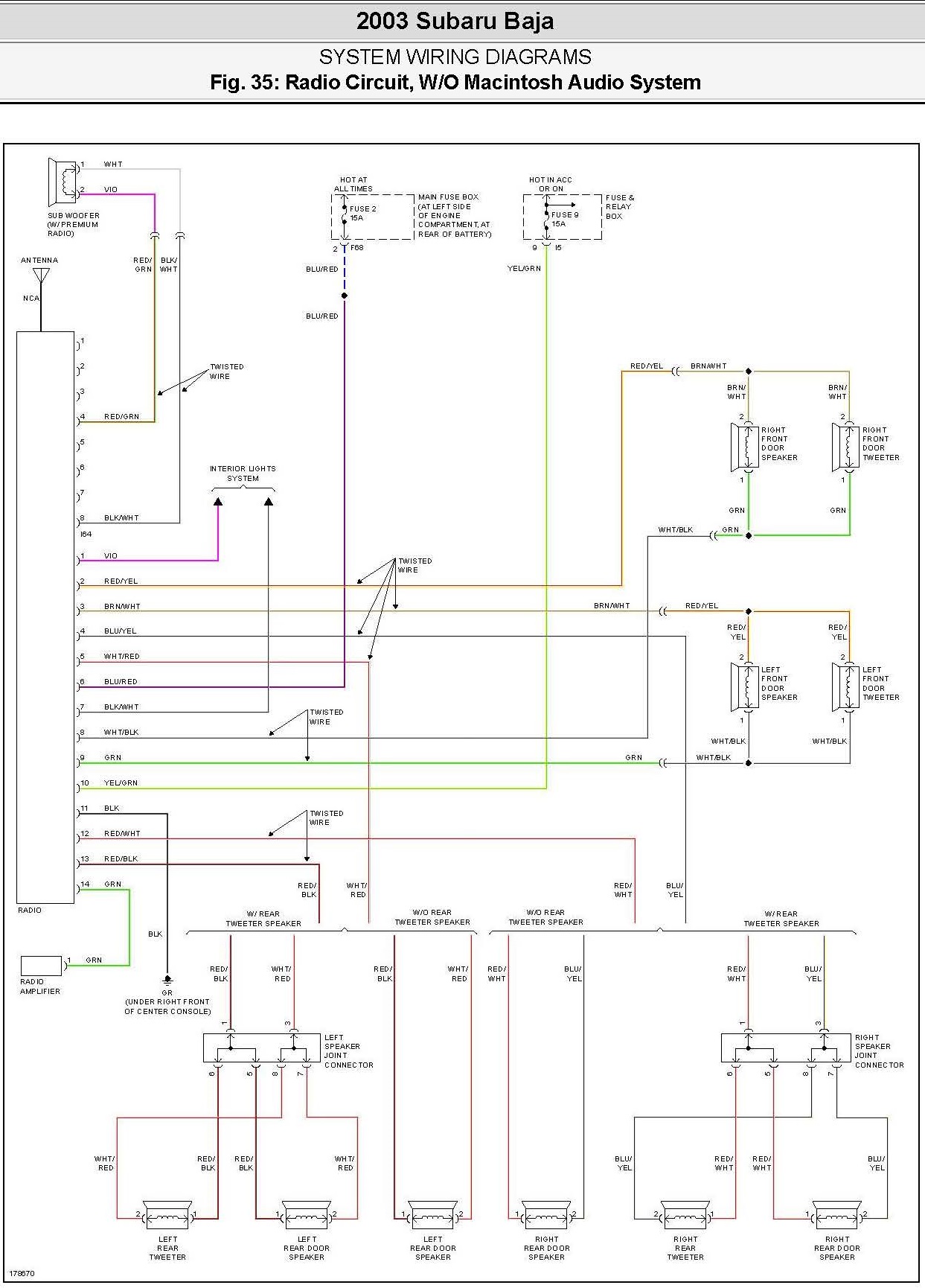

I just checked the wiring diagrams, and they appear compatible. I say 99% sure it should work. I'll post the wiring diagrams shortly.

Re: Forester Head Unit with built in 6-Disc Changer in Baja?
Some of the wire colours are different, but the pin numbers are the same for each function. If the connector fits, you should be good.
- Forester Radio Wiring.jpg (296.78 KiB) Viewed 138134 times
- Baja Radio Wiring.jpg (350.53 KiB) Viewed 138134 times

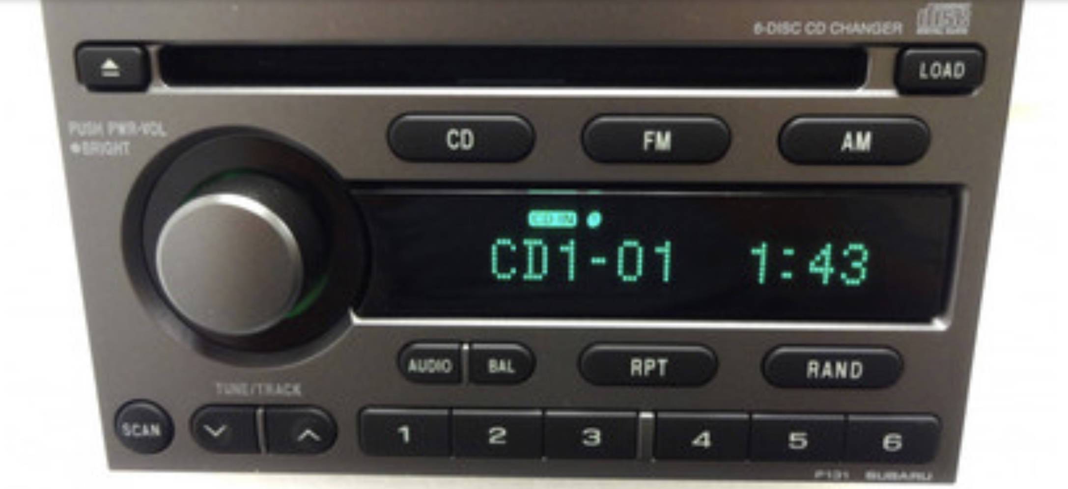

Is your photo the Outback unit?
Here’s the Forester one.
Either way, I appreciate the response. I haven’t studied the unit much yet so unless I get a firm answer between now and when I get time, I’m going to give it a try. From there I will report back.
My earlier photo was one I found online for the part number you posted.
The 2002 Outback one looks like this: https://www.ebay.ca/itm/253882952130
I just mentioned it because I saw that the one in that photo, which I hope is the same Forester one as yours, has similar design features to the Outback one that I have and know fits.

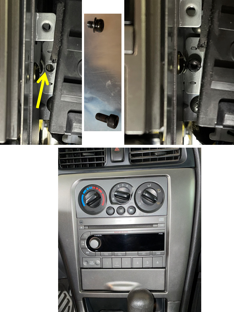

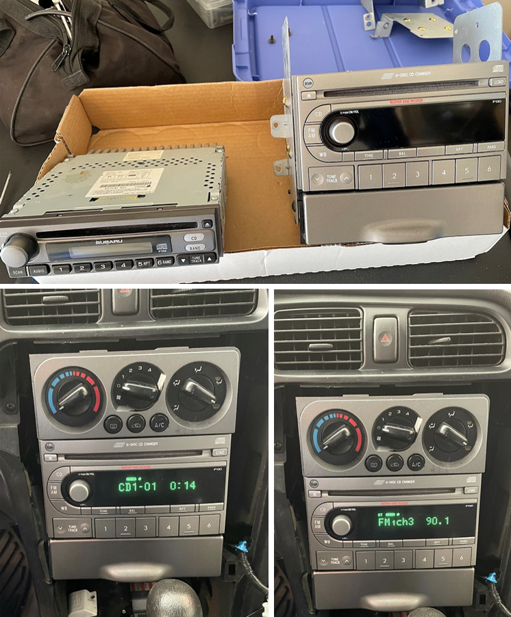

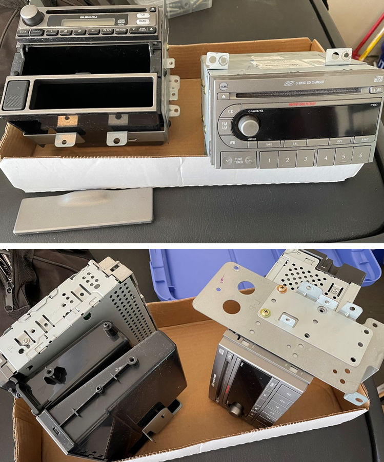

Chiming back in to update that this worked out. I was initially pretty concerned with the Forester unit's mounting brackets and whether they would be compatible with the Baja's HVAC controls. Once I actually looked at it, the Forester unit's mounting brackets, like the Baja's (and like any other radio that ever existed out there, apparently), are removable.
The Baja's brackets are conveniently "universal" and aligned perfectly to the Forester unit. First picture shows the Baja's stack compared to the Forester unit with its mounting brackets. The second picture is one side of the Baja bracket mounted to the Forester unit.
Due to the Forester unit being approximately twice as thick as the Baja unit, I was going to lose one of the storage cubbies. I opted to keep the lidded cubby for a more "finished" look. With both mounting brackets and the lidded cubby in place, I hooked the unit back up to the car and reconnected the battery to give it a try -- all systems appear to be functional!
After that test, I unhooked the battery again and continued to button things up. It went nearly without a hitch. One issue I ran into, utilizing all of(4) screws to mount the Forester unit to the Baja's mounting brackets the lower, right rear bolt gets in the way of reusing the original screw (top) that mounts the Impact Sensor Unit. Specifically, the washer interferes with the lower right rear screw and prevents this mounting screw from being used. I went to my handy-dandy screw collection and pulled out a M5 x 0.8 socket head cap screw (bottom) that ended up working out. It rubs right up against the lower right rear screw but it does thread in. Final product is shown as well!
I appreciate the help on this and am glad to put it to bed!
