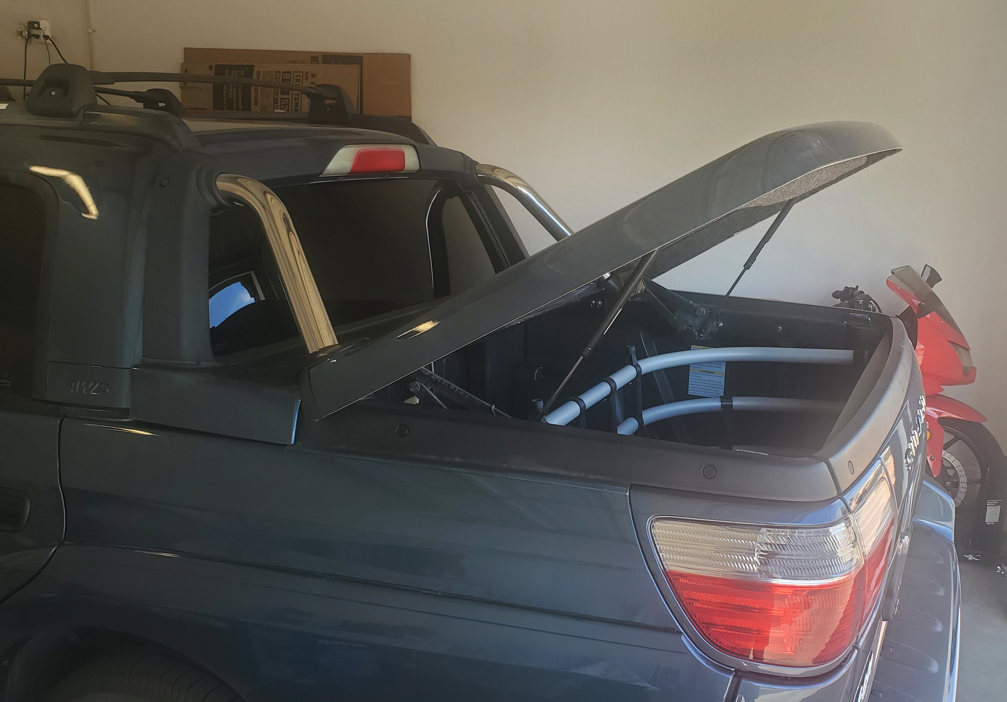

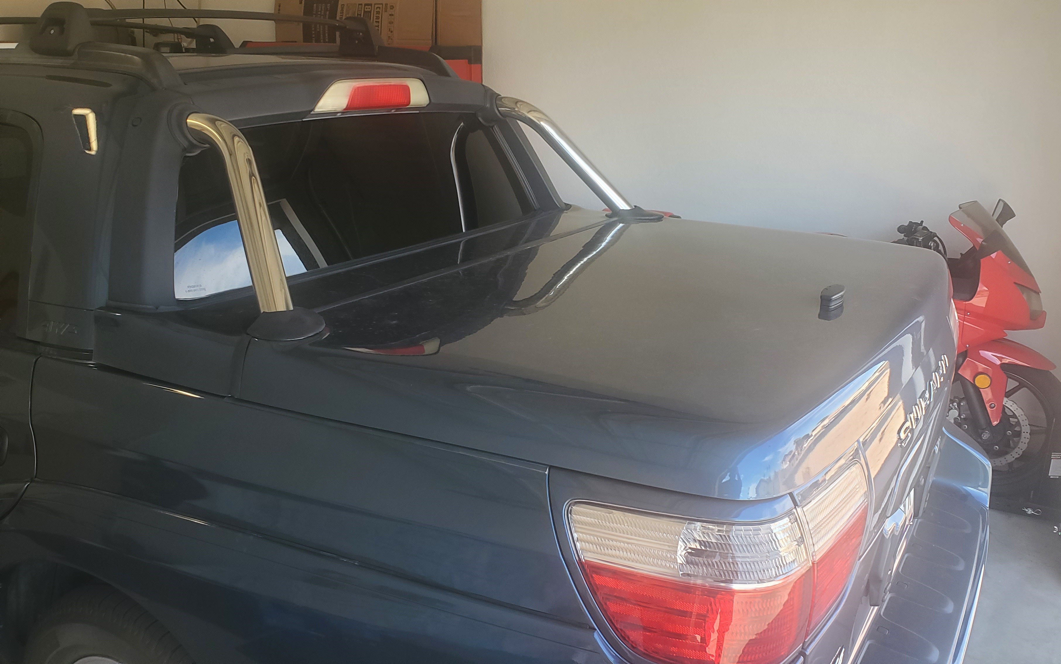

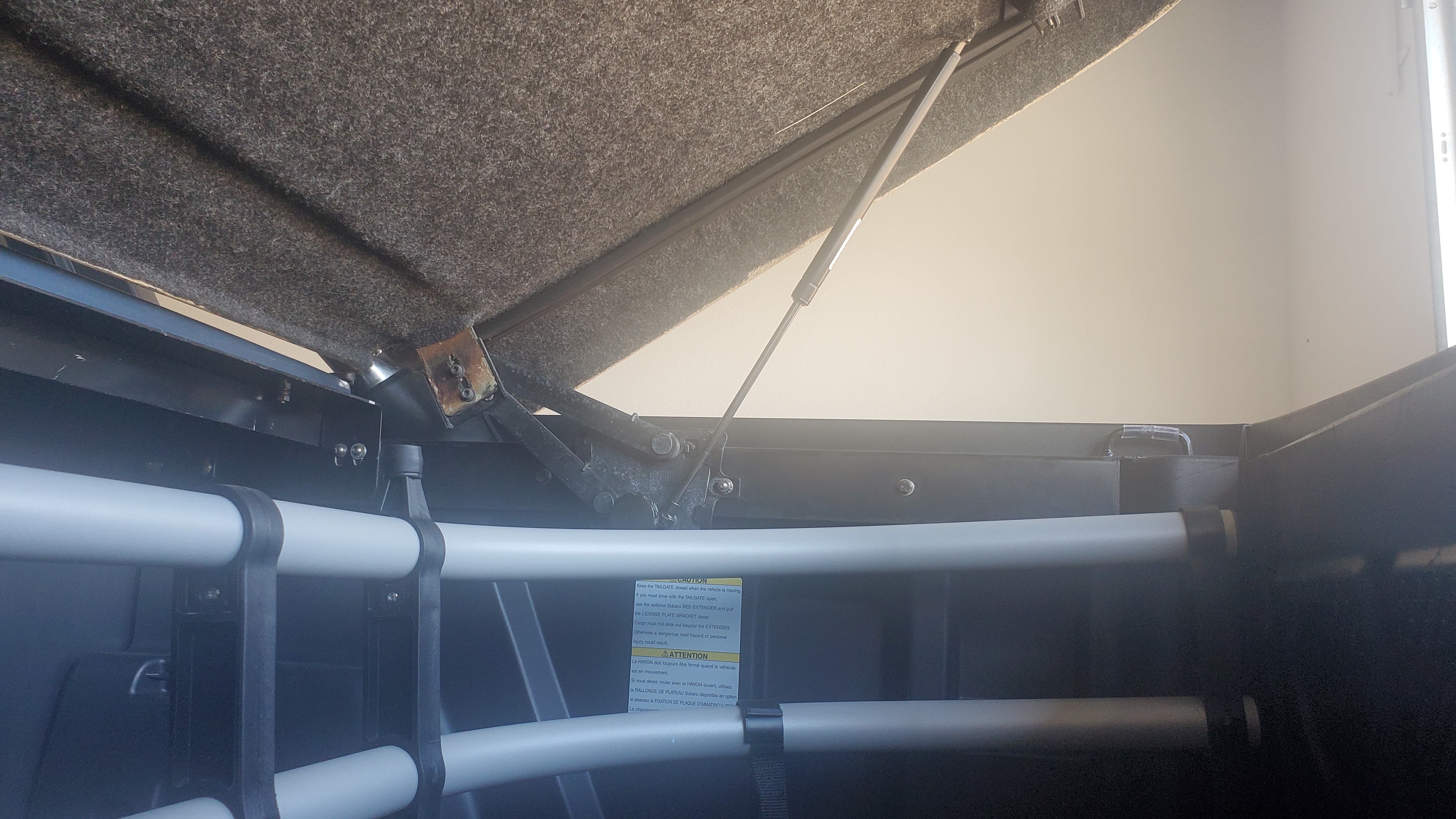

Here's my SnugTop. I upgrade the lock to their prolock and had a welder modify the mounting rails. When it was installed it would hit the sides of the car every time it shut. Otherwise, the side rails mount inside the bed by using 3 bolts that it replaces so there's no drilling involved. I had to buy spacers to properly fit the rails because they only used these rubber pads and the side panels were caving in from the bolt clamp.

So, this is the extent of it?
