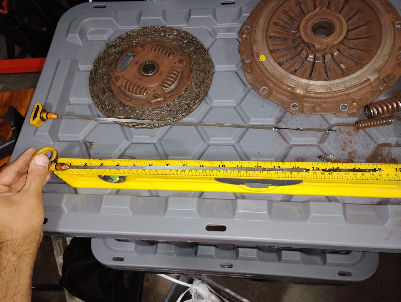

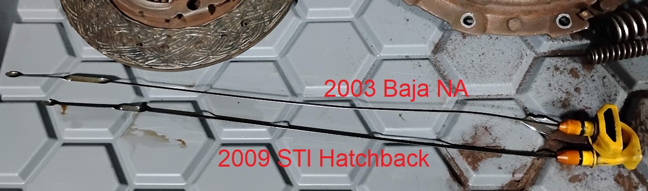

Well, I can't really comment about the Killer B oil pan, but I can give the lengths (depths?) of the 2009 STI dipstick marks. Is the new oil pickup shallower (further away from the ground) than the original? If so, to me it sounds like you'd need a shorter dipstick, and the STI one is shorter. My understanding is, you want the oil level to be high enough to not starve the pickup, but low enough to stay below the spinning crankshaft. The new oil pan and pickup would change the overall depth and pickup height, but won't have an effect on the relative position of the crankshaft from the base of the dipstick (unless the dipstick tube itself was replaced also).

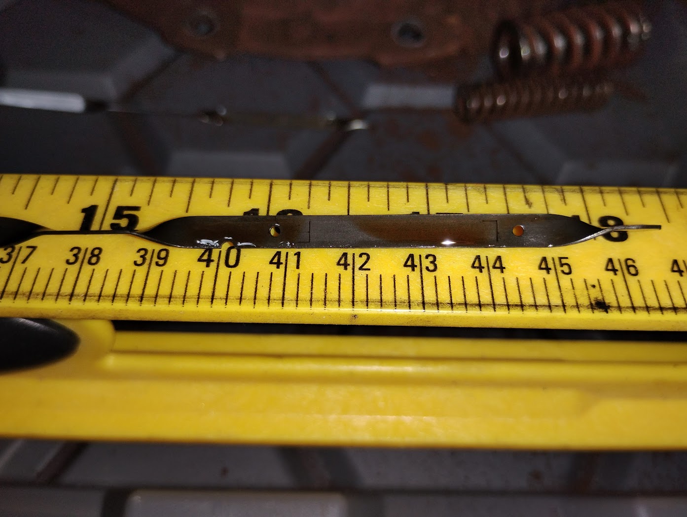

A 2009 STI hatchback has a dipstick with the F mark 40.8cm and L mark 44.5cm from the base of the handle.

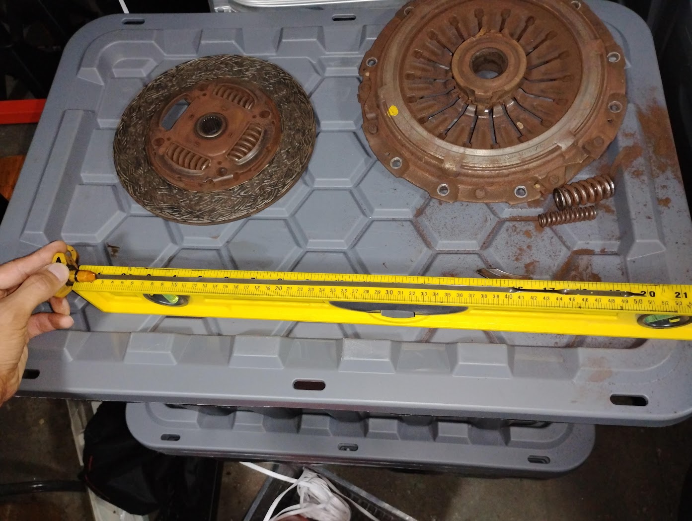

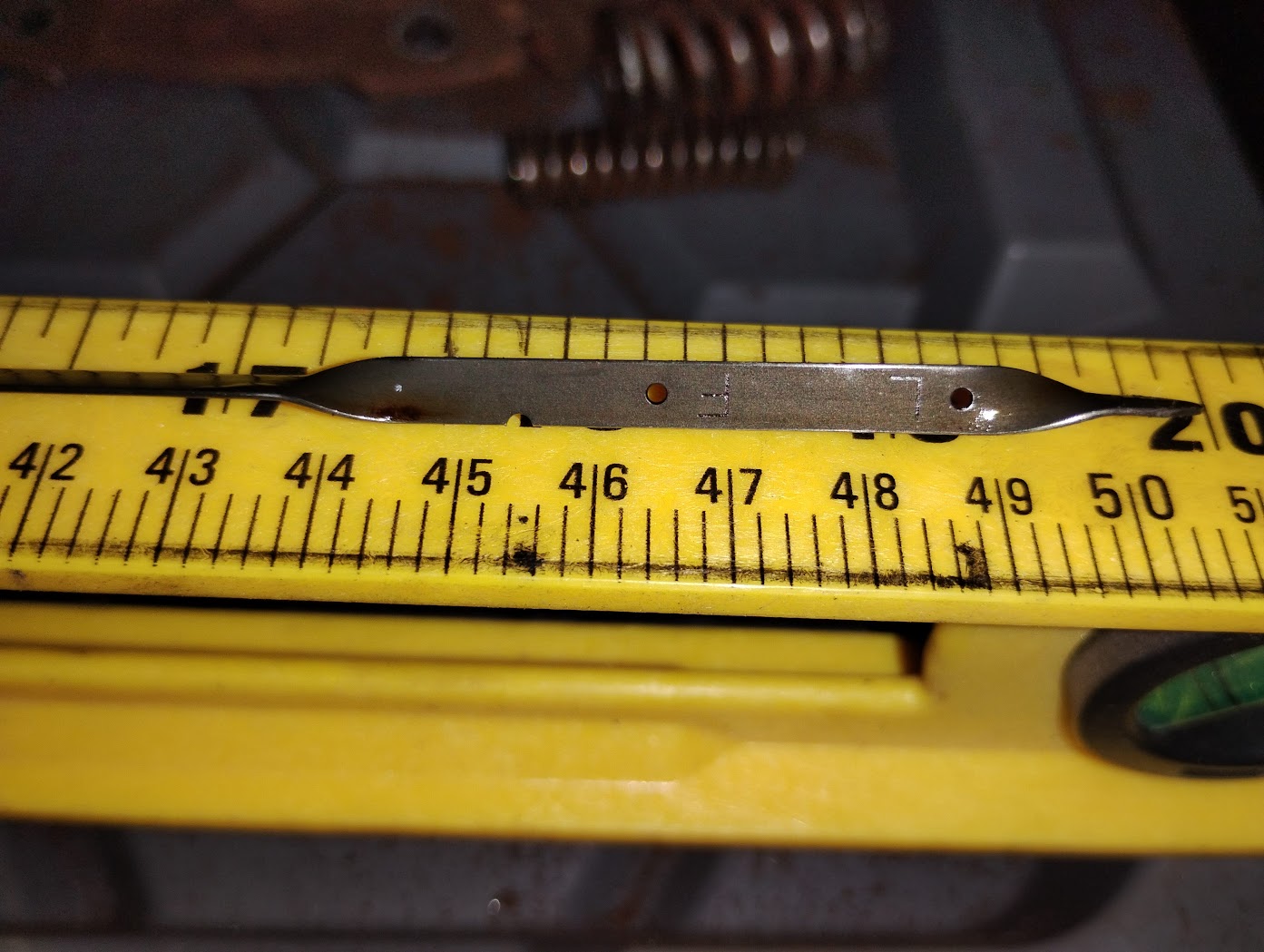

Re: Killer B Oil Pan & Pickup = New Dipstick?
A 2003 Baja NA has the F mark 46.5cm and the L mark 48.8cm from the base of the handle.

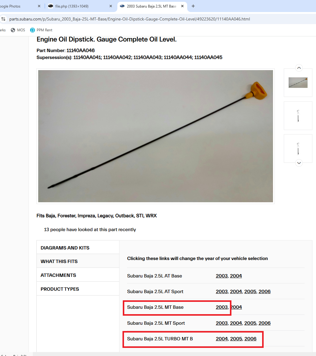

The turbo Bajas should have the same dipstick as the NAs, according to parts.subaru.com.
